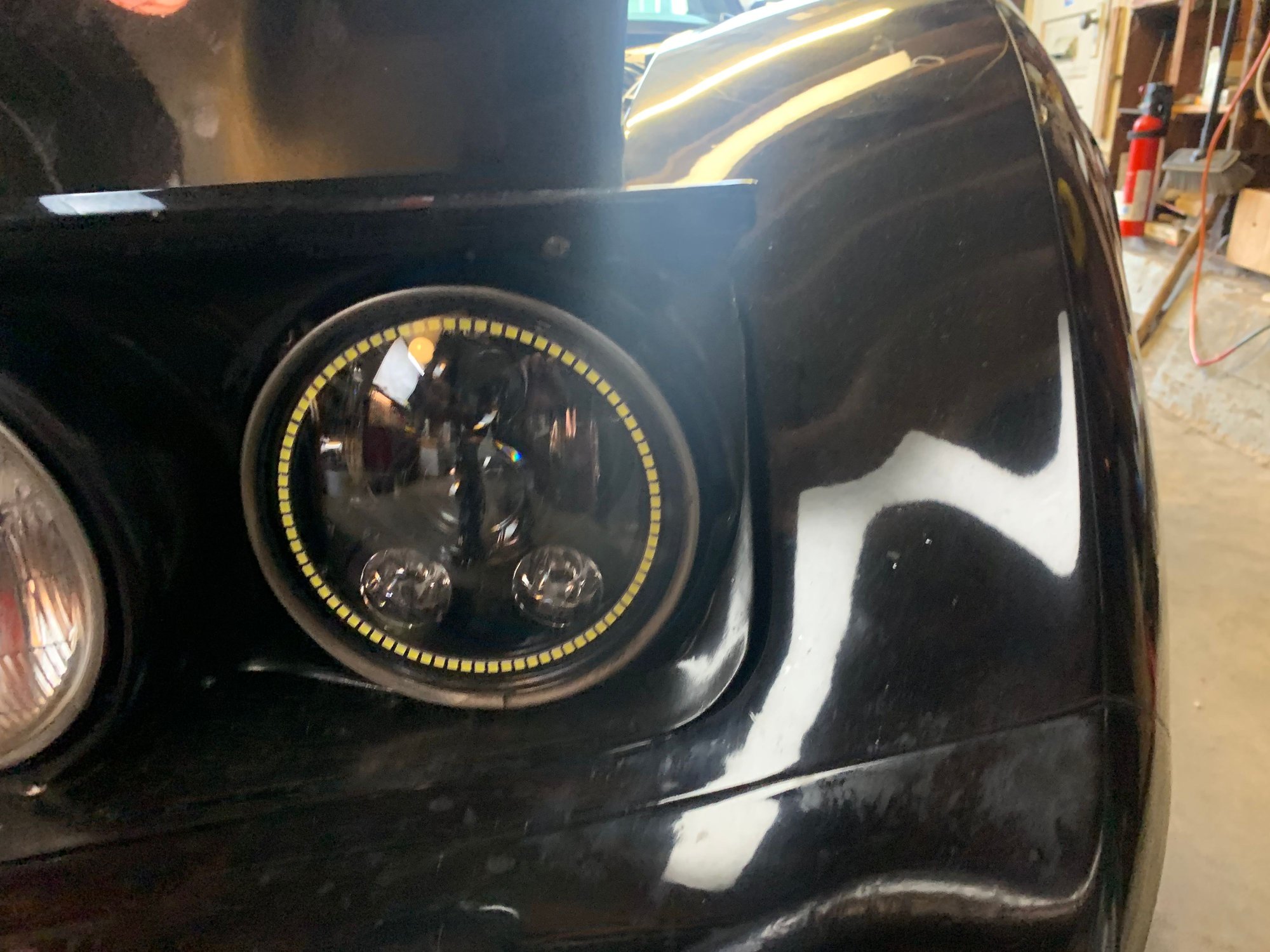

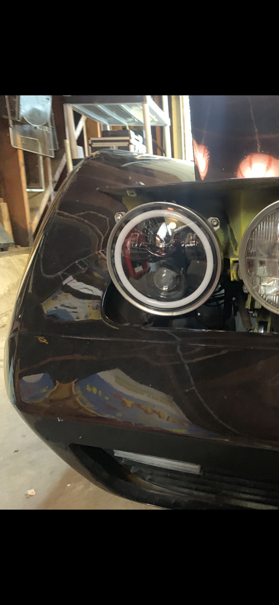

Bought one of each of the best rated Led headlights from Amazon. I think the left (passenger side ) one looks better. Both seem to have good light output. Both bulb products were about fifty bucks.

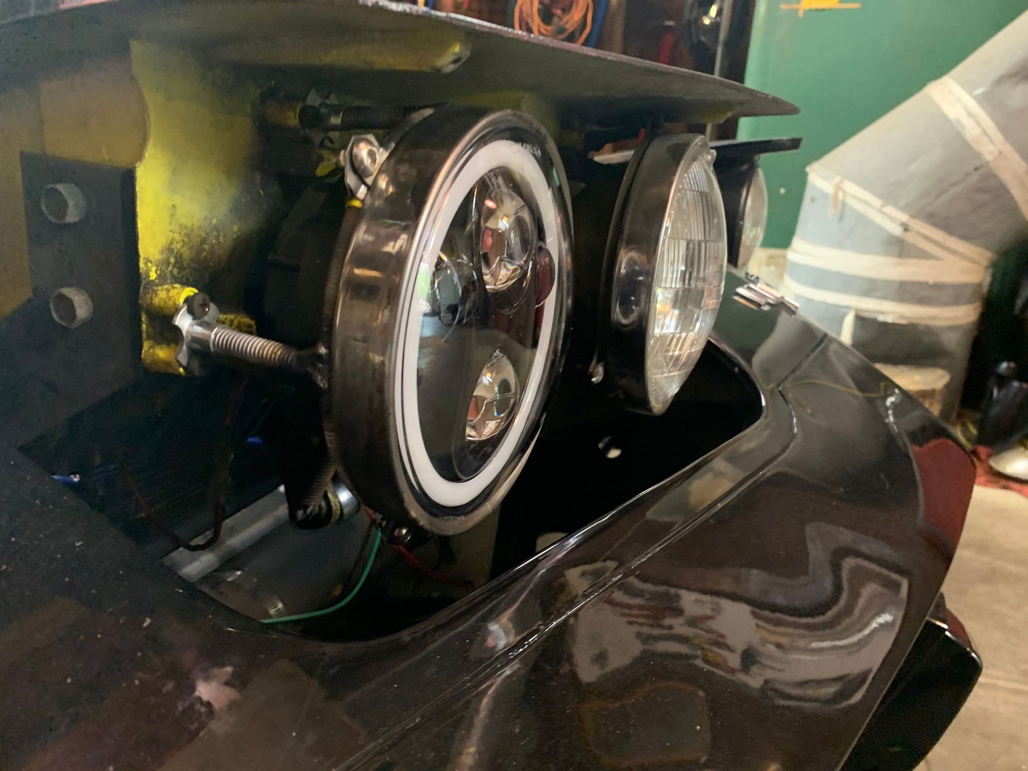

The stock headlight mounts were not compatible. I set aside the stock hardware and fabricated a bracket to hold the big square backed leds. The main market for 5-3/4” leds is for motorcycles. Led bulbs that fit the dished mounting surface of c3 corvette seem too expensive. Ill drive around for a week or so then order 3 more of the bulb that seems better.
making the brakets was more fun than expected. I enjoyed fabricating the small steel parts. The final product is nothing pretty but it does the job of holding the new lights and is not visible once the headlight covers go on.

Nice job working around the stock buckets.
I have a BMW headlight 'ring' that I'll cut up and do something similar.
Creative with the threaded rod!!

yes I agree they need a bit of aiming. The little pads on the end of the threaded legs can screw up and down the threaded legs (after mounting screws are removed ) to allow adjustment. The threaded legs can extend into the gap between the orginal cast aluminum mounting bosses allowing lots of adjustability in or out. The brackets would be much better if you could adjust from the front by simply turning screws. The original bucket adjusters snapped on me when I first tried to adjust without dissassembly so the stock setup also seemd to lack easy adjust feature. I also found that the headlight mechanism
was adjusted to raise most of the way then stop making it impossible to remove the painted headlight surround trim piece. I fixed the raise lower travel
issue with the miata motor install. So before the rebuild I had both lights mostly but not all the way open and one broken adjuster making the drivers light point straight at the ground. Also dirty connectors made the lights extra yellow and dim.
