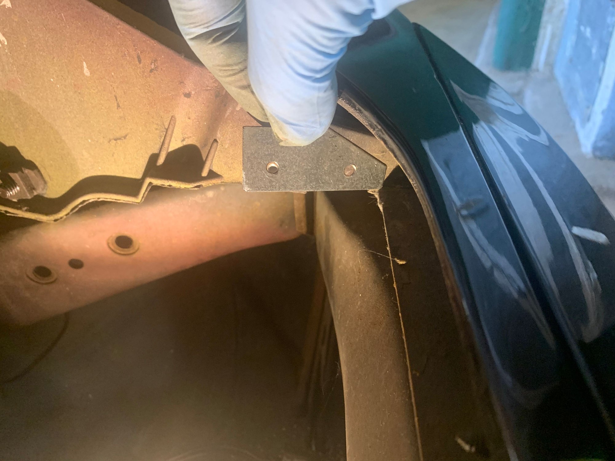

Last item to address was the crack in drivers side headlight frame. This crack made the drivers side light bounce up and down over bumps. I riveted and jb welded a little plate on there to hold the frame back together. Hope it holds long term ( or at least until someone backs into the front of my c3 with a truck)
