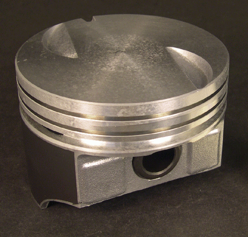

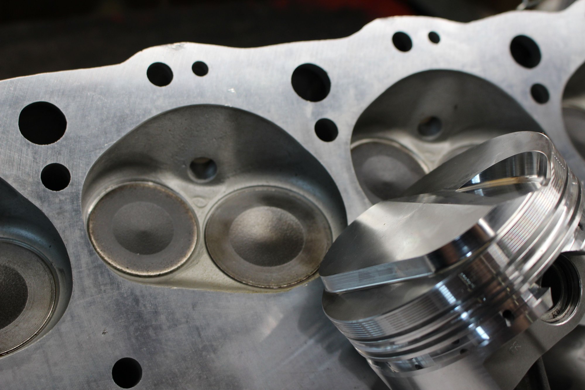

With a borescope the piston dome shape will tell you a lot. 1974 Vettes ran open chamber heads with about 118 cc chambers. Check casting numbers under the valve cover to be sure.
10.4 C.R. Icon #IC 783 454 forged pistons with 27 cc dome for 118 cc open chamber heads, dome 0.290" high My pistons & heads.
GM 3999295 1971 9.0 CR LS6 forged pistons for open chamber heads about a 12cc dome. My builders short block.
Icon cast flat-tops # 1448HC 2 cc valve reliefs no dome about 8.0:1 with open chamber heads. Catalog picture.
