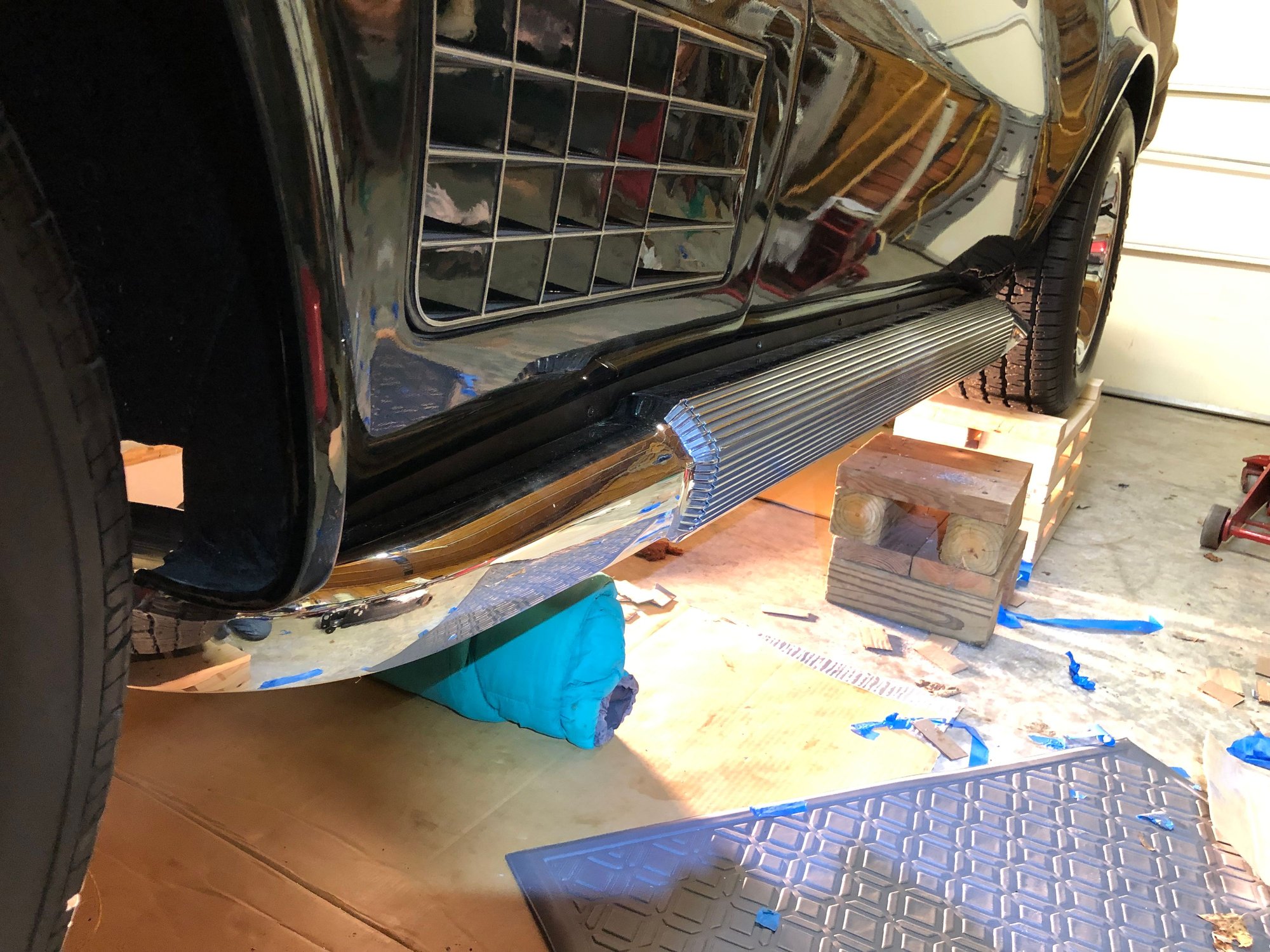

I was in the same boat that you are in, trying to decide which side pipes install on my '72 convertible. At the end of the day I decided I wanted the '69 style side pipes and I did not want leg burners. I went with pipes from Allen's Stainless. The exhaust covers are Paragon, even though I ordered these through Allens as well.
These exhaust covers are not simply take out of the box and bolt on. Both the side pipe covers and the exhaust pipes require some trimming on the front fenders. Since my car is a '72 I had to drill new holes in the rocker panels for the exhaust covers to bolt to. Long story short, if a person takes their time and test fits everything before cutting/drilling the end product turns out pretty good.
I cannot tell you how they sound because the interior column and steering column is out of my car right now. Probably a month away from being able to fire it up.
Below are a few pics. Good luck with your decision!

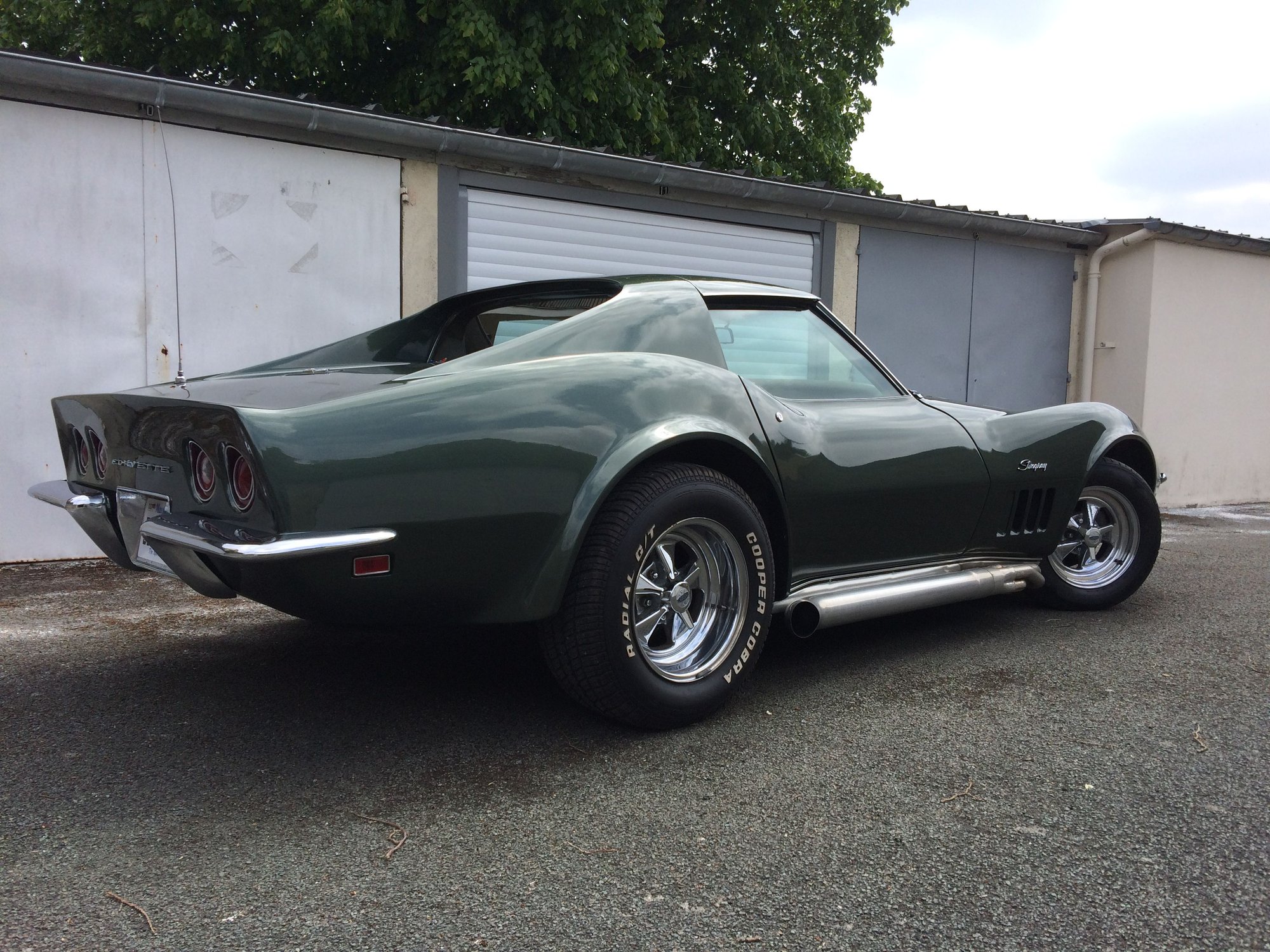

I have Stahl side pipes on my 69 convertible. the fit is great, here are a few pictures
