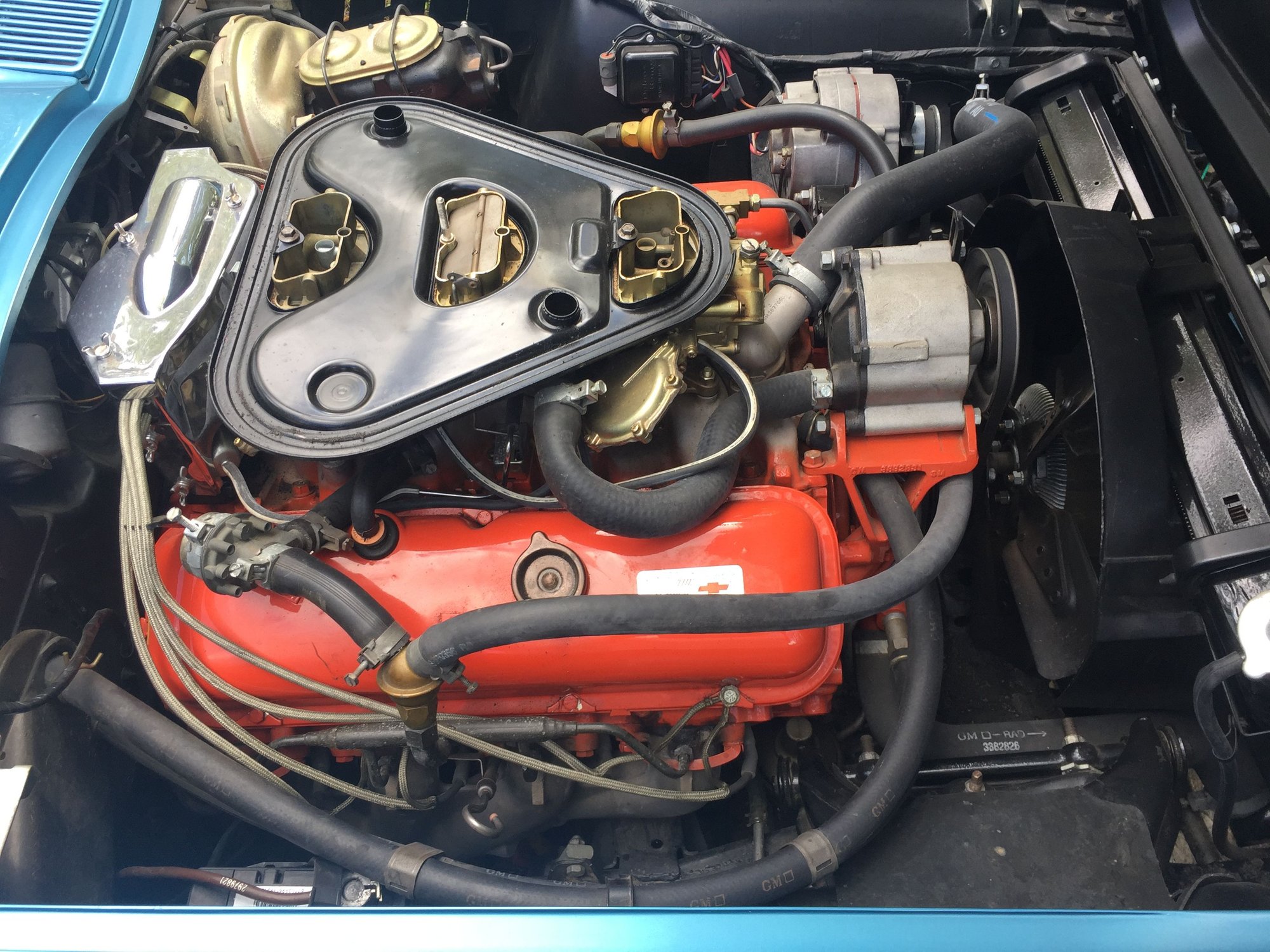

Well, for what it’s worth, my dad also has a bone stock, blueprinted stock 67’ 427/435 coupe, and it runs fine on 93 octane at 34* total timing. Although we haven’t driven it in Summer heat yet, Spring temps in the 80’s, it’s been fine, no pinging whatsoever. I would be willing to bet that the true compression ratio on these things is closer to 10.5.. which is definitely on the edge for pump gas with iron heads but...it’s doable with attention to the timing.

Yes, the engine was rebuilt to EXACTLY factory specs, even used an NOS cam. This is a Bloomington Gold 97 point car. There are tons of L71 cars running around with stock engines on 93 octane. You may just need to dial the timing back a hair and limit the vacuum advance travel some.
