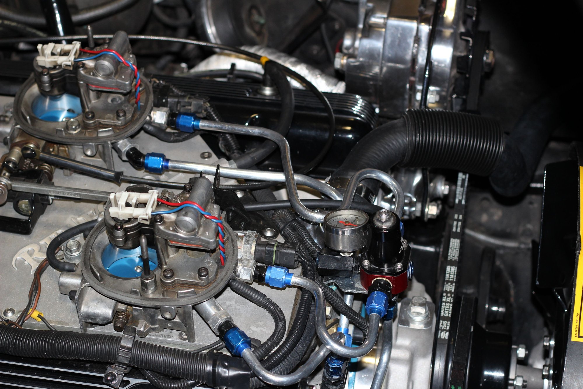

Curious as to what fuel pump you are using to get 20-22 psi. I have done the parallel plumbing, 90lb injectors blocked off old fpr and compensator, aeromotive adj fpr and 85 tpi fuel pump. can only manage 17.5 psi or so with the fpr cranked up.

I use this one, direct fit and running 24psi right now. QUIET as hell and will flow more than enough for your needs. Enjoy! 255LPH pump
You will have to install the stiffer spring that came with the Aeromotive FPR to achieve the higher pressure though.

This is the FPR I use it is similar to the Aeromotive FPR that Buccaneer uses. You have to change out the spring to the High Pressure spring to get 16 to 65 from the system. https://www.jegs.com/i/Holley/510/12-880/10002/-1 I have 90# injectors with parallel plumbed lines and block off plates. Edit: Wrong link to pump I used: I used this pump https://www.summitracing.com/parts/d...1027/overview/ (Had to recheck build book.)
I am running 24psi.
Sweet thanks, just ordered one!
Just put in 90lb injectors and pretty much copied your setup for fuel plumbing, heads and of course the renegade, wow this thing scoots now!
Thanks for sharing your cross-fire knowledge through the years, very much appreciated!

This is the FPR I use it is similar to the Aeromotive FPR that Buccaneer uses. You have to change out the spring to the High Pressure spring to get 16 to 65 from the system. https://www.jegs.com/i/Holley/510/12-880/10002/-1 I have 90# injectors with parallel plumbed lines and block off plates. I use this pump https://www.rockauto.com/en/moreinfo...041219&jsn=645
I am running 24psi.
Thanks for the info!
Forgot to mention that I had switched to the stiffer spring, I guess the 85 tpi pump pump just couldn't put out any more, won't be a problem much longer!
I think mine is marginal (165lph I used this pump https://www.summitracing.com/parts/d...1027/overview/) for the build I have, you need at least 255lph, Going to a 340lph for the 427SB I am going to replace the 355SB with. https://treperformance.com/i-1285334...1985-2004.html or https://www.jegs.com/i/JEGS/555/159030/10002/-1
Going to a Offenhauser 360 cross ram intake with adapter plates for the tbi.

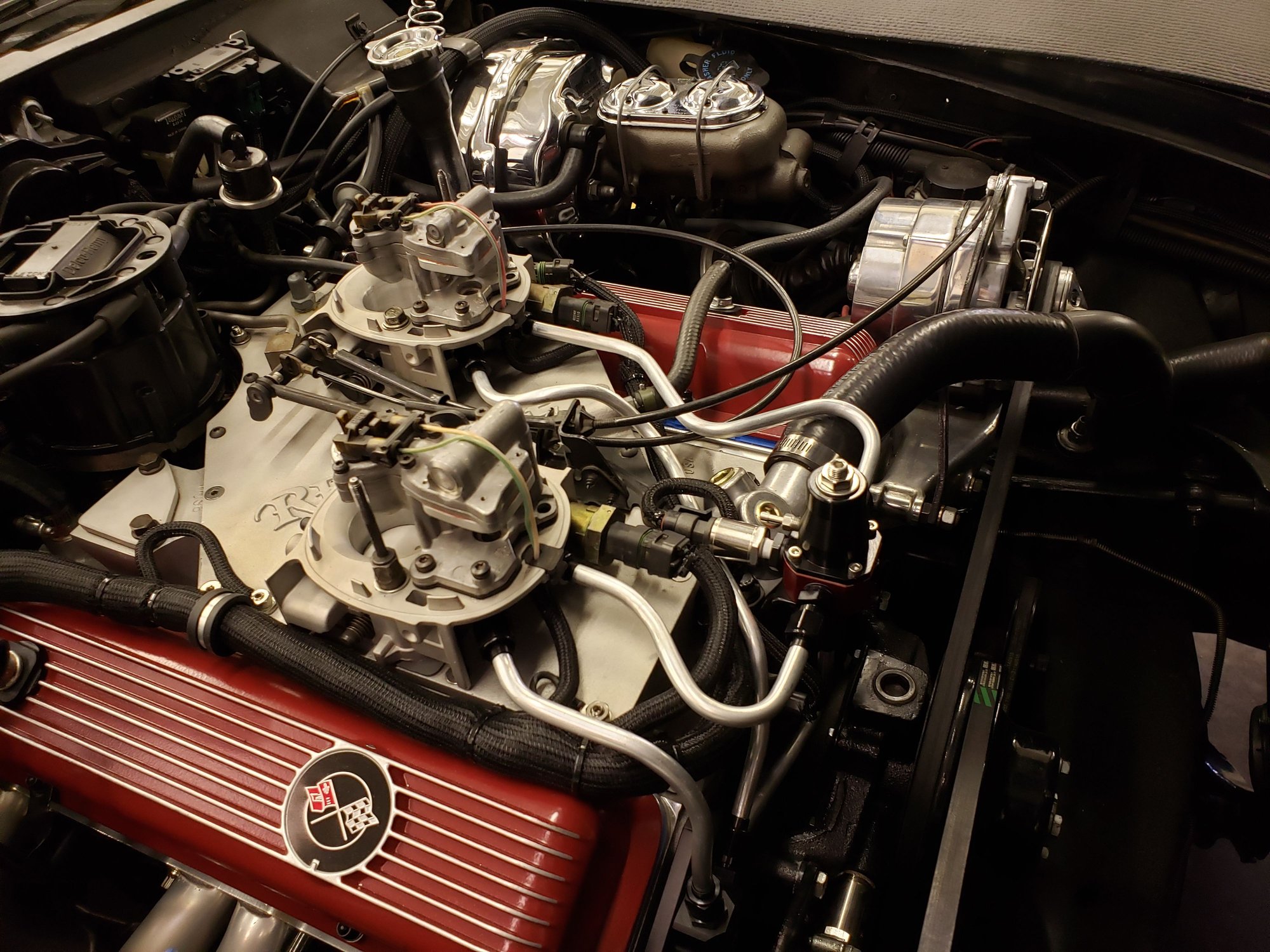

Nice and thank you. looks very similar to mine. What cam did you go with? If it's like my current one and your tune is right on, you have a mid 12 sec CF. Gear and stall?

Nice job Buccaneer, the CF is just too cool lookswise. The fact you got it running 12s and looking pretty stock...awesome.
Some outside the box thinking can make anything run pretty good.
I have a crane 2030 that I put in many years ago. As far as stall and gear, I have no converter, running a T56 manual with 3.73 gears.
Definitely not a 12 sec car yet, bottom end is a 355 with that mild cam. Will eventually build a 383 or bigger with a more aggressive cam in the future. Not sure on HP where I am now, the top end is the same as yours, heads, rockers, injectors/tb's and using ebl flash, guessing maybe in the 325 to 350 range. Way better than stock for sure.
OK, thanks. I thought you had a 383, my mistake. How do you like the T56? So, when you do build one at some point, it will pick up about another 75-100hp at the motor and put you squarely into the mid 12s if that's what your looking for. I run a 9.5" Yank SS3200 stall, but going to a SS3600 when I pull the trans back out. That should help my 60ft a little more and drop my ET some more as well. I will be very happy at 12.40, but will still try for the 12.20s.Done right, a CF motor will haul *** on just two injectors. PM sent.
Love the T56, funnest project yet on the car. With the 3.73 gears it runs at the same rpm as the 700r4 on the highway and nice lower gear ratios. Used one from a Lt1
f body, tight fit but it works.
Sweet, 70-100 extra horses would be awesome! Hoping to be around 450 horses when all is said and done, that was a pipe dream many years ago when I bought my vette.
You are putting down some good times there, but that has some people scratching their heads when they find out a cross-fire is under the hood! Great job with your build, it is amazing what just two injectors can do!
