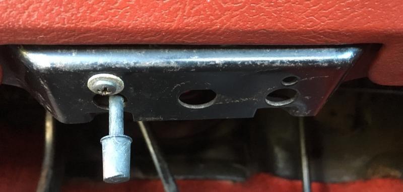

do you have pics? On my 68 theres a wiper motor over ride. Dont know if the 75s had them though. I also have the wiper door over ride but I believe you guys didnt have that

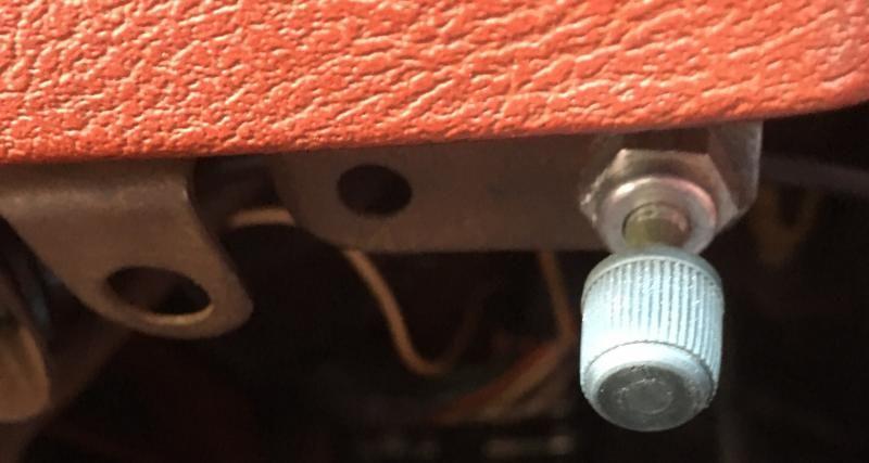

Here are photos from my 73. These would also be found on the 75. The Wiper **** and override pull stopped being used on the 73. 72 was the last year for Vacuum operated pop up Wiper door. The first photo shows the headlight override pull ****. The second shows the odometer reset ****. The reset is pretty tough to use, especially if it hasn't been used for a long time. I reset mine each year at the beginning of driving season. . You push it up and turn to reset the odometer numbers. I always need to pull mine back down a bit to disingage it. The rubber **** is usually missing or split because of the amount of pushing and pulling it takes over the years.
Hope this helps.
