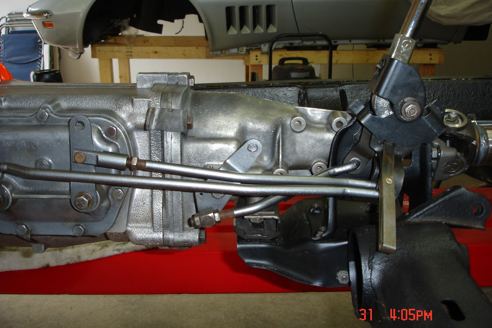

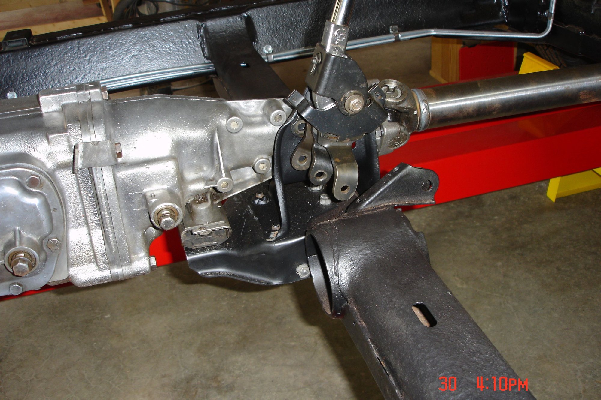

When the body came off I noticed that ALL of the attaching bolts were very loose. Shifter felt terrible, now I knew why...................................
