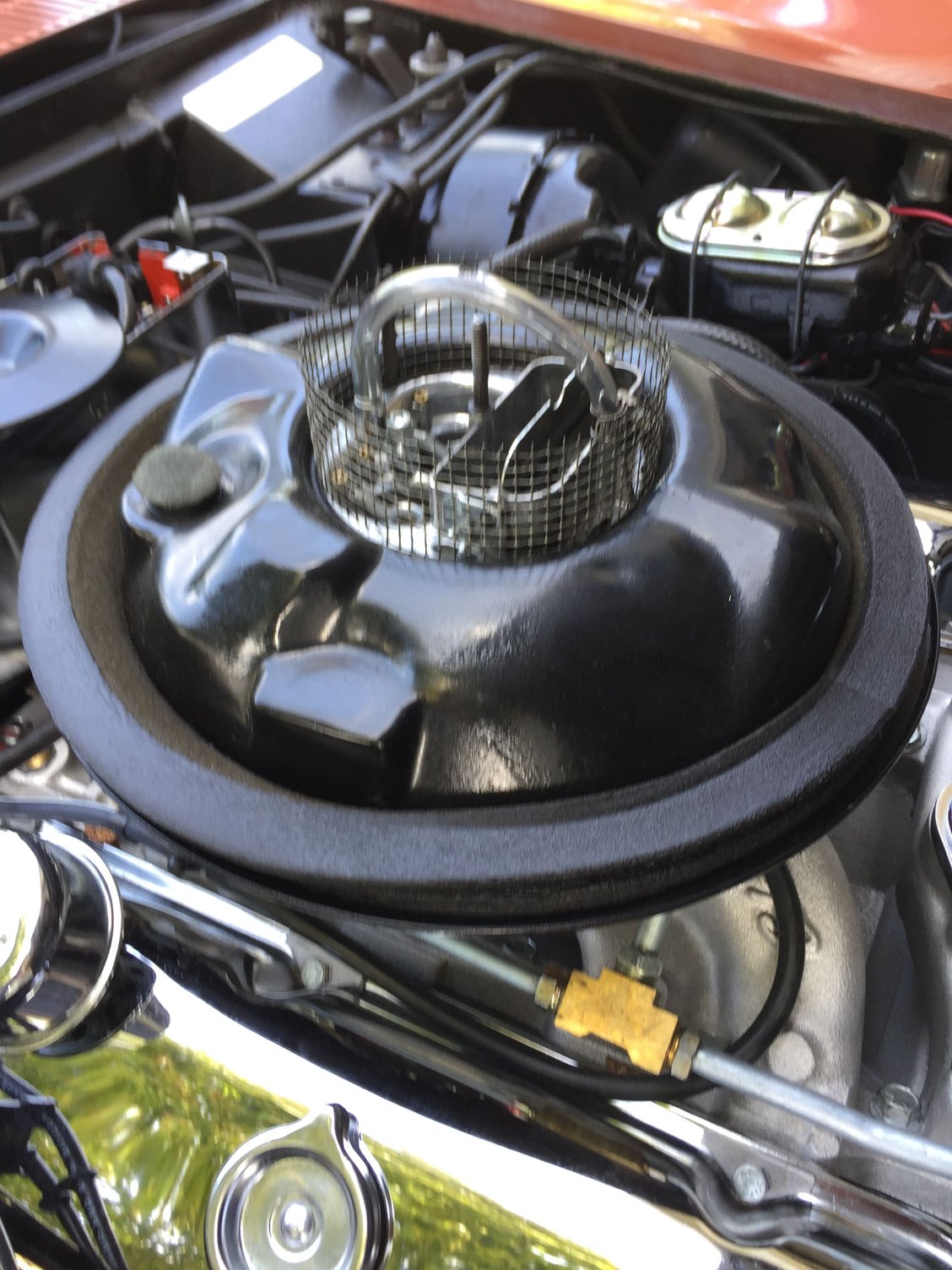

2. I installed a slosh tube between the vents and this did nothing. I removed the air cleaner element and could see though the L88 scoop there was no fuel coming out.

Temporary slosh tube

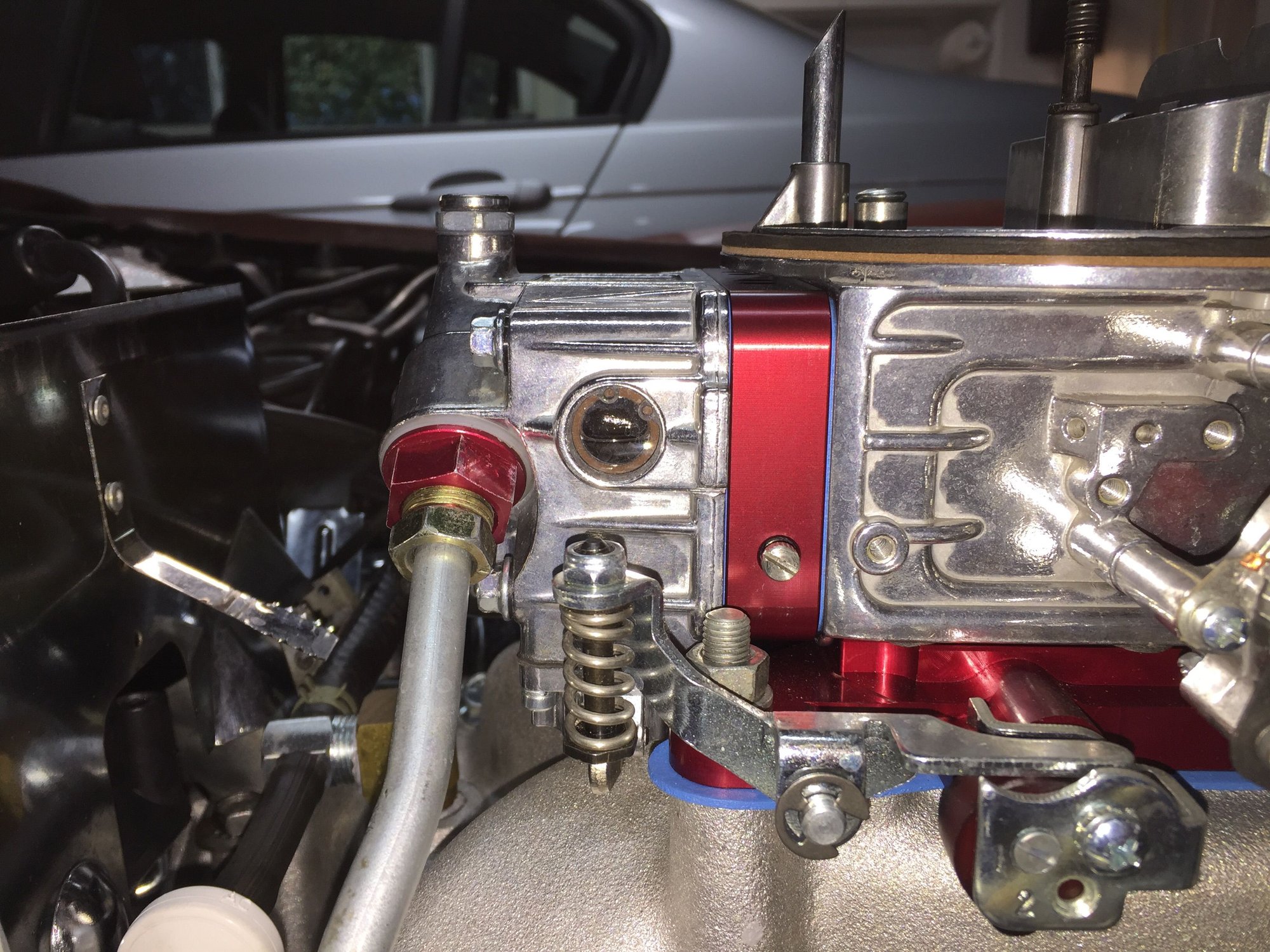

You say your floats are set perfectly on the sight glass centerline. That tells me your floats are set too high. They should be set so a little bit of fuel just dribbles out of the sight hole when the engine is idling and on level ground. Try turning the float level down to the bottom of the sight glass and see if that solves your problem. Good luck.

The Quick Fuel carbs have clear plastic sight windows that do not come out like a Holley and they
are marked for the correct level. But they are easy enough to adjust so I’ll give it a try.
