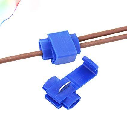

Also, depending on what is used to make the splice, it could simply be a poor connection. I have found that the quick splice connectors similar to this attached picture do not always make a good connection particularly with light gauge wire.
