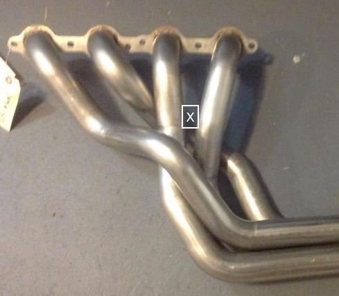

Good luck on that, I tried to get dimensional info or a photo from those guys, but they said unless they had a car with the body off they couldn't help. I think they took a car with a hydraulic throwout installed to create their original headers.

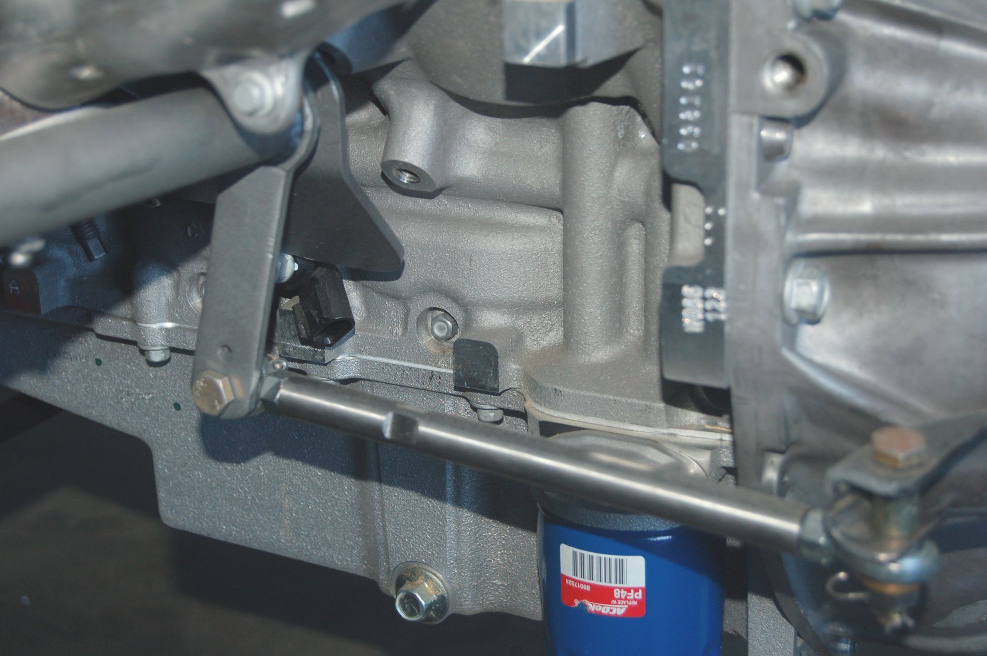

Kacy: I don't know what's available now but I bought an adapter that puts the z-bar in the stock place. I did have to break some welds and move the inner arm over to clear my exhaust.

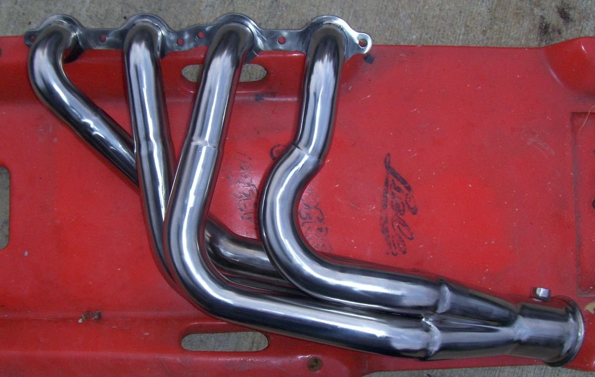

I couldn't find any either , so I built My own. Pain in the *** , and cost me a pile. But they fit perfect and are exactly what I wanted.
Got an install photo with the z-bar in place? I'd thought perhaps a strategic dimple in place might suffice and I think there are ARH photos that might approximately match yours for comparison purposes.

Sure do Ignatz .
Old Apr 17, 2019 | 03:35 PM
70LQ4's Avatar

So the z -bar goes in front of that dog leg on #7? I'll dig around for the ARH stuff when I get some time - thanks and nice fab work, not something I have the skill set for.
_________________
Found it, looks like you made lots of room where I'm guessing the-bar goes.

do you have a way to attach the zbar to the LS? It probably wont have the mounting like the sbc does from the factory.
I had reached out to Vette Aid and he gave me some ideas on the bracket he used to sell. So I will fabricate my own.

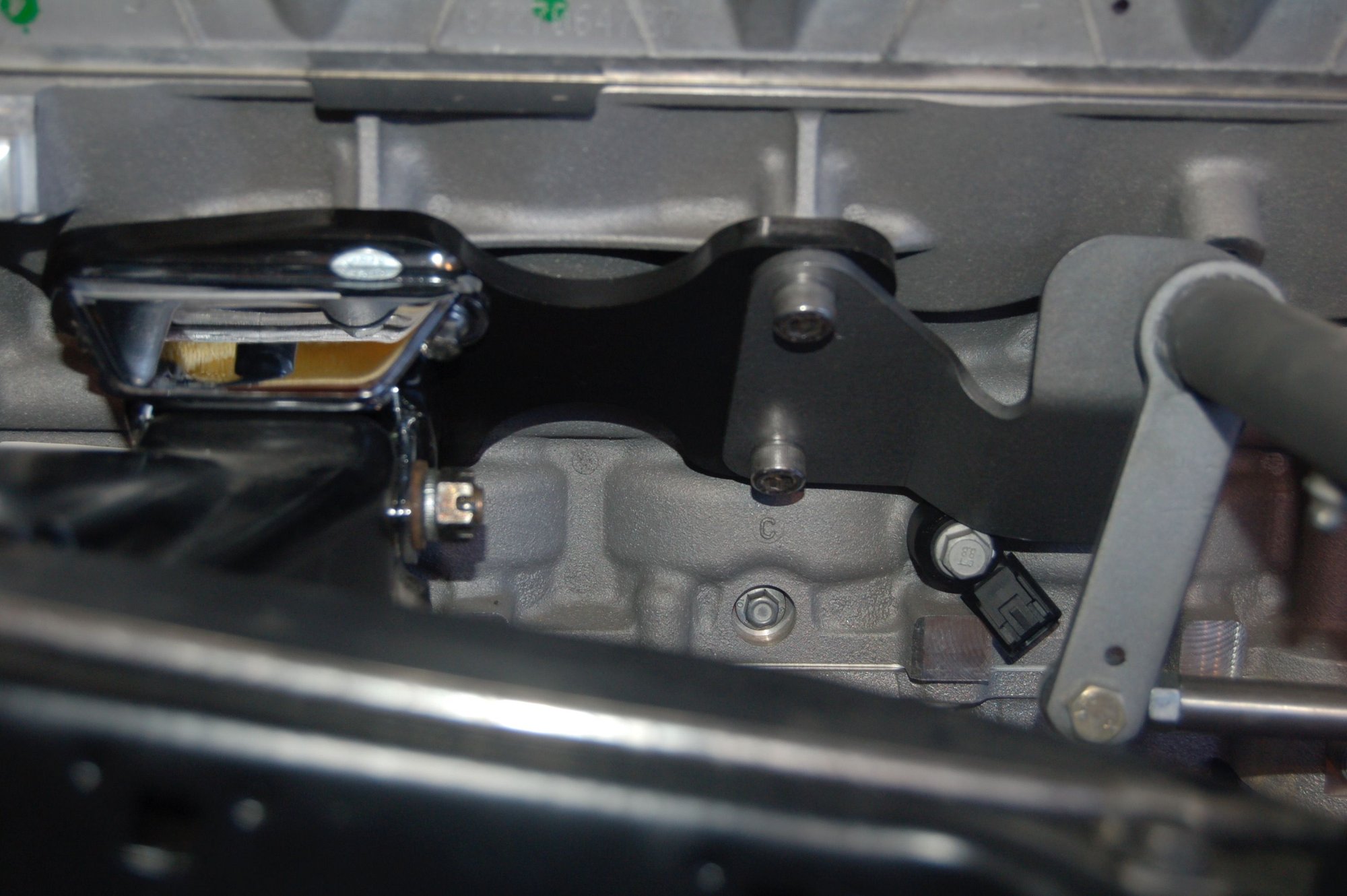

This may help

Originally Posted by ignatz
This may help
thank you that is exactly what he sent me. Would still like to find a header that would work.
