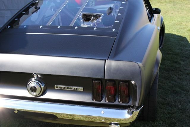

So, is more air the answer? You mention removing the entire rear window (a lot easier to do in a sugar-scoop C3). Perhaps replace the rear glass with lexan, and install some NACA ducts to let air exhaust from the cabin? I don't you'd want to mess with the fiberglass, especially with the fuel tank back there, but you could also consider venting out the rear of the cabin itself, not through the glass. The astro-ventilation cars did this.
Sorry for the Mustang photo.
