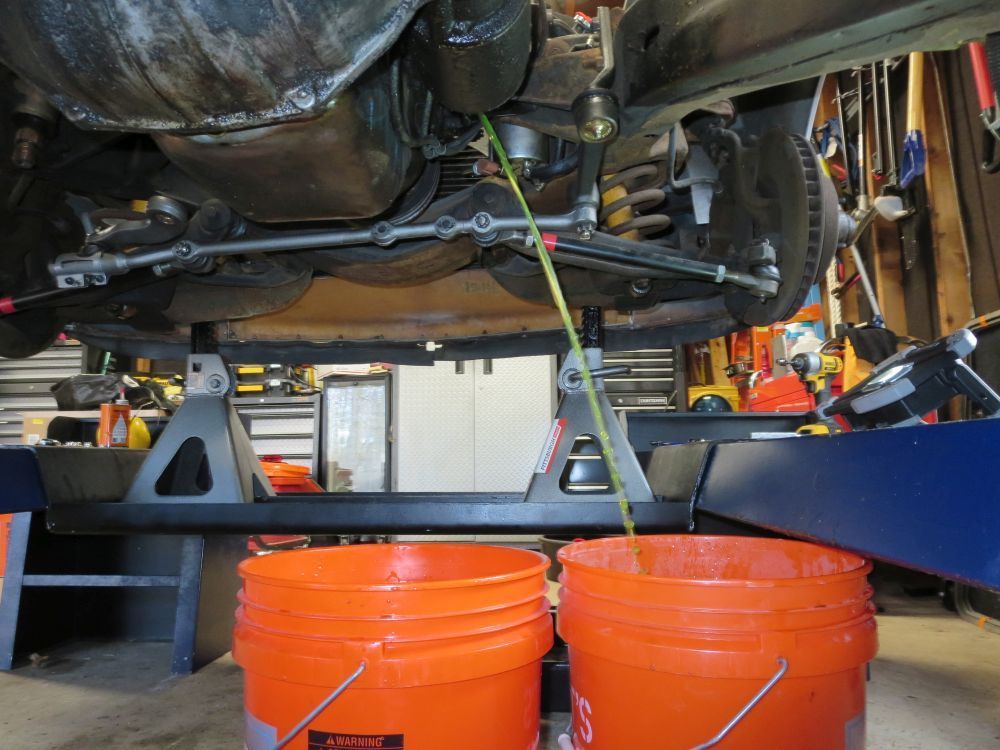

Probably not obvious is that there are two block plugs on the sides of the engine that can (should) be opened up as part of the flushing process, in addition to flushing the radiator. One is just ahead of the starter on the second image below. It helps that my exhaust manifolds were already off the car. I got mine out with a breaker bar, so I consider myself pretty lucky. If you can, do this outside on ramps, as it will make a mess. With the plugs out, you may need to stick a screwdriver in the hole to get it flowing.
You can then flush the block with fresh water through the thermostat housing, before moving on to jackson's cleaning process.
