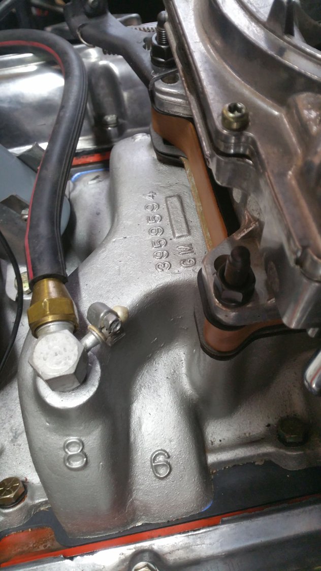

I had the same problem in my 68. I had an Edelbrock carb that was very susceptible to fuel boiling. I added a 1/2" phenolic spacer and that helped alot. I finally settled on a 1" spacer to make sure. I have an L88 hood so space wasnt an issue. You may need a drop base air cleaner if you have to add the wood spacer. I went back to a quadrajet and kept the spacers
If you have a quadrajet, GM produced a 1/4" gasket that was a heat shield of sorts to keep this from happening
Also make sure your fuel line isnt sitting on the engine at all, The heat will transfer to the fuel line. Thats more heat and problems
If you have a heat crossover in your manifold, next time its off the motor make sure you use a manifold gasket that blocks it off.
Make sure your timing is optimized for your setup. It should be around advanced 12 to 14 degrees at idle and 36 or so at 2500/3000 rpm. The motor will run better and a tiny bit cooler.
I also keep a can of starter fluid for really hot days. If I'm at a car show with the hood up and its in the direct sun, the fuel will boil off just because its ethanol
you can barley see the brown spacer in this pic. Its the only one I have of the spacer up close

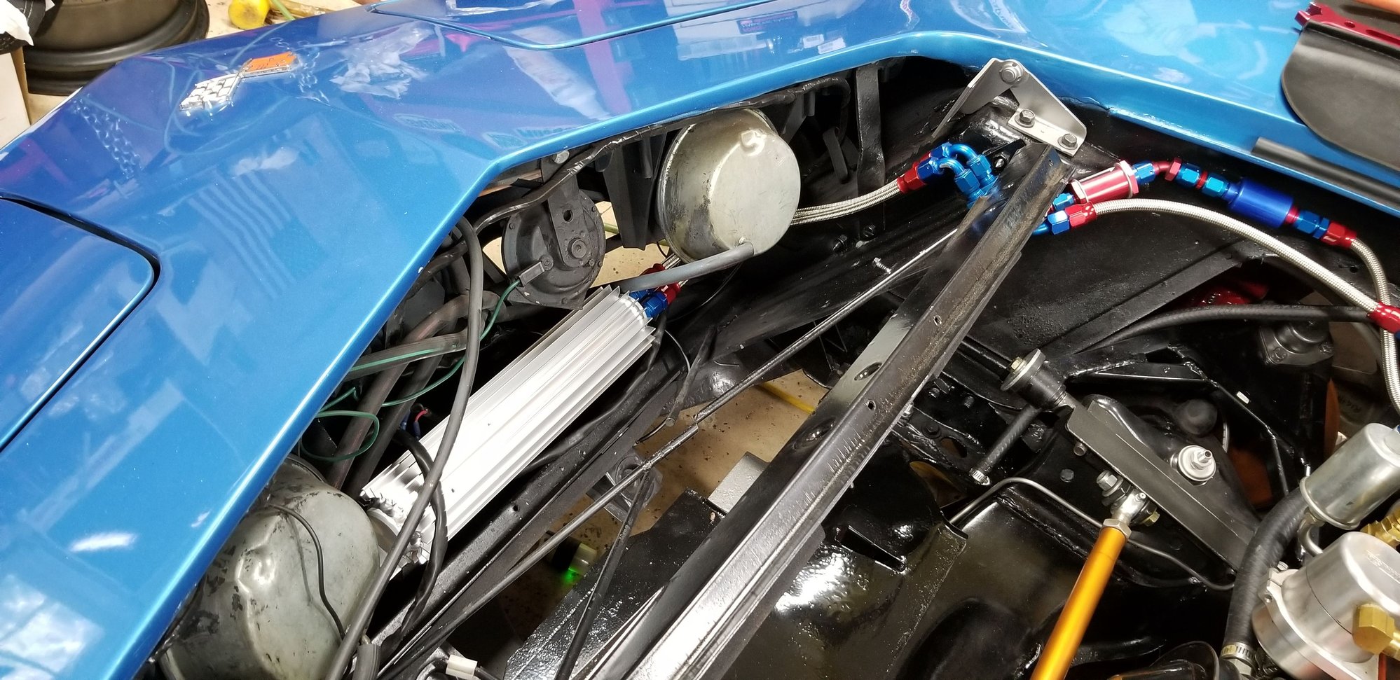

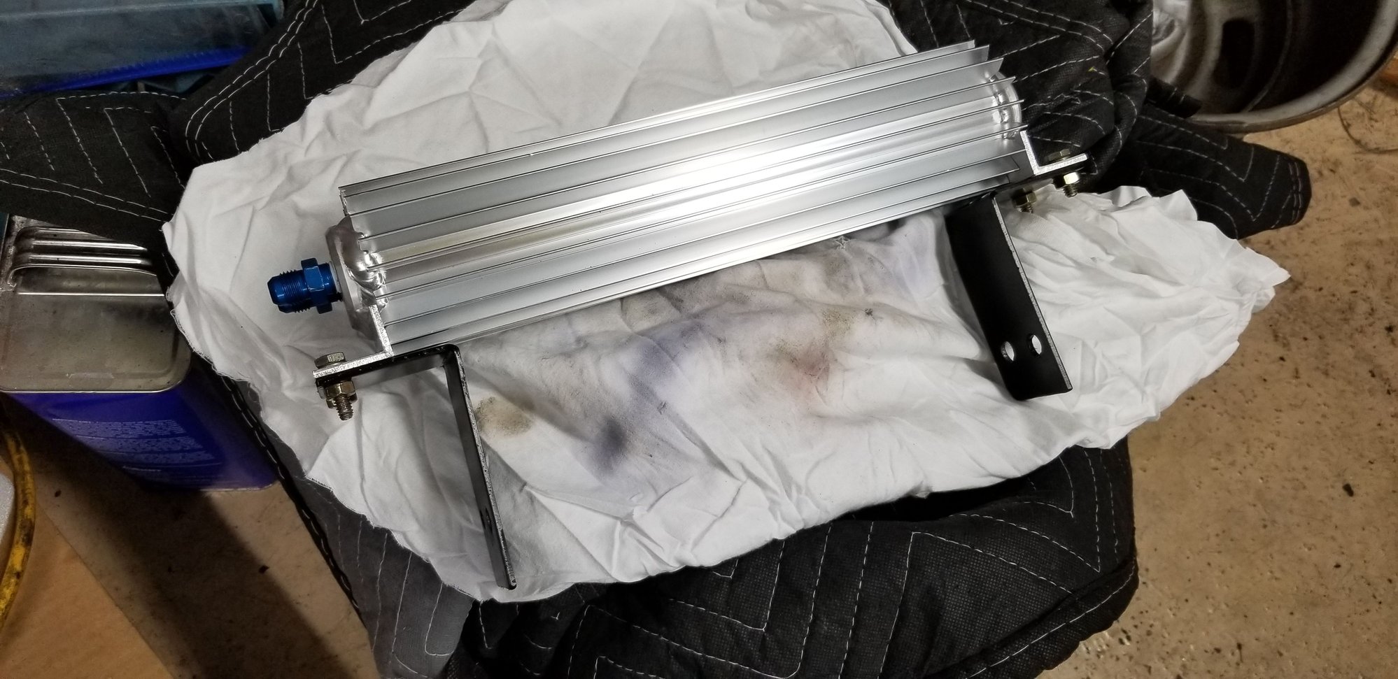

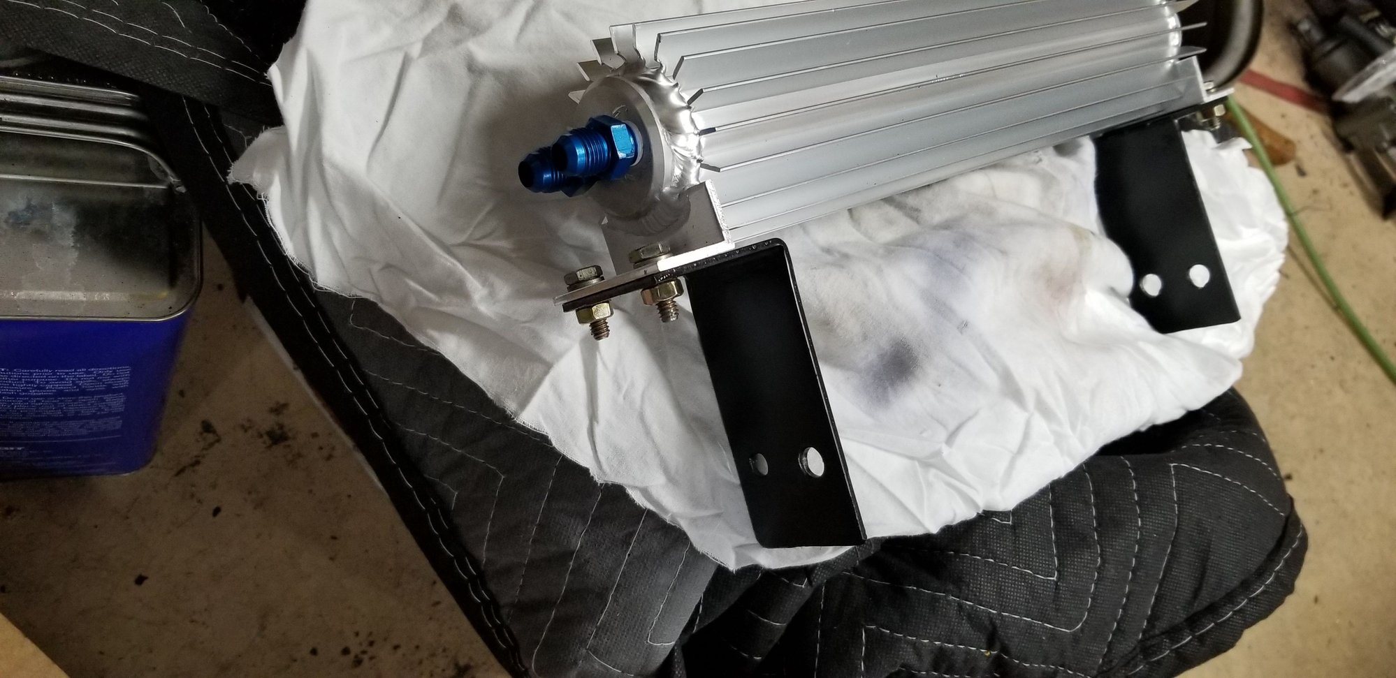

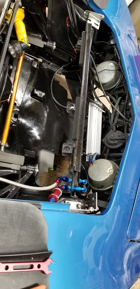

Speaking of cool cans I'm giving this a shot to see how it works. It should cool the incoming fuel charge since it runs next to the side pipe, and since it will be cooler I'm hoping it doesnt evaporate as quickly.
Summit Racing Heat sink fluid cooler. THey say it rated for transmission cooling and good for fuel
