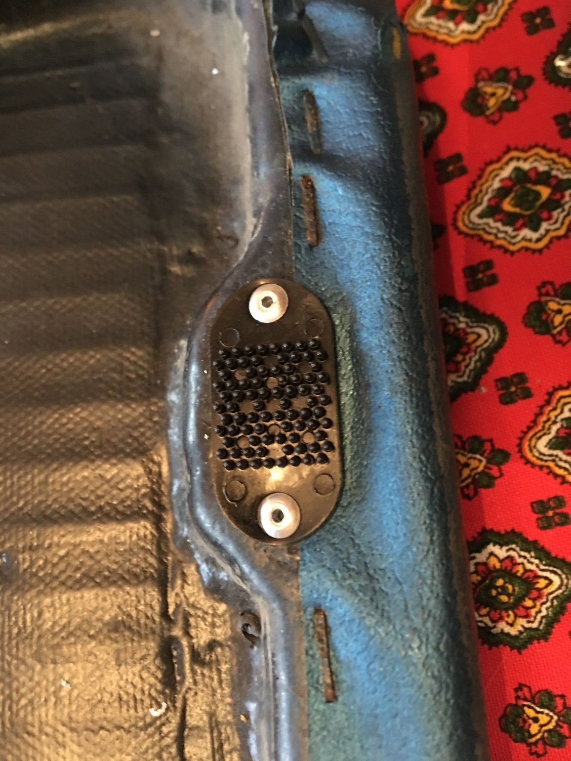

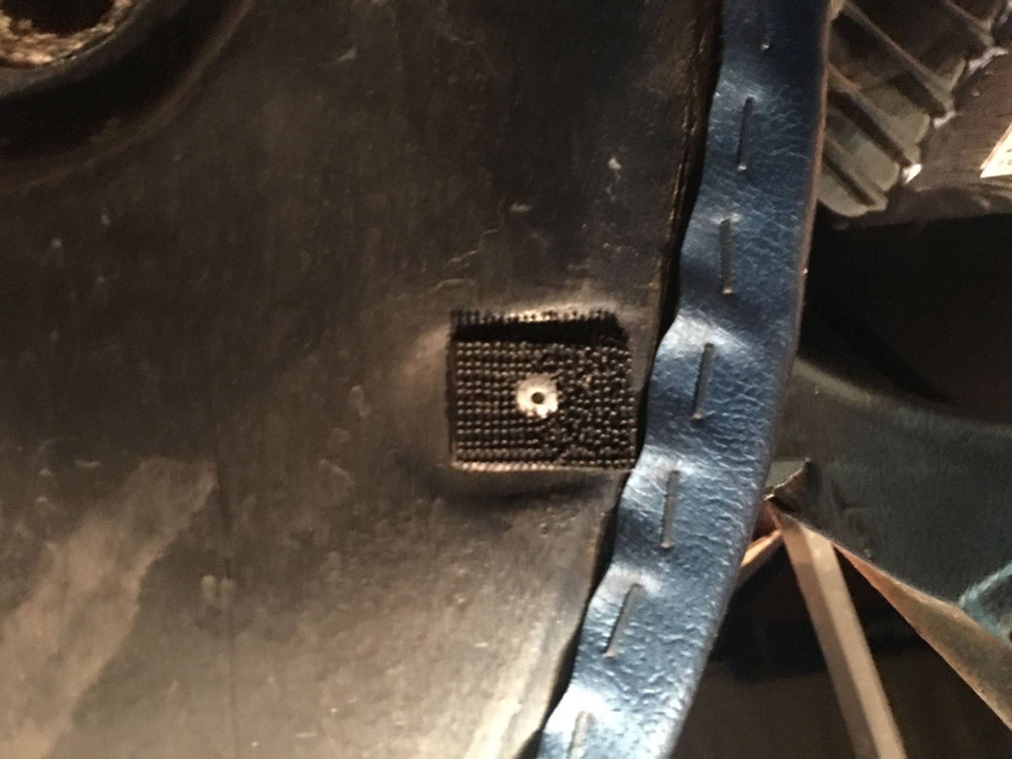

Sooo, I noticed that one of the reasons (a major one) that my door panels did not conform well to the door is that the wrong "Velcro pads" are riveted on there - also in a bubba way.
Are there any tips for riveting the correct ones on? Is the door panel designed to take them ?

It looks you have an old reproduction door panel. The original Velcro pads have two posts that you would need to drill holes for then you'll probably need some glue to hold them in place.
I have done that project once. Not too bad.
I probably have enough Velcro pads to do one door if you're interested.

Yep. That worked. Rivets and glue. Inside panel is quite rigid.
This has led me to discovering another problem, the door panel seems the be warped and even with the Velcro pads, it won’t stay against the door.
Im thinking I might have to make a few notches in the plastic to bend it back.

Hmmm - I am thinking about "notching" the ABS. My sense is that the ABS is very rigid. I think taking some of that out would go a long way. I have never seen door cars as rigid as these. Maybe drilling a series of 1/2 inch holes.
