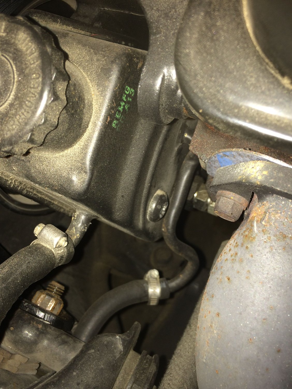

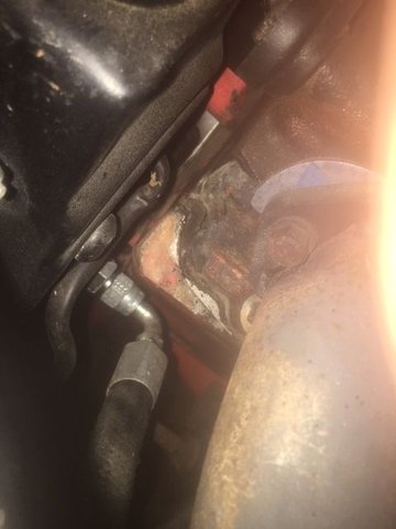

My serpentine system is off a 92 HD gm pick up. I had to clearance the block with a grinder slightly so I could get the -6 JIC (AN for the slang term) fitting on the pressure port. I have hydro-boost and the jeep steering conversion.
Great pic, thanks. Vette pumps have the return fitting in the center of the pump at a 45 degree angle....hits the block hard with the GMPP bracket. The Camaro pump return is vertical, with standard Vette steering the hoses kinks as it makes the bend down. For now, I'll probably just replace the reservoir housing.
