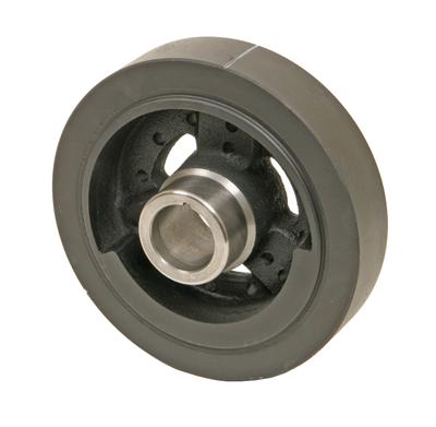

OP
We are trying to help you narrow this down ... there's a process.
A 454 damper is External balance and has a pronounced counterweight... here's a pic of a Pioneer pn DA4541 ... you can clearly see & feel the counterweight on the REAR of this damper
https://static.summitracing.com/glob....jpg?rep=False
https://www.summitracing.com/parts/pio-da-4541
