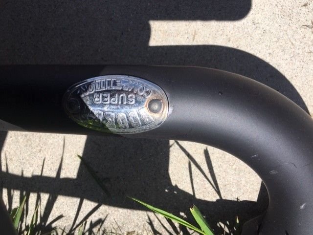

Old May 3, 2019 | 10:49 AM
Vette5311's Avatar
Vette5311
Joined: Mar 2018
Posts: 10,586
Likes: 2,064
From: Golden Colorado
Default Headers
Originally Posted by Mark Daniels
Are they comp's or super comp's. If you're not too far from Nebraska I could be intrested.
I was wrong, they are Super Comps. Here are some pics. PM me if your interested in buyiing. Thanks
To Header dilemma
