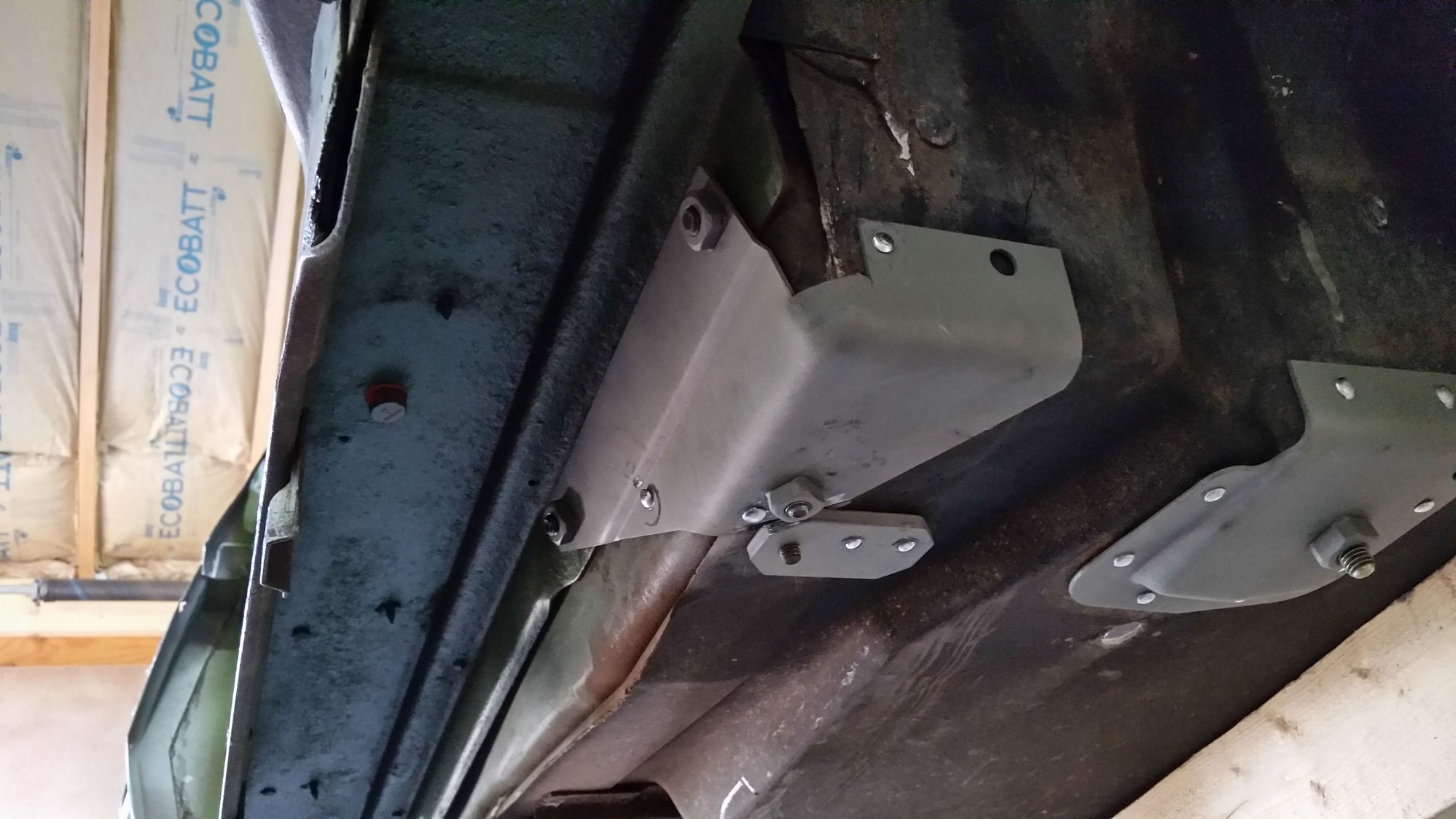

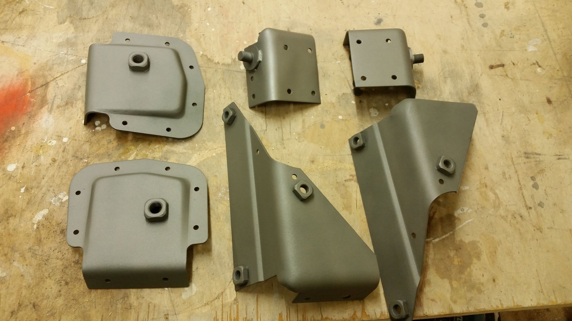

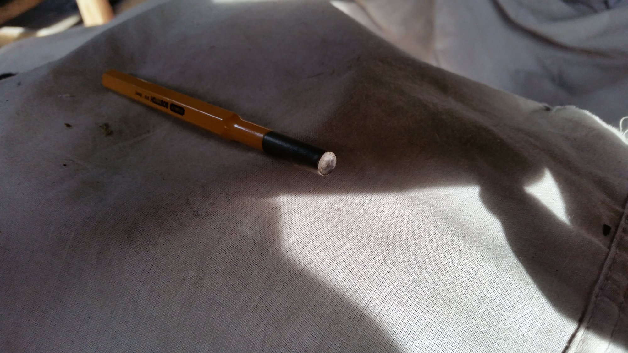

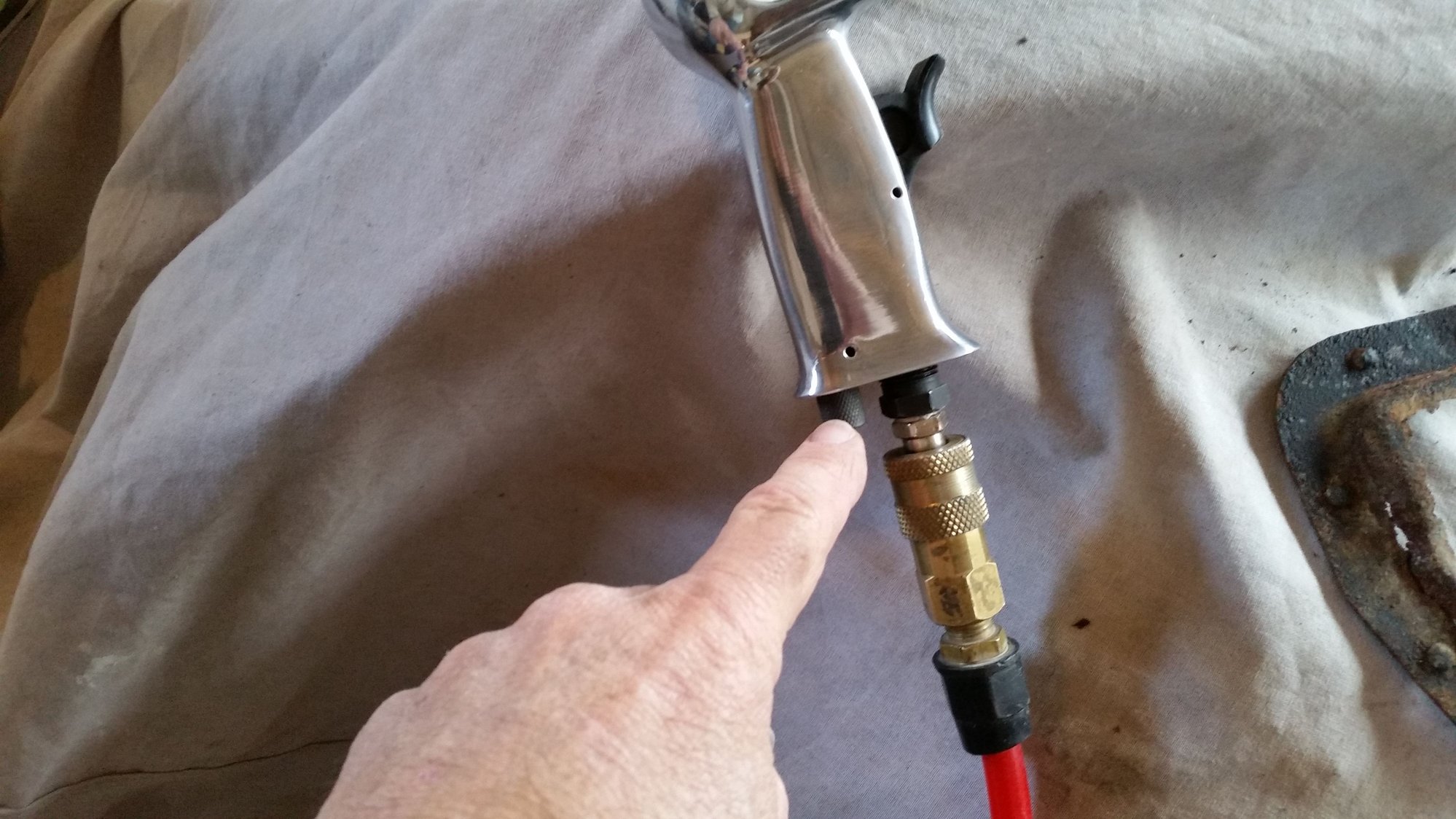

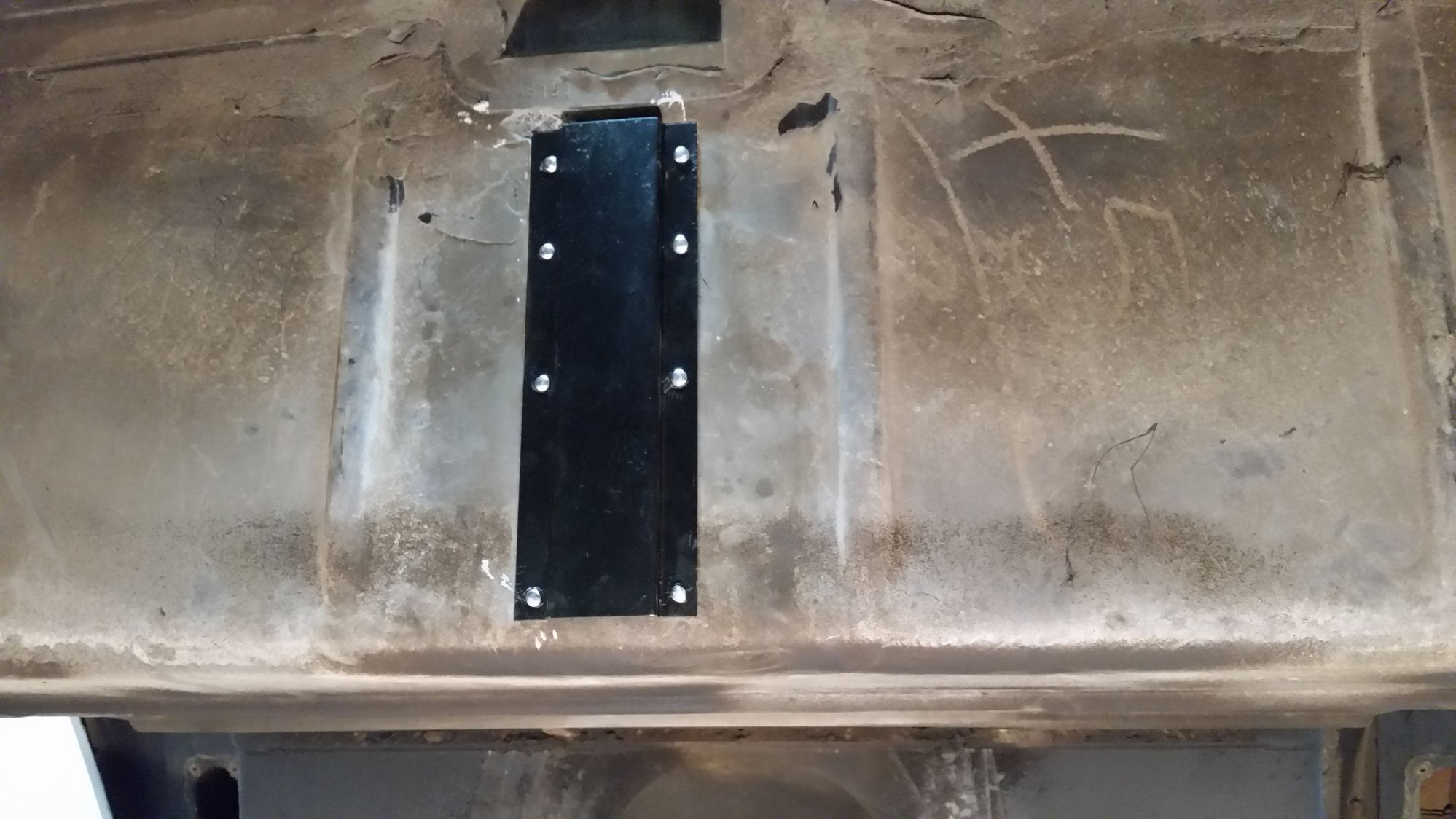

Harbor Freight small gun for tight spots. Bit is not bent it is an offset bit for tight spots. You can adjust the air pressure covered by my hand.
Some of the riveted brackets. Practice a little to get the right look. I had to redo a few.
Air adjusment
Different bucks, picked this set up on Ebay. Cleco pins also help hold the piece tight when setting the rivet
Had to cup a punch to get in real tight spots.
Most of the under the seat brackets depending on year of car.
Bracket support up in front of the gas tank.
So, like mentioned above, peen over the stem of the rivet which should be soft aluminum. Hope this helps!
