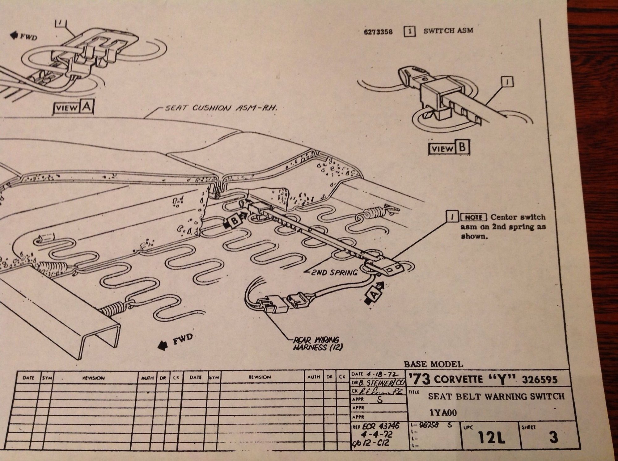

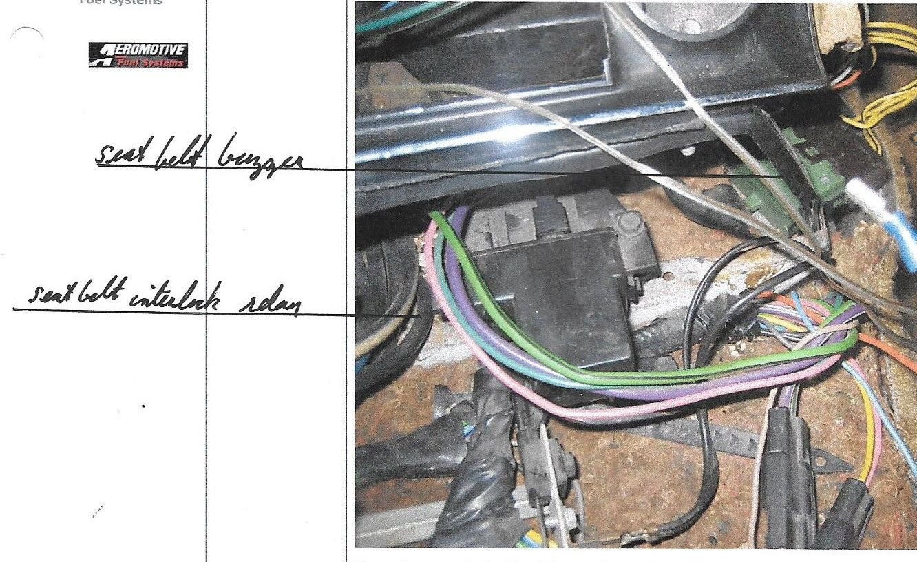

Next my fasten seatbelt light stays on. It was that way when I bought the car. The buzzer will stop buzzing when the belt is fastened but the light stays on. Any ideas? My car is a 75 convertible.

My fasten seatbelt light stays on. It was that way when I bought the car. The buzzer will stop buzzing when the belt is fastened but the light stays on. Any ideas? My car is a 75 convertible.
It might be the switch under the seat is out of adjustment.
That switch is ON when someone is in the seat.
The next switch is in the receiver next to the console.
That switch is OFF when you buckle up.
If that is not the problem then you have to dig to these parts.

Okay I had the seat out When redoing the interior and there is no switch underneath. A previous owner must have removed it and that's why the light is staying on. Thanks for that information.
If you decide to look further into the 'fix' there are 6 pages starting on page 12-70 in the GM service manual.
It goes into detail on testing both the buzzer and the relay.
