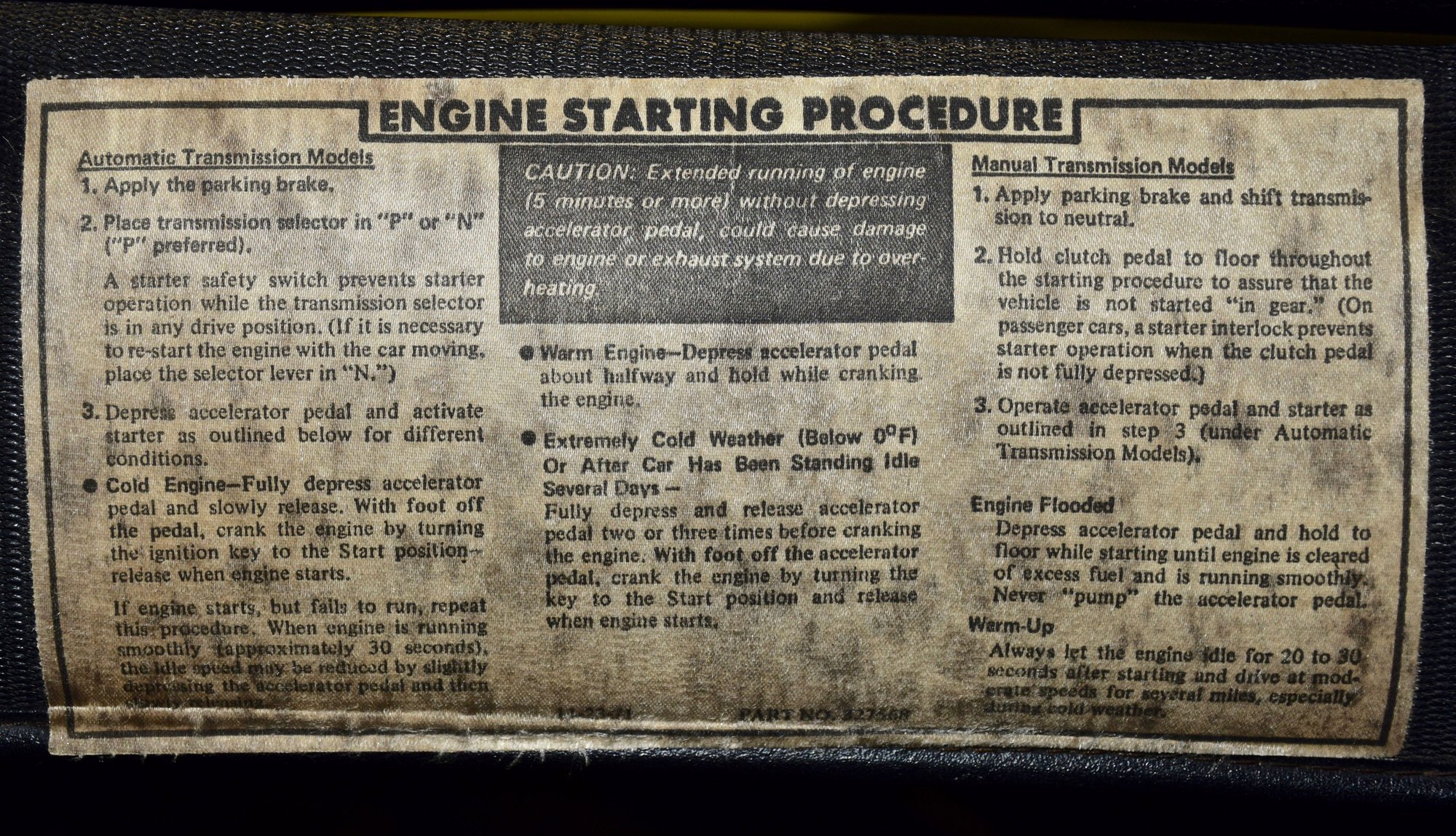

Here are the starting instructions from my original 73.
Donnie
Donnie
Is the caution statement just saying that leaving the car running at fast idle for more than 5 minutes is bad?
