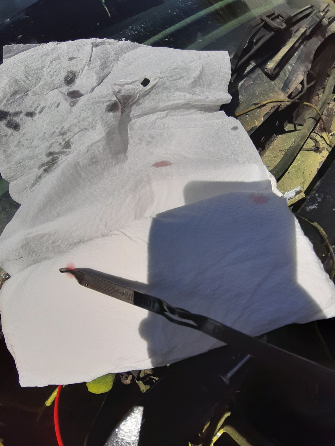

its overfilled right to first the L of FULL
You can see its foaming too. Best to remove some fluid?

Are you checking the fluid with the engine running and warm after having been put in R,N,D,N,R,P for a few seconds each? Not doing so could give you a false reading.
Yeah, idling in P
