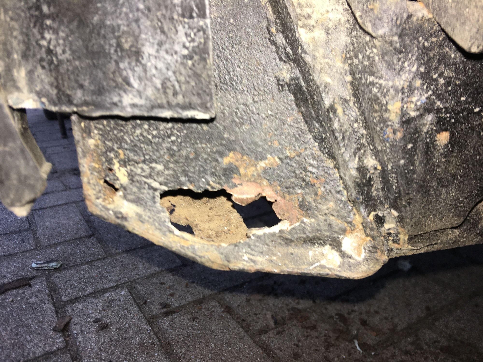

I guess it was to be expected at some point. I stumbled on some concealed rust. There was a chunk of Bondo over it.
I have alway been suspicious of under-car paint.
I of course went bananas and started poking around the entire frame with a pick hammer and a screwdriver. I could find no other rust.
It doesn’t look too bad; I quickly fell on solid metal. I’ll weld this up in couple of weeks or so when I’m finished with the interior.
I would like to know, however, what led to this. Shouldn’t there be drain holes in here ? It seems ludicrous that GM would allow water to pool up here with no means of evacuation.

There is an outlet located bottom corner of the channel.

Thank you!!!!!!!
It’s night time here; so no verification possible.
I’m pretty sure that was plugged.

...It seems ludicrous that GM would allow water to pool up here with no means of evacuation...
GM was not anticipating these cars would still be on the road fifty years after they were assembled.

Dorian, very sad news for sure, but after reading your other posts and the obstacles you've encountered, I must say not entirely unexpected.
Having said that and based on all the other tasks you've accomplished on this car, I'm convinced you can handle this one as well.
What you need to do now is determine how extensive the damage is or if it is localized. That will determine the best course of action.

Easy mike nailed it.
Sucks......so many car guys do hackwork like this and think nothing of it.
What happened to doing things right? Weld a piece over it, paint and motor on.
I too am leery of undercarriages esp when they use rhino coat or undercoating (worse stuff to get off ever).
Plus they both look like hell when they are dirty or painted over. Guess bondo and rattle can is some's idea of restoring you see it everyday. Youd think a nice car would more effort taken.
Oh well easy enoguh fix.

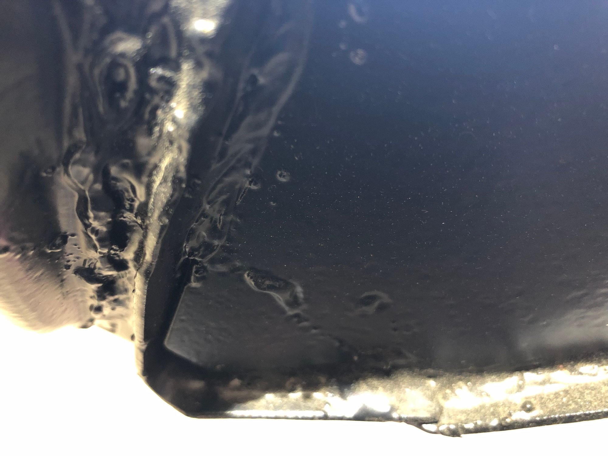

Sandblasted every square inch of mine, por 15d on to pof it in case.
After being garaged for yrs right after paint I noticed 2 thin streaks (stress cracks in paint) with a fine brown line...guess what.

Just hopeful for you that the rust is only at the bottom of the frame so you can access it .
Might be an idea to take a bottle of whiskey over to your welder neighbour now though.

when I was painting my frame found a lot of sand in there when I removed the rear trailing arms that plugged my holes. I kept poking at the hole then would slowly increase the air I was blasting through there to get all the sand out. And there was a lot

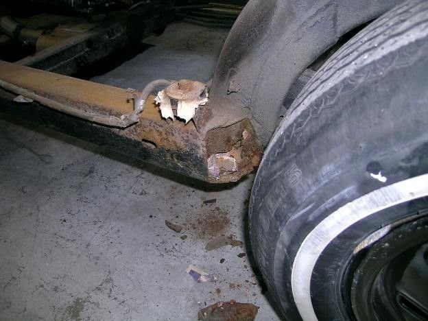

That is a very common place for frame rot on the C3's. I just recently welded in a section on my own for the same exact spot. The good news is that it isnt too difficult to get done

Pics of that would be helpful... if you have any, of course.

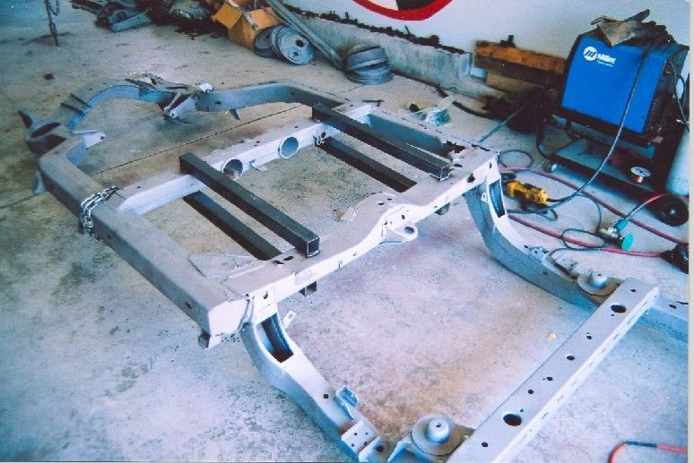

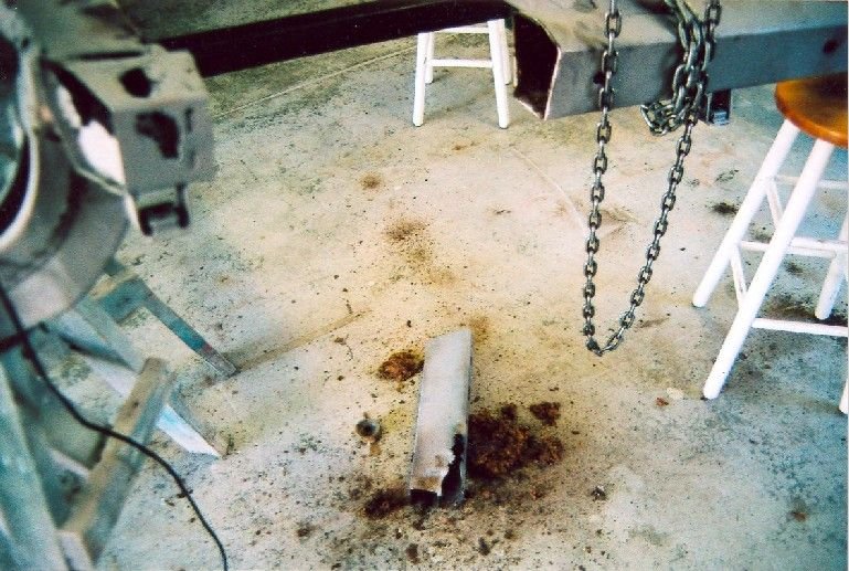

I had the same frame rust, but I pulled the body to fix it right:

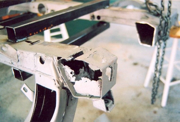

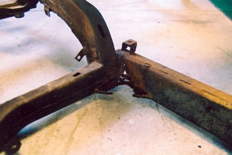

Here are the before shots:
I pulled the frame and sandblasted the areas before cutting the entire frame sections out. I welded in stiffening bars to keep the frame straight and correctly positioned while the frame sections were cut and welded:
First rusty section cut out:
New section being clamped and fitted into position:
New section welded in:
Nice, new, solid steel:
Better than new and ready for body to be re-installed:
Lars

That’s just stunning work

Nice Lars. These photos show exactly what I'd be concerned about "not seeing". Better to acknowledge there is maybe more than you know wrong and take the time and fix completely and not have come back to haunt you. Removing the body is not as big a deal as one would expect. It does make repairing/replacing things a lot easier.
Good luck with your repair bud.
