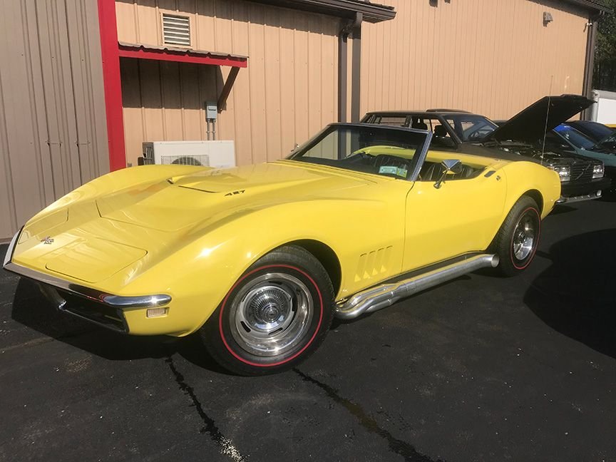

1968 427/390 with hotter cam (from PO)
Doug's headers/sidepipes
I made custom inserts - Magnaflows with 2.5" pipe and adapters.
I wrapped them with header tape and put them in.
They concept worked and the side-pipes do not burn BUT it is too loud.
So.... I want a fun daily summer driver. I do not want to put super restrictive inserts in.
Are all straight through inserts going to be real loud?
Are the spiral inserts better?
Am a chasing a fantasy and need to come to grips with the fact that header/side-pipes are loud?
I am considering going back to standard rear exhaust.
Thoughts?
Thanks.....

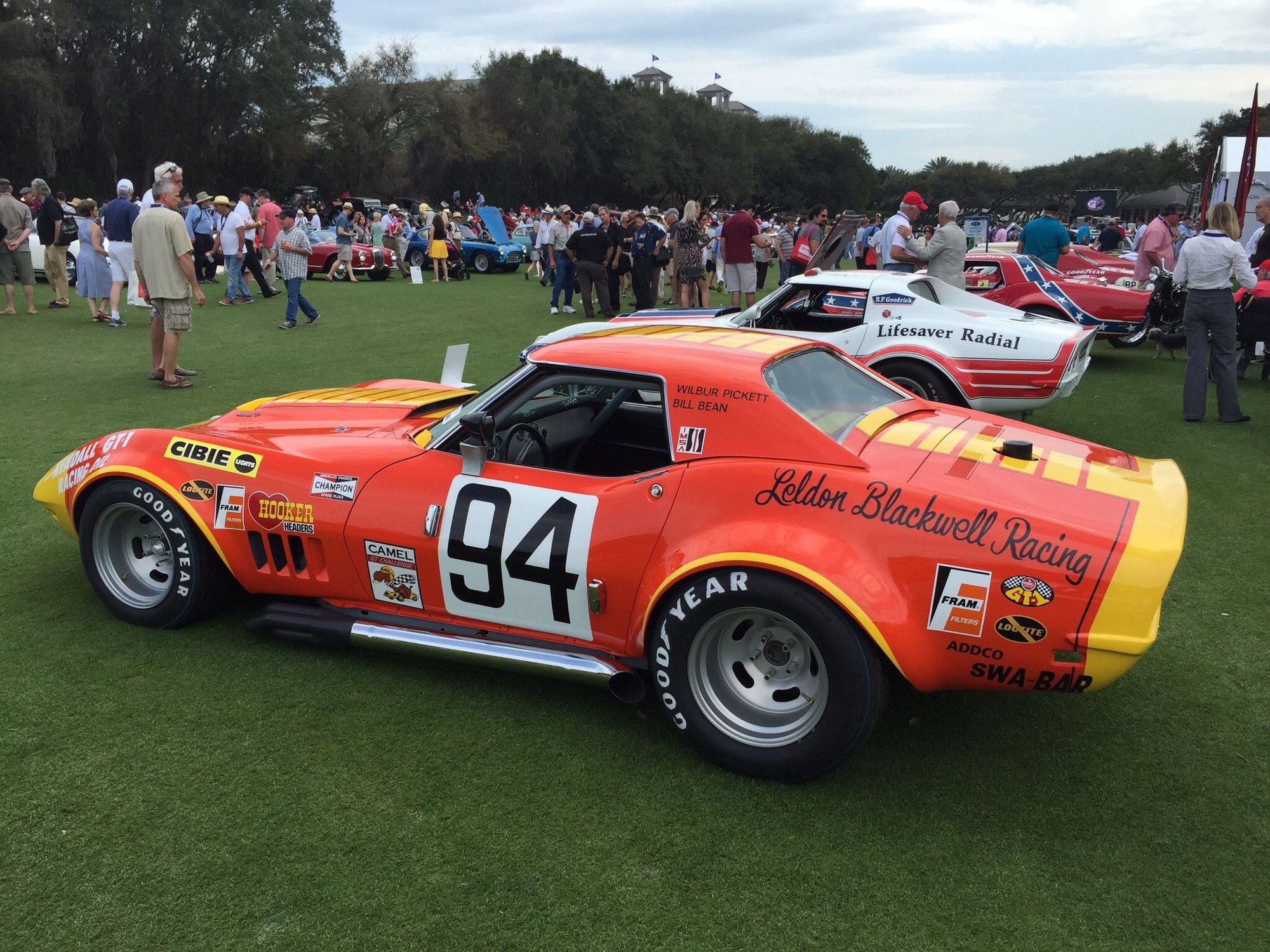

My 1969 L89 coupe with factory side pipes isn’t very loud at all. On the other hand my 1968 IMSA/TransAm Leldon Blackwell Racing race car is just perfect. It is nice and loud with its open side pipes.

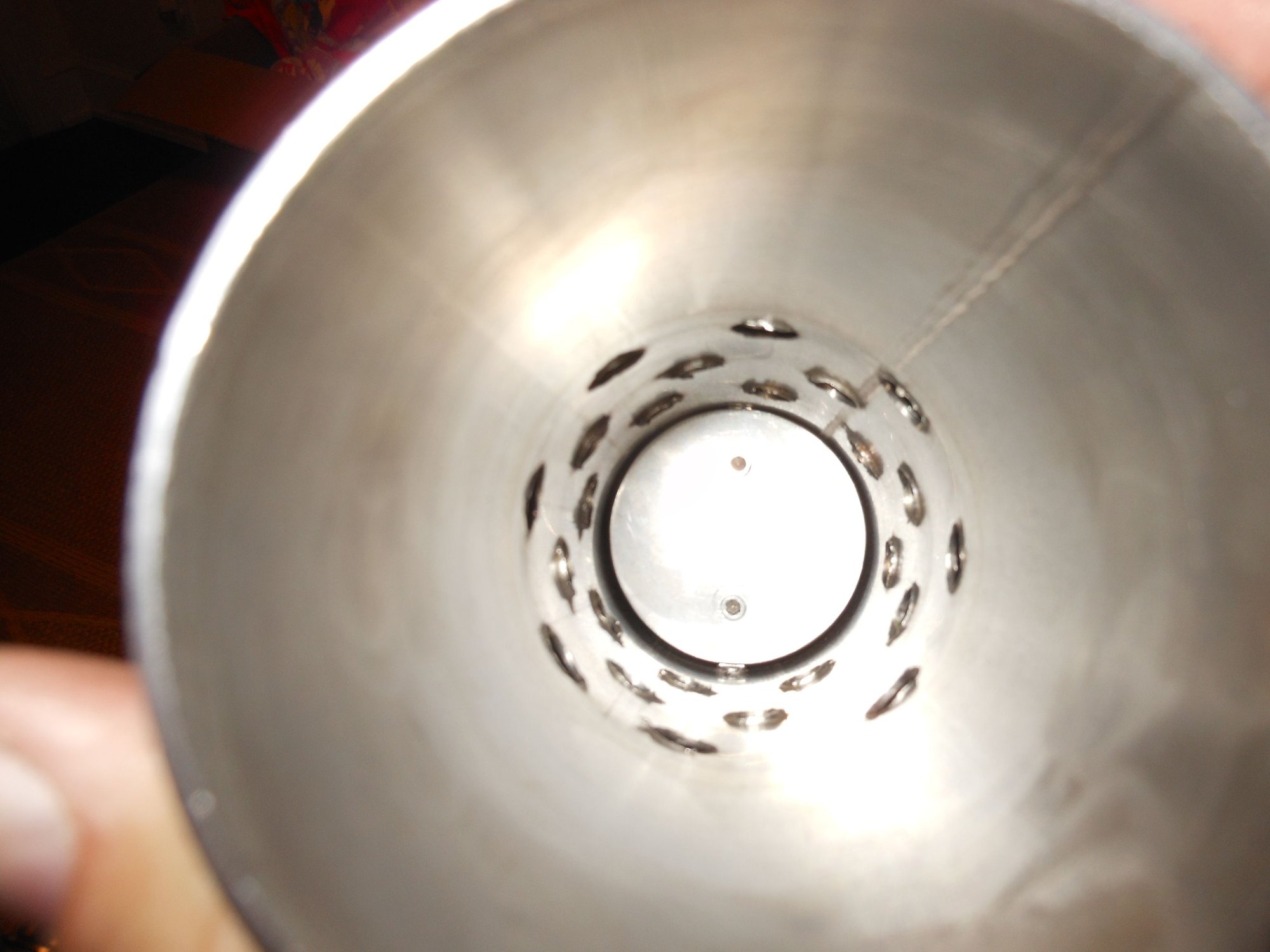

I have both-
Mines a combo- straight pipe and/or muffler. Using electric cut-outs to go between straight unmuffled to full muffler-
I made my own 20" long glasspac type muffler- as from what I have read after 20" the noise reduction is minimal.
perfed SS metal- insinkerator (SS steel) garbage disposal rings hold it together-
I used stainless steel tie wraps- Summit Racing sells them
I wrapped it with exhaust tape- to keep the fiberglass from blowing out-
Here's the cut out design-
Used V-bands to clamp together- and can change out insert if I don't get enough noise reduction
