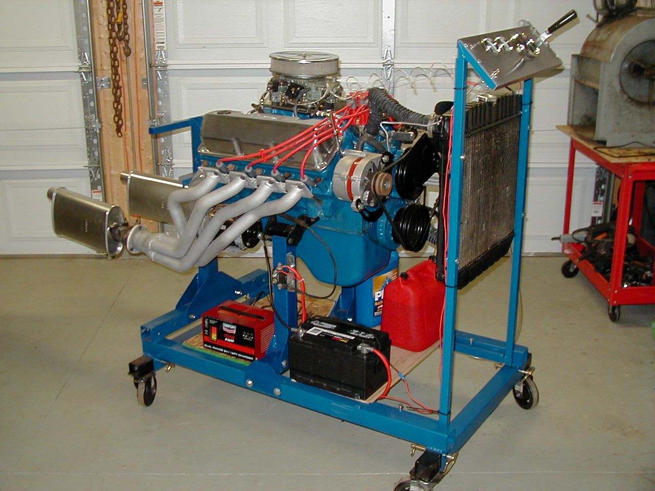

Hey Michael,
With your skills why not build an engine test stand?
You can use it for this and any future build.
Pretty straightforward build with some box steel.
I picked up some 4x4 box tubing, casters, headers, radiator off a Camaro, extra bellhousing for sbc to bolt to.
Slap a battery, gas can, some basic gauges, simple ignition switch and pretty much good to go.
Google or Youtube and you will see several.
Great way to test an engine just built and to break it in.
Don't ever use new chrome headers to break in an engine. Use an old set.
I have some drawings in my files somewhere.
Dennis

Default single pic of stand idea
check this out

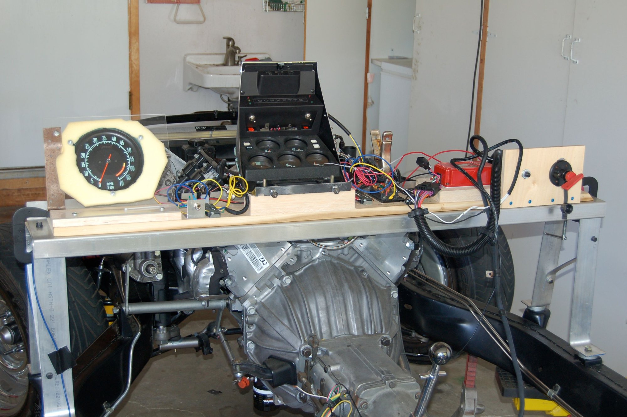

I built up a little dashboard using the original instruments. I wanted the wiring, etc as correct as possible so I wouldn't have to troubleshoot on my back under the dash wondering what the heck is wrong.
That looks quite fancy and while I like the idea of using the original wiring harness, mine needs a fair bit of work before it is usable and I think I would like to try to fire this up before I spend my time on the harness.
Always inspired by how other folks solve a problem with what they have available and will fit.
One of the great things about DIY cars.
Thanks
Very impressive
