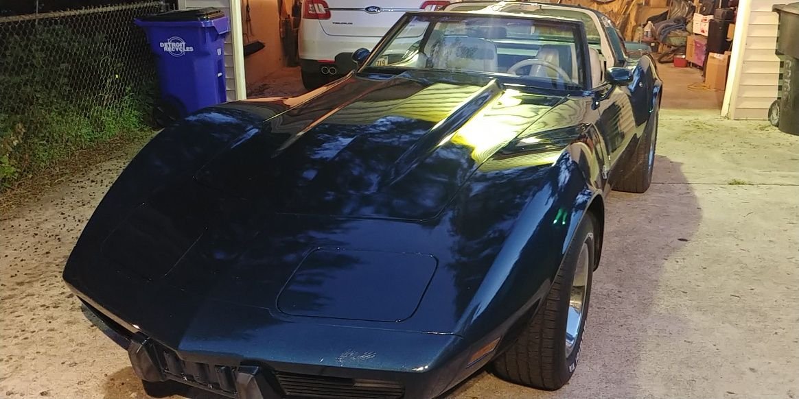

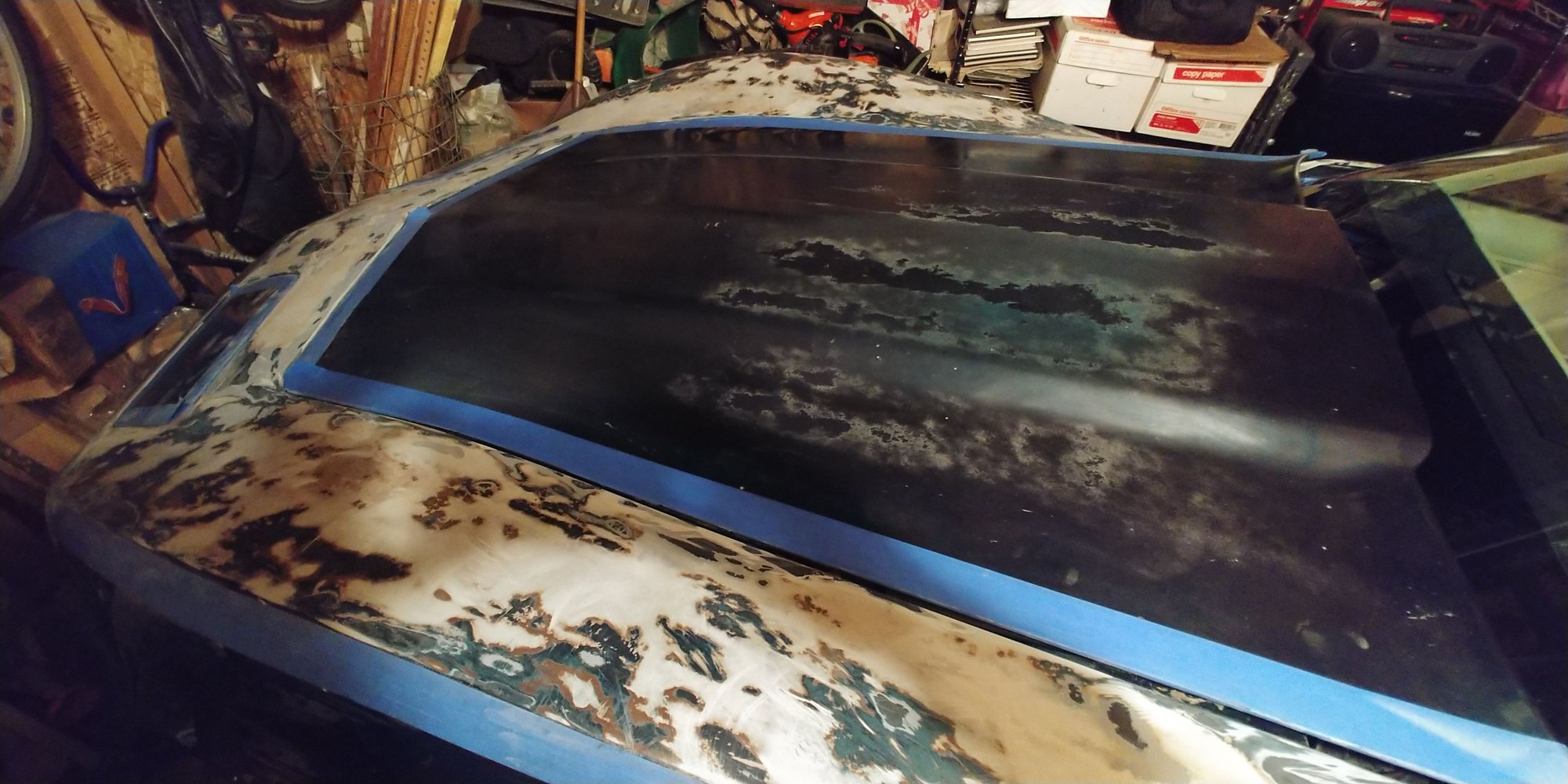

Once again I turn to you guys to steer me in the right direction. As you can see from the before photos the paint was peeling , cracking and flacking off primarily on the flat surface of the fenders. the other areas of the car are not so bad for 40 year old paint job so I thought. Well I had the bright idea of masking off that part of the car and applying Stripper to the panel. Well the stripper worked as prescribed however, from everything I have read it is not completely necessary to get all the original paint off. Also in those stubborn spots the Strip Kleen paint stripper for Fiberglass, did not work I used D8 6'' orbital with 80 grit then 120 to 150 to get it where I am at now. overall I think its pretty smooth but I did go to hard in a spot or two. what's my next step. Do I VPA in those spots or could I just block sand until I build up those spots?

Hopefully DUB or someone way more experienced than I will chime in but for my 2cents I think the next step is to guide coat and block sand just to see where the highs/lows are then fill accordingly. Rinse and repeat until smooth.

These cars are so curvy that pictures make it hard to see what you are talking about. I was told not to use a DA or sander on these cars without years of exp or you could damage them, so I always used a soft block or paint stick. I am guessing this is also why everyone uses stripper or razors to remove the paint.

I recommend removing all paint everywhere. I'm glad I did that with my paint project. Citristrip and time. No damage to the fiberglass and the only dust came from prep for paint. Used a Sherwin-Williams product called Composite Surfacer to fill in most pin holes and a single stage paint called Jet-Glo.

I can say for a fact that IF this car were in my shop. ALL of the paint/primer would come off and not just sand it and leave some regardless if it feels smooth or not. Reason i would strip it all the way down is because I have done this for so long I no longer take any chances and have a possible problem occur AFTER the car is all painted.
NOW...on the other hand...some people shoot primer over what you have accomplished with the stripping and sanding it and have turned out decent paint jobs that lasted for a good while.

I have almost a half of gallon of stripper left. I will do that first. is it possible to do this as a spot repair. like I am attempting to do? keep in mind I want to drive it fir the summer at least twice. since these summer months are so short. I will do the full rrepaint after my kid finishes college in 2 years.
