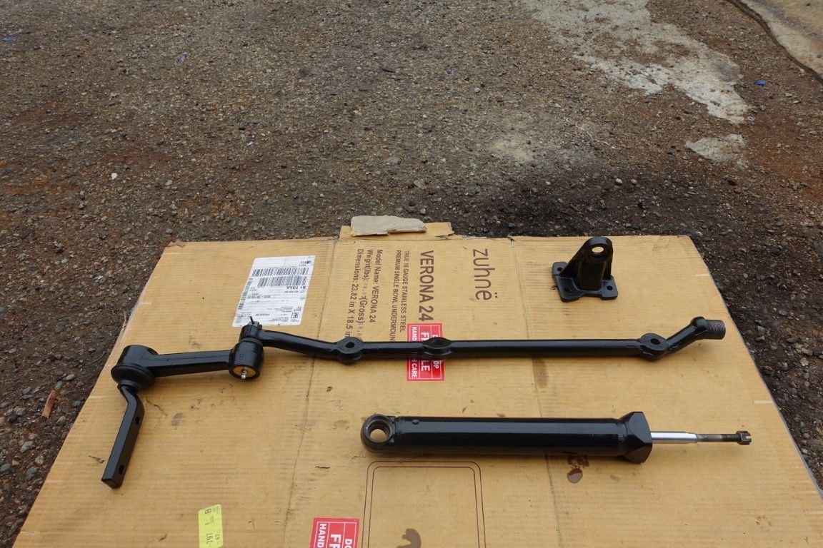

Since the last post, I've got a few things done:
  • Cleaned up and painted all the power steering parts
  • "Rebuilt" the steering cylinder with new seals,and replaced idler arm
  • Painted new calipers

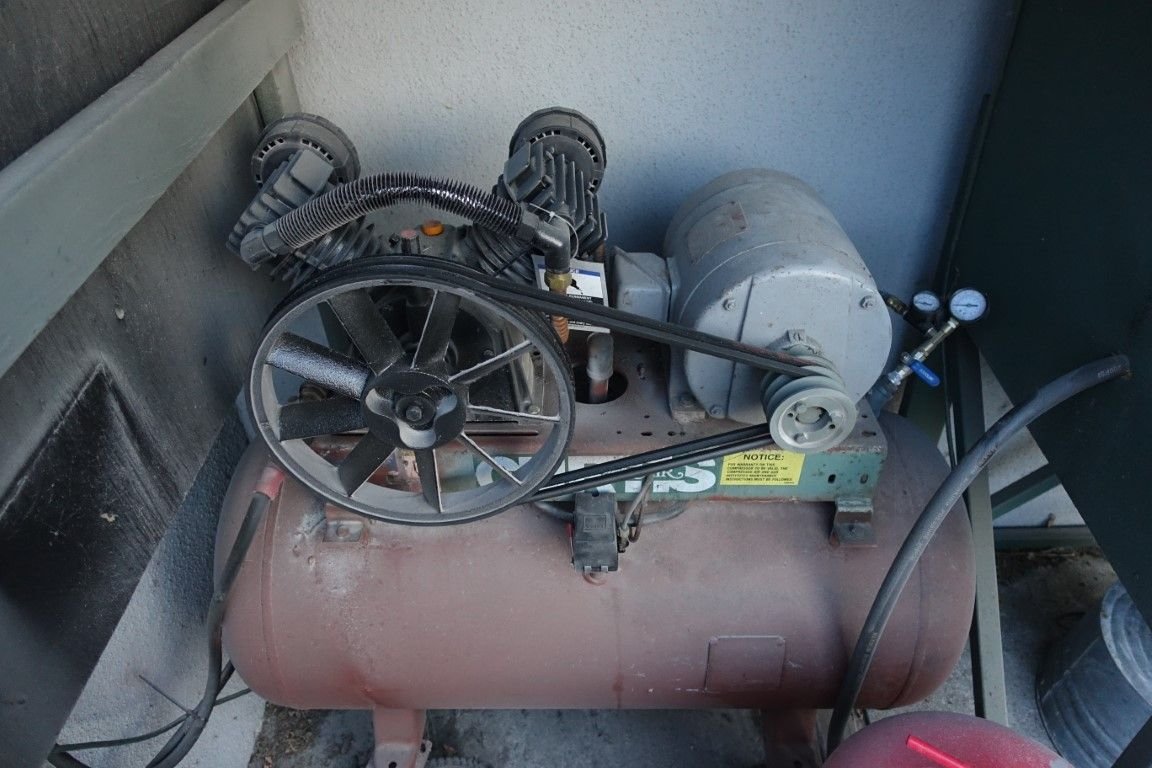

  • Finished my blasting cabinet, and 3 phase Bridgeport spindle motor-powered air compressor
  • Dismantled and blasted all control arms
  • Painted and replaced bushings in the lower control arms, uppers will get paint and bushings tomorrow

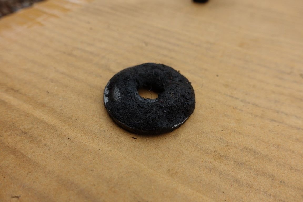

I am having a problem with the reassembled lower control arms, however. I didnt do a good job of taking pictures when I knocked out the old bushing sleeves, but most of them had worn through the rubber and were metal on metal anyway. With the new parts installed, the arm assembly with bushings is much wider than the cross shaft. There is also a small gap between the end of the cross shaft and the inner bushing sleeve. All bushings are fully seated in the control arm. If anyone has done this job recently and remembers how the upper arm and cross shaft looks when correctly assembled, I would appreciate any input.

Nice clean steering parts and calipers:

My DIY compressor, blast cabinet and cover finally operational. I wish I could get the compressor much further away from the blaster to keep abrasive dust out of it, but I don't have another place to put it. I guess I'll just keep up with the filter and oil changes and see how long the cheap pump lives...
