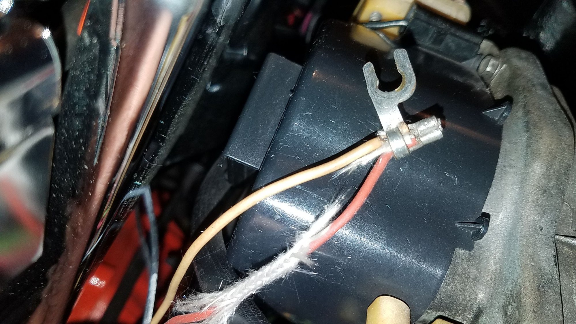

Connections to the coil.
Positive side of the coil red is insulated then a yellow wires are combined to one terminal and the a black wire from the radio capacitor
Negative side of coil is black from distributor
Reading from Positive side
Key on 8 volts
Cranking 12 volts (Distributor coil wire removed from dist. Cap)
Running 12 volts
Reading from Negative side
Key on 0 volts
Cranking 8 volts
Running 8-10 volts based on RPM’s
Thoughts?
Rick

That is not right. There should not be a red wire to the positive side of the coil. It is just the yellow resistor wire to the + side of the coil. Where is the red wire coming from. The yellow resistor wire should be coming from the starter. Sounds like Bubba was in the wiring harness.
There should be two wires going to the coil + terminal. The resistive wire (of whatever color) goes through the firewall to the switch circuit. The other wire (non-resistive) goes down to the R terminal of the starter solenoid.
OP, the voltage readings are a bit odd. If you can, give us a voltage reading of the C+ terminal when the points are open, and when they are closed. That will speed up the diagnosis substantially.

Wiring schematic calls it W-R/B (not sure what that color supposed to be) but I see red, the connection looks like a factory crimp, so I’m not sure what to make of it. The Yellow supposed to go to the starter, W-R/B to the key, I'm going to have to unwrap to verify.
