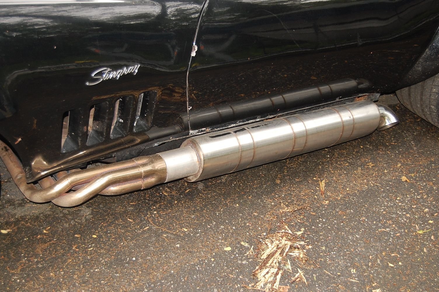

Has anyone else tried this?
I have Hooker side-mount headers. The first muffler I tried was the "glass-pak". I wanted the car quieter and went to the quiet inserts. Unfortunately, the opening was so small they choked the motor. So then I tried the Flow Max. There was a big increase in performance, but the car was so loud that you would have to lean over and shoot for the passenger to hear you.
I wanted to run the car at Lime Rock, so I had to find a way to get the car quieter, yet not choke the motor. I called Borla and spoke to one of the Borla owners (sorry I don't remember the name). He said they had a racing muffler for jeeps. It was very low restriction, would fit my car and was the most quiet muffler they had (it is huge).
See pics. The performance is excellent. The back pressure is low. The mufflers are actually touchable after you run the car (try that with Hookers). The only issue is the car is far from quiet. I will try to run at Lime Rock and see. I also welded the tip slightly down so it would not be pointing directly at the sound meters.
Not super pretty, but very functional.

I would love if you could post a video of the car running. I am a huge fan of Borla in general although I have never seen that type of muffler from them. Good luck with your run at Lime Rock.

Nice - I wanted to do something like this but was to chicken to purchase a muffler, I was to unsure of the look and them mufflers ain't cheap.

I too would like to hear how they sound. They sure look tough and am surprised you can still open the doors !!
I respectfully disagree. I think they look pretty bad ***!!
I'm in for a video with sound also. I might have some STS inserts for sale soon.
