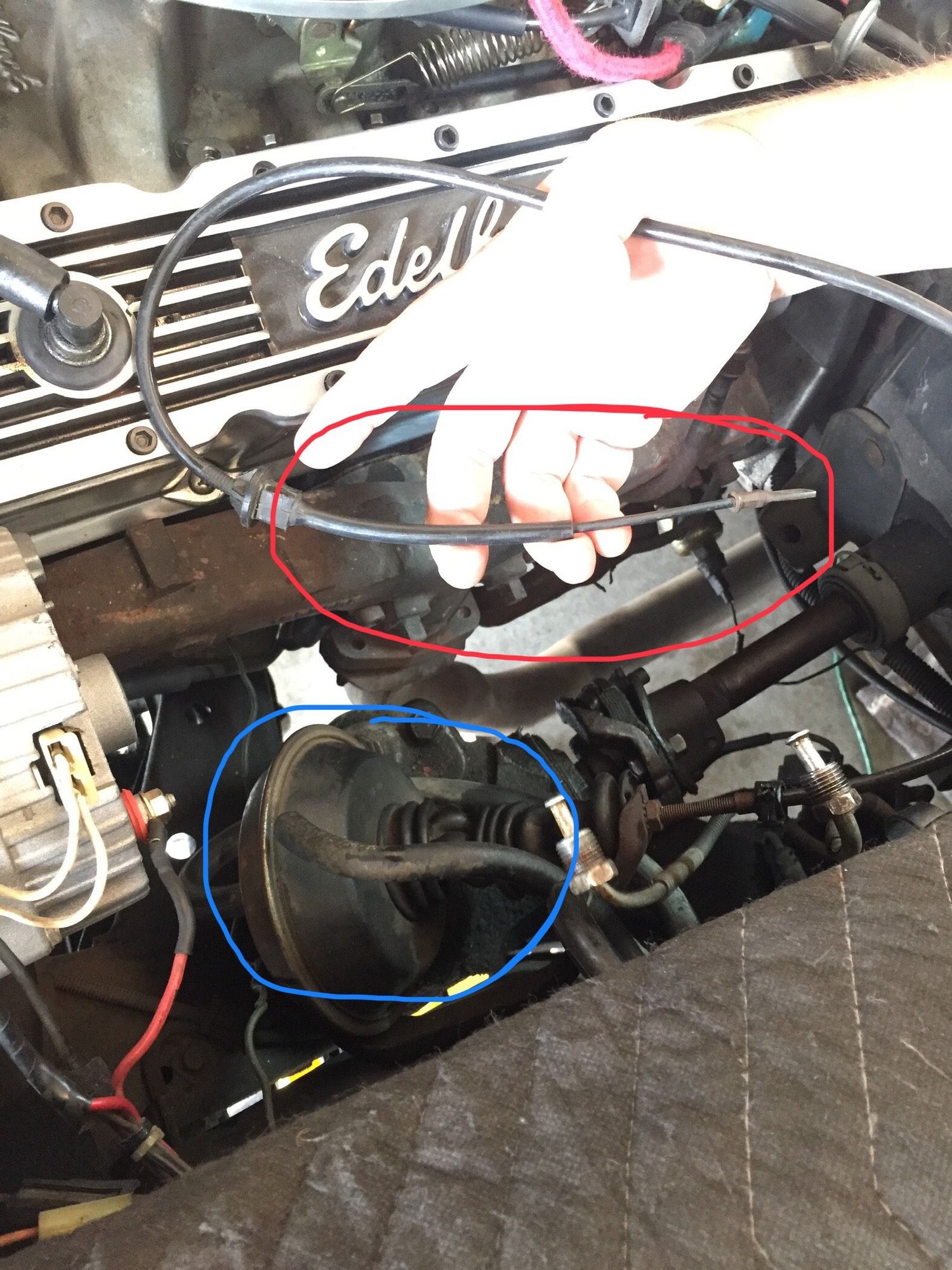

Can anyone tell me what the cable in this photo (circled in RED) goes to? Its connected to the vacuum (circled in BLUE), but the cable isnt connected to anything else. Any help would be awesome!

That is the cable for the transmission kick down.

Looks like the cruise control cable

Cruise control cable and servo. A 1977 only part , hard to find dont throw it away.

You guys nailed it.
My mistake.

cruise control cable and servo. A 1977 only part , hard to find dont throw it away.
^^^this^^^
If it's a 77 it is cruise cable and blue is the servo. If both are in working order they are worth about $300.00 for the pair.
