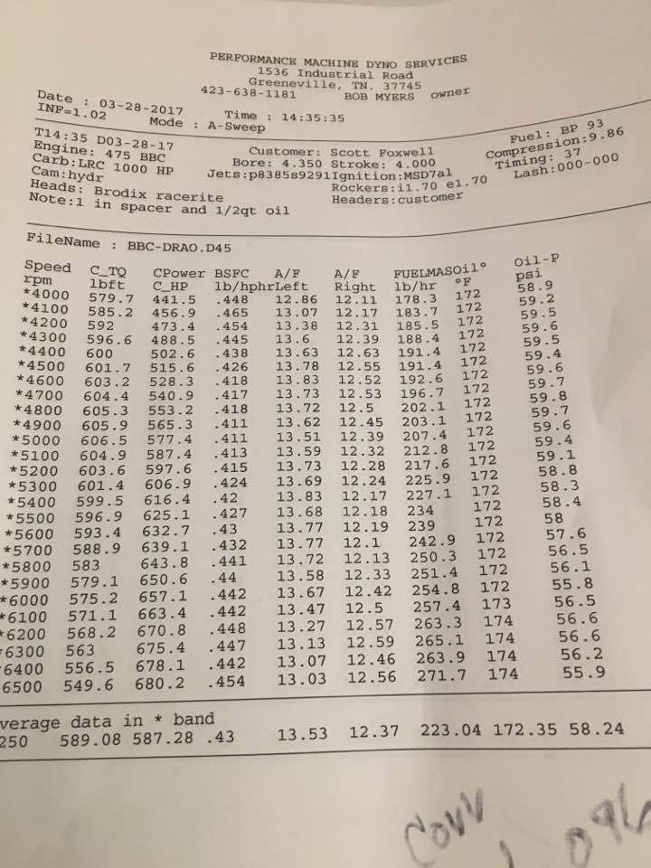

With OEM heads the duration split needs to be at least 12 degrees. The OEM exhaust port needs more time (duration) to get the exhaust out. A camshaft change will help quite a bit. Don't let the compression worry you that much. Cylinder pressure can be manipulated with camshaft. Just had a 475CID BBC with 9.86 to 1 make 680HP and 600#/ft.
Old Mar 30, 2017 | 11:18 AM
StraubTech's Avatar
StraubTech
Joined: Jul 2013
Posts: 1,299
Likes: 93
From: Tri-Cities TN
Here is the dyno sheet.
