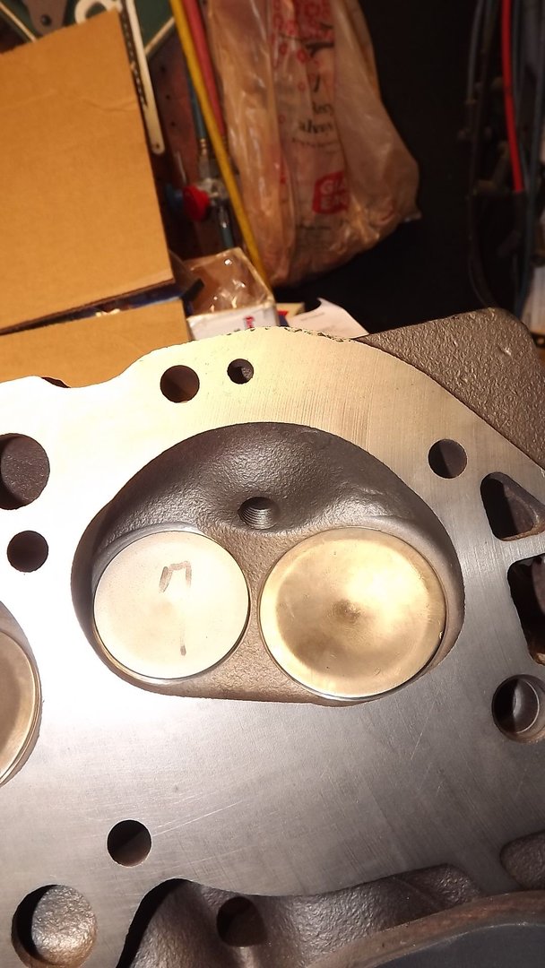

I dug up my dyno sheets from a few years back. My combo was a .030 over 454, slightly domed pistons (can't find the specs), a Summit 1302 cam with comp "high rev" lifters, edelbrock performer Q-jet RPM intake, 800cfm Q-jet, Stone stock 049 heads, 1 3/4 mid length headers. Compression was somewhere in the mid 9:1 range. It made 339 HP @ 5400 & 445 torque @ 3300. Through an automatic.
Since the dyno run I have swapped the heads for 781's fitted with 2.19 intake & 1.88 ex. The heads were milled and CC'ed. CC volume was verified at 114cc. I measured everything when it was apart and using a compression calculator the comp is 10.07:1 now. I'm using a .024", smaller bore cometic head gasket (Over the standard rebuilder type). I also swapped the headers for 1 7/8 full length with an X pipe exhaust. I have not dynoed it since, but my butt tells me it was worth a good 30 horse or so. It was enough to push my 4200 pound chevelle (with driver & gas) into the 12's. I would like to get back to the dyno this year.
As was posted earlier, You most likely have peanut port heads. Something isn't right, and this is through a manual trans? Pull a valve cover and google the casting numbers. I'm also wondering if the timing chain was installed off.
Here a few pics of my heads. The fresh ones are the 781's. 781 & 049 are basically the same head and an excellent head for street use. You really do need a domed piston to get any kind of compression, they have large chambers. I've seen on line anywhere from 112cc to 120cc. Mine measured 114 after milling.
