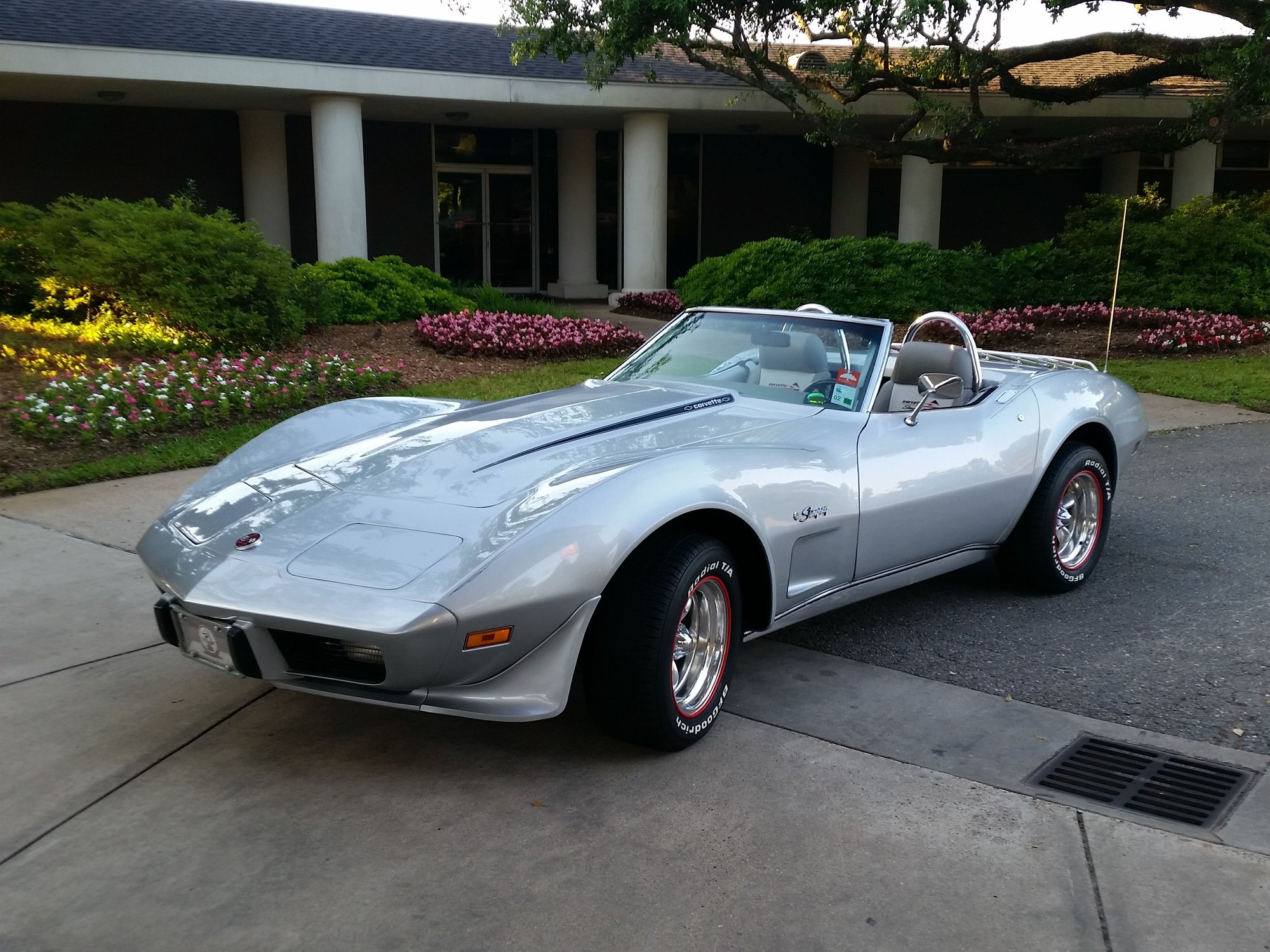

Originally Posted by vetteguy75
Good Question....awaiting answer as I, too, have a '75.
Excuse me but I had to but in as I have the same rim and red rimsaver combo but don't have raised white lettering, I just love the look, thanks, I'm getting out the white sharpie!!!!!

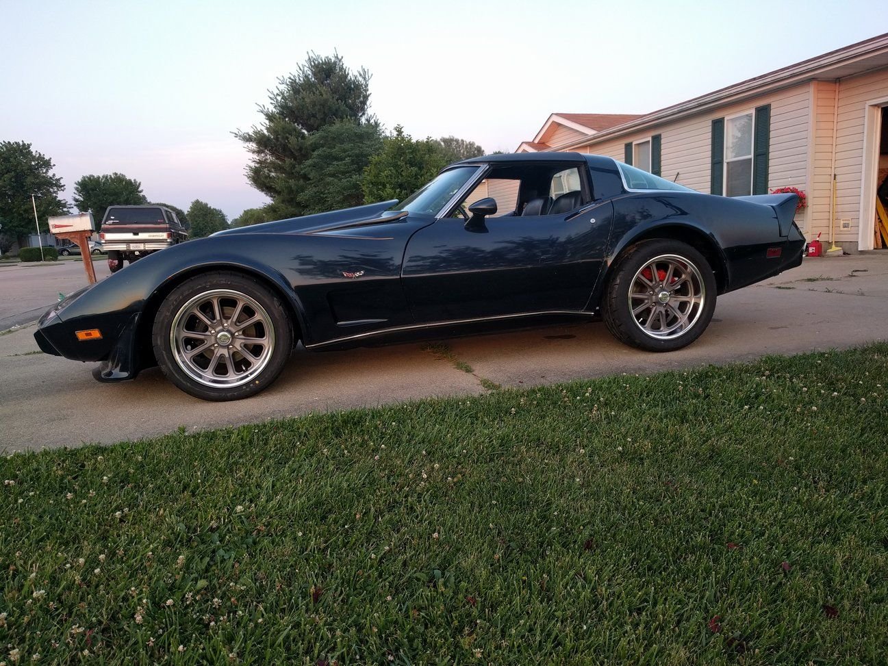

those dont look like 18s on the Nissan, heres what 18s and 26.7 in tall tire looks like on a 79
