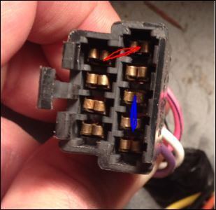

Default Wiper issue resolved by bypassing intermittent controller
Thanks again guys for direction on this. Below is a picture of the disconnected connector in the storage bin. The red and blue lines show the positions I jumpered based on the references you provided. The red line jumpers the pink and pink-with-black-stripe wires. The blue line jumpers the white and brown-with-white-stripe wires. The result is wiper switch position 1 which was previously pulse now operates at normal speed. Positions 2 and 3 operate as before, i.e. normal and high speed. Now I just need to find the right size tabs to crimp on some wires and make the fix permanent.
positions to jumper to bypass pulse controller
