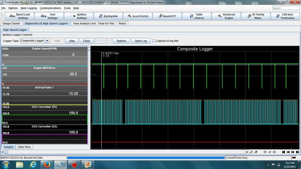

When it doesn't crank- give it a shot of ethanol. No fire- I'd look at the crank/cam sensor.
If you do have a start with the fluid--
Could be a bad regulator...-I had the issue with a bad o ring on my regulator.
The software I'm running can check for correct cam and crank signal-
