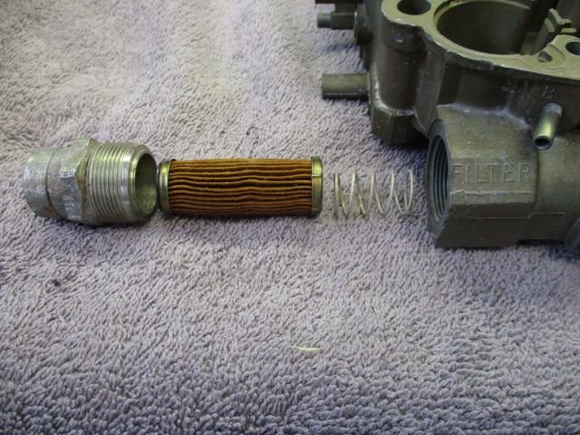

Unfortunately, someone has hacked up your fuel line and installed that aftermarket filter (not good). If you still have a Q-Jet carb, buy a new reproduction steel fuel line, throw that thing away, and replace your in-carb filter. Make sure you still have the spring. NAPA part number 3052 for the good filter.
...But I'm going to bet that they didn't just hack the fuel line - based on the angle of that rubber line that they installed, I'm betting they also removed your Q-Jet carb and installed an Edlebrock carb as part of the "mod" job...

You can replace that filter with any in-line fuel filter with 3/8" hose nipples. Avoid the glass filters. These types of "generic" filters are available from any auto parts store - don't tell them you want a filter for a 'Vette, because you'll get the in-carb filter shown in my post above - you just want a generic, aftermarket, in-line filter. NAPA has one under part number NOE 7401158 for about $5. This is a clear nylon plastic filter housing with a sintered bronze filter element and a lifetime warranty.
Be aware that, depending on the type of carb you have, that the carb itself could have an in-carb filter. If you have an in-carb filter, you need to remove it if you are going to use the in-line filter - do not run 2 filters in the system. You might want to check that...
