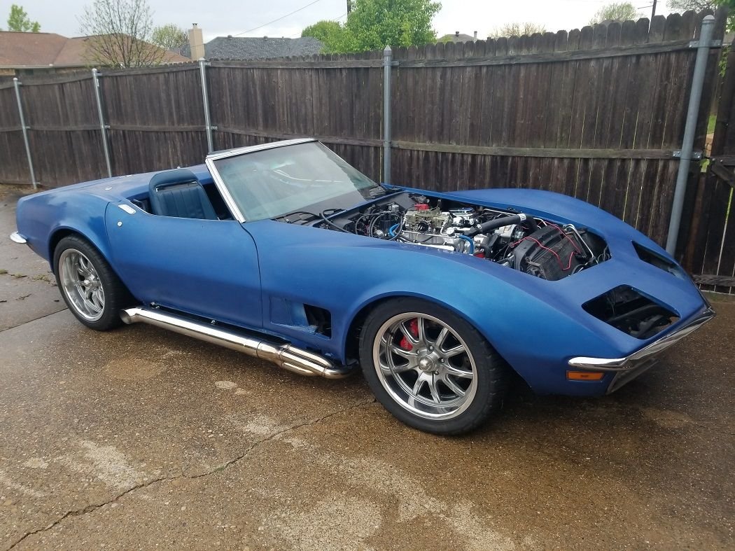

'71 convertible, Borgenson box, TH400 auto trans, 454 with Procomp aluminum heads WITH 1/2 inch higher exhaust ports.... the 1/2 inch being critical for me. I bought the Maximizer brand... which I believe to be the same as the OBX.... I had more issues with the tubes where they exited from under the car. Because the headers were effectively moved up 1/2 inch, I had frame clearance issues on the drivers side and lower body clearance issues on both sides. It took a lot of trimming and massaging to get them to fit and I ultimately ended up using solid engine mounts to minimize any engine movement. I will say, the solid mounts aren't really an issue. From the work I had to do, It appears that having heads with stock exhaust port location would have simplified my install. Also, they advertise the primary tubes as 1 7/8 but actually the outer diameter is 2 1/8. The tubes are quite large. If you leave the pipes uncoated, they will eventually turn a light bronze. You can use polish to bring back the shine but would be a lot of work if the car is driven a lot. I had difficulty getting clear pictures of where I had to "massage" the pipes and/or the body that someone could look at and understand what they were looking at. Once installed, they do look really nice.... Oh, and one last thing, they are LOUD... even with the full length muffler insert. I am "that guy" that sets off all the car alarms when I roll through a parking lot. LOL
Thanks. How much work was it to get the headers to clear the steering box?

The 2nd pipe (cyl #3) on the driver side comes with a large "clearance dent" that because of the raised exhaust ports, ends up above the Borgenson box and is not actually needed. I did have to clearance the 3rd pipe (cyl #5) a little where the pipe gets close to the lower corner of the box, about 5 inches down from the exhaust flange.... again, only needed because of the raised exhaust ports.
