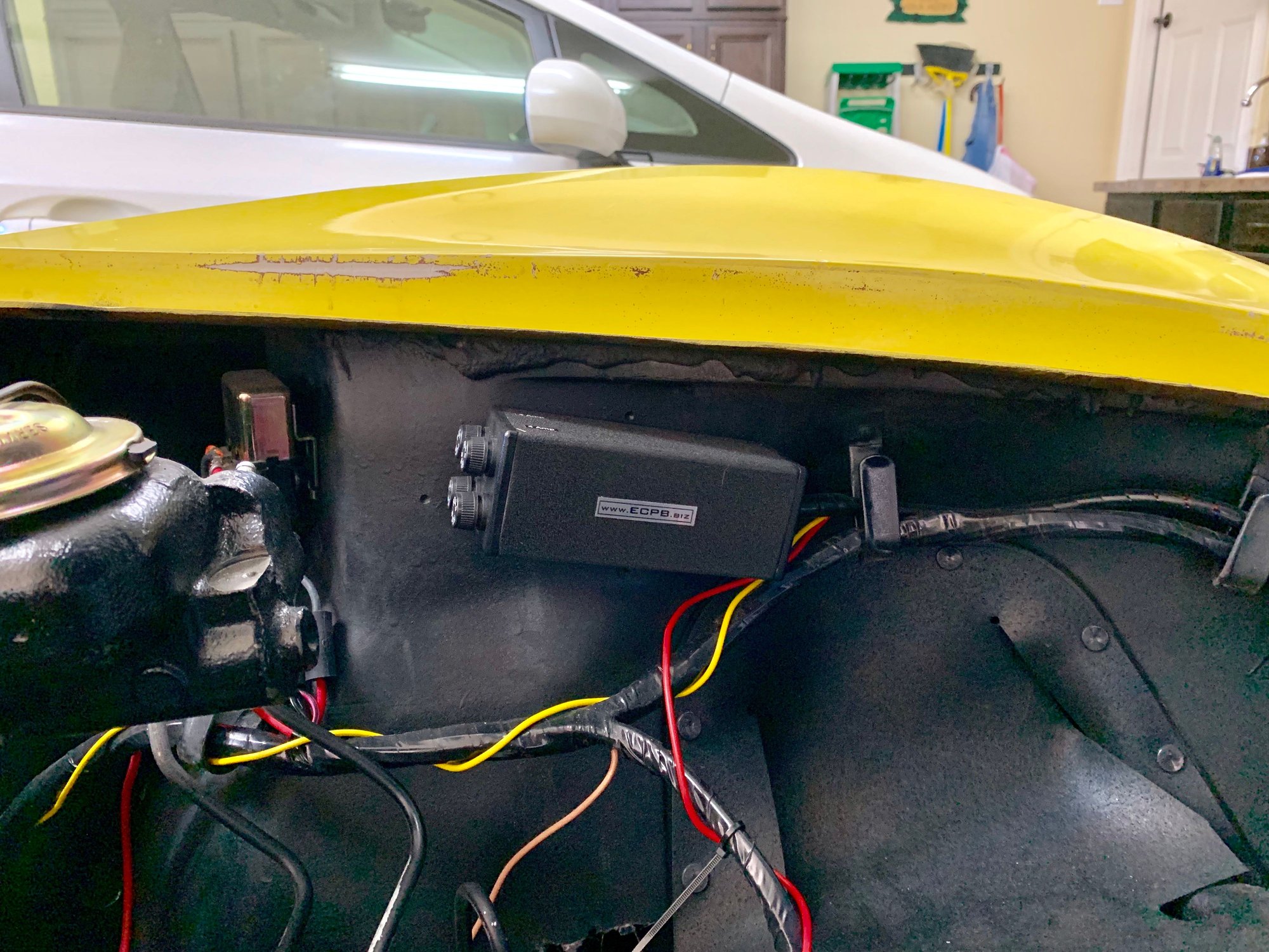

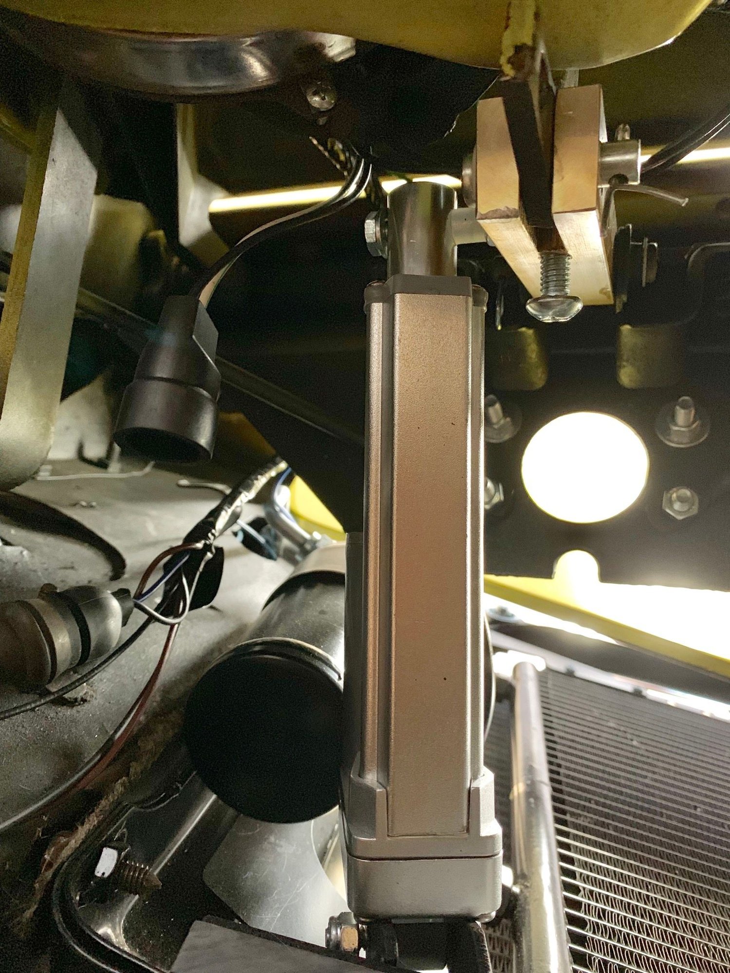

Yes I installed it in mine
was easy and works well. Here is a video I took when I was testing it.
The sound is exaggerated in recording.

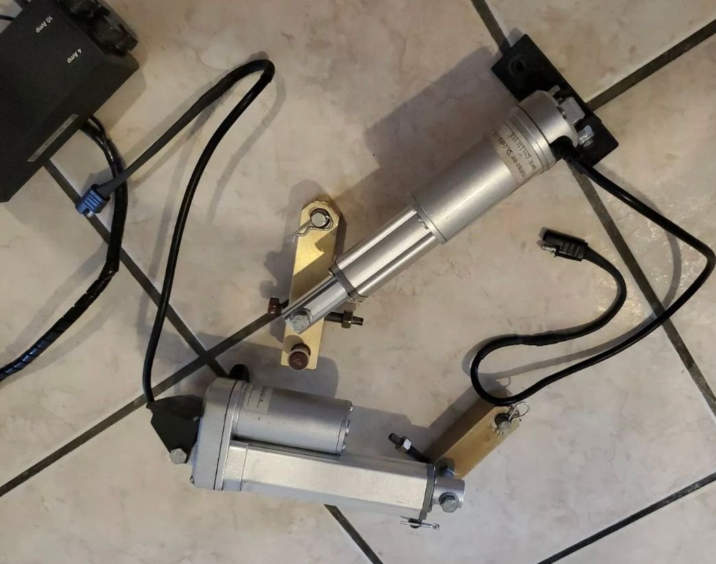

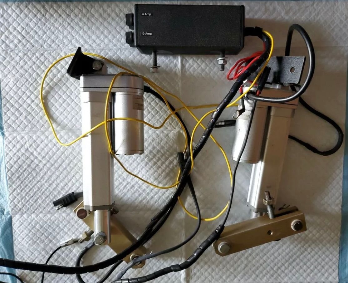

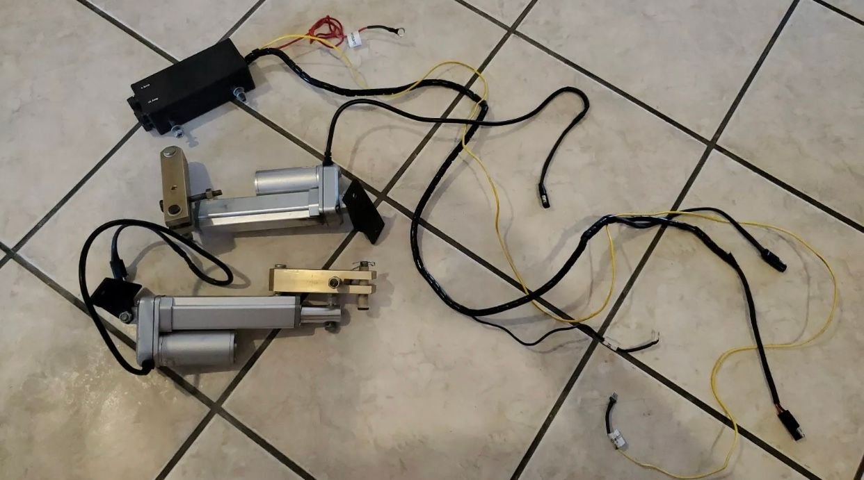

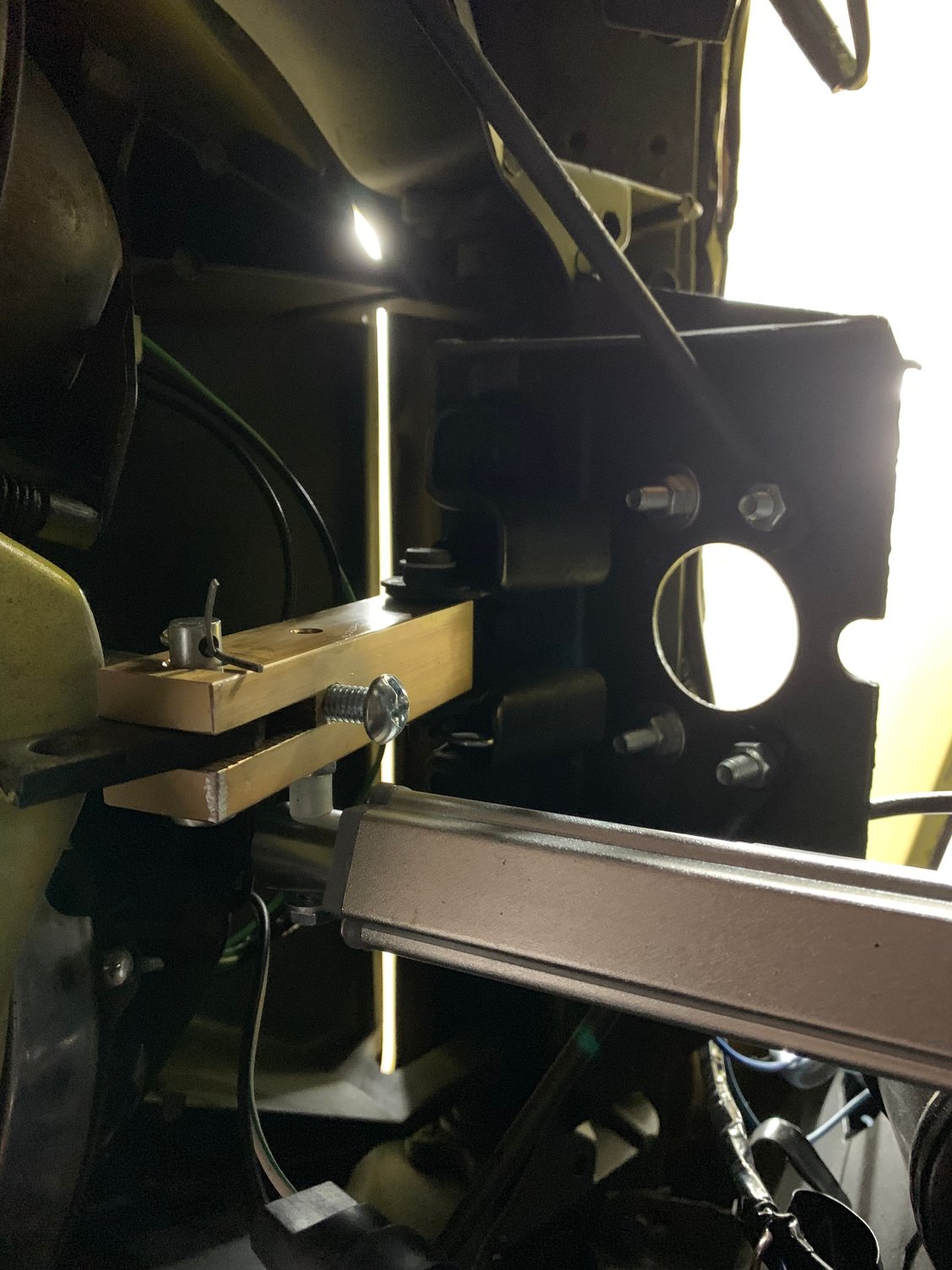

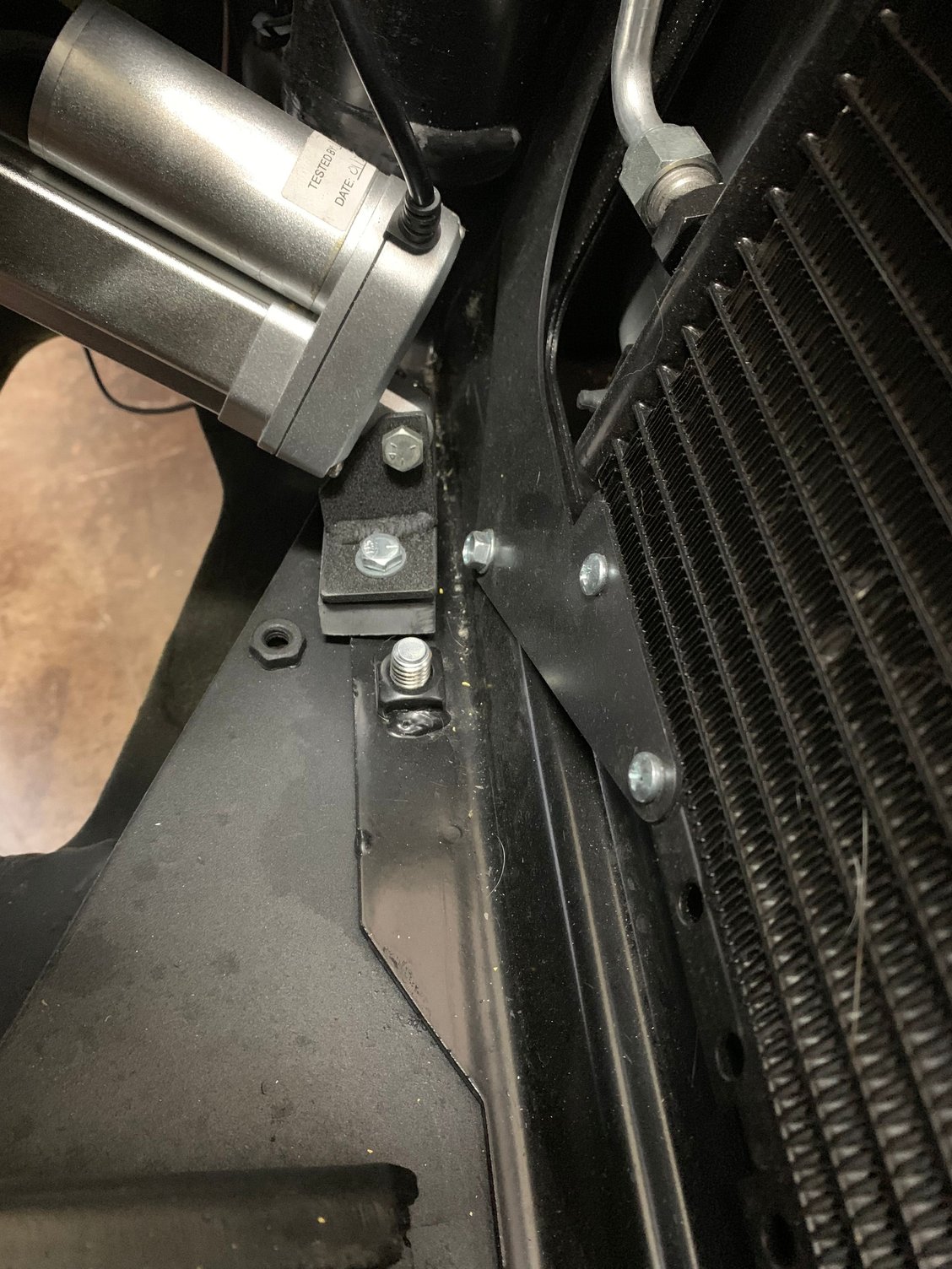

nice! how long did it take you to install? I wasn't going to get electronic headlights but then I came across this kit and I won it for $120 so I figured why not. Did you just disconnect the vacuum lines to the headlights or did you remove your vacuum system completely?

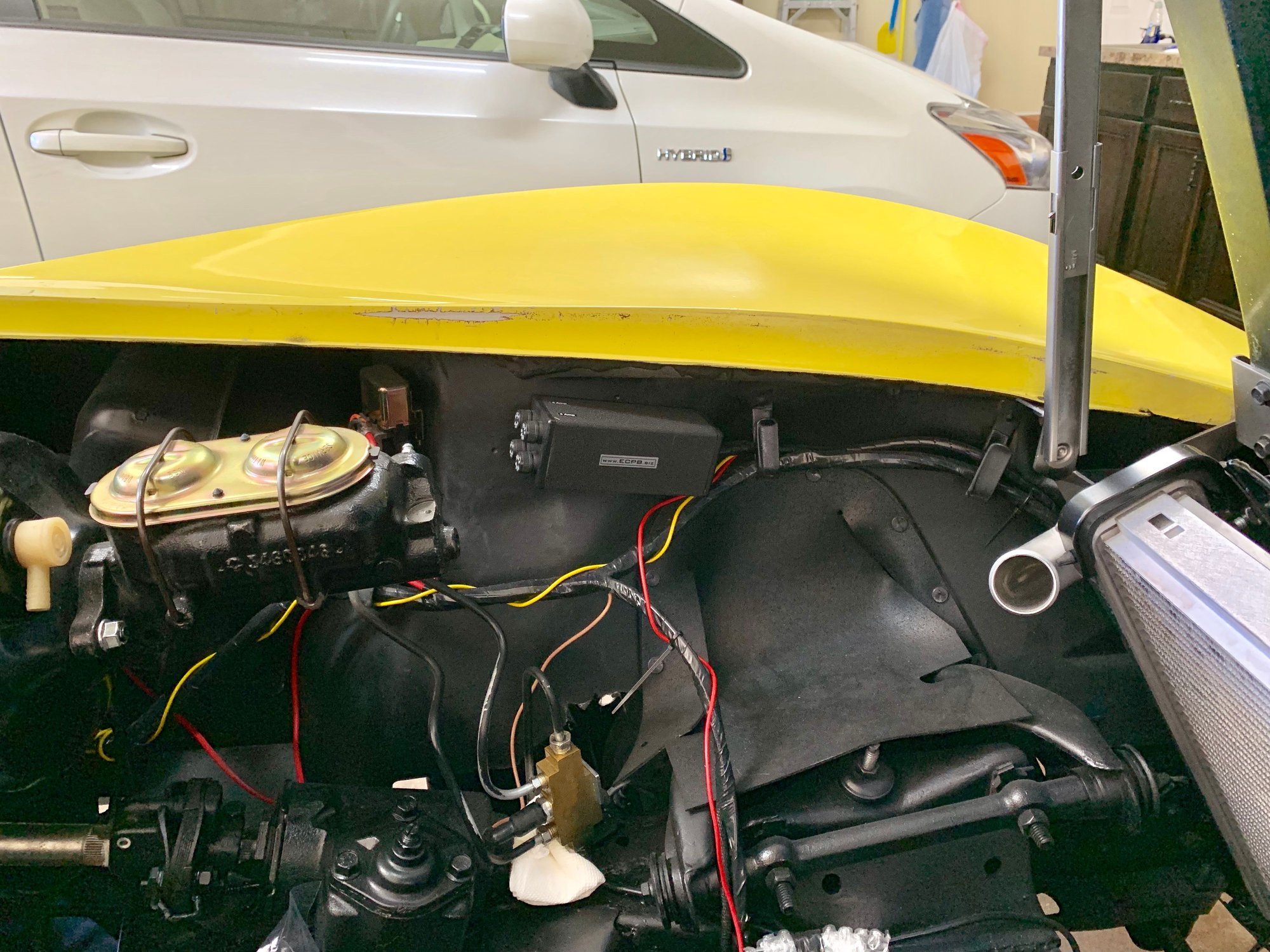

It took an evening.
Probably longer including the time studying everything.
I took the actuators off and you need to take the springs and connectors off and all the vacuum hoses.
I put bolts in the holes and will have a piece of metal cut to cover the large hole. Will paint and bolt it on.
These pics are from when I first installed. The engine was out and everything stripped including interior wiring so was much easier. Safe to figure on taking the weekend.
