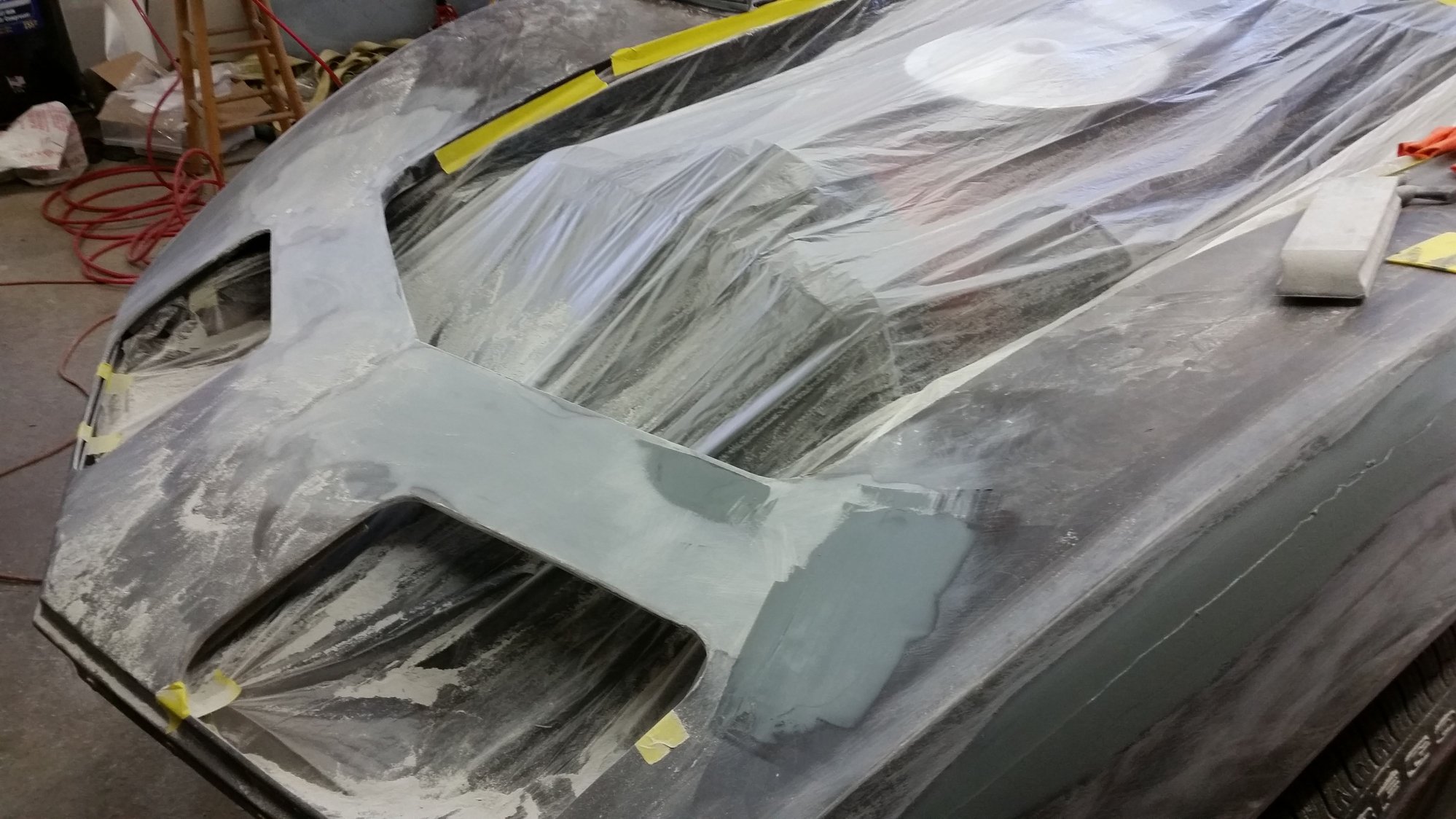

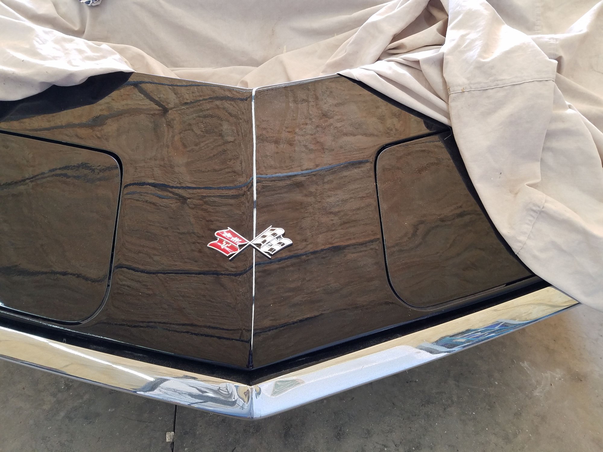

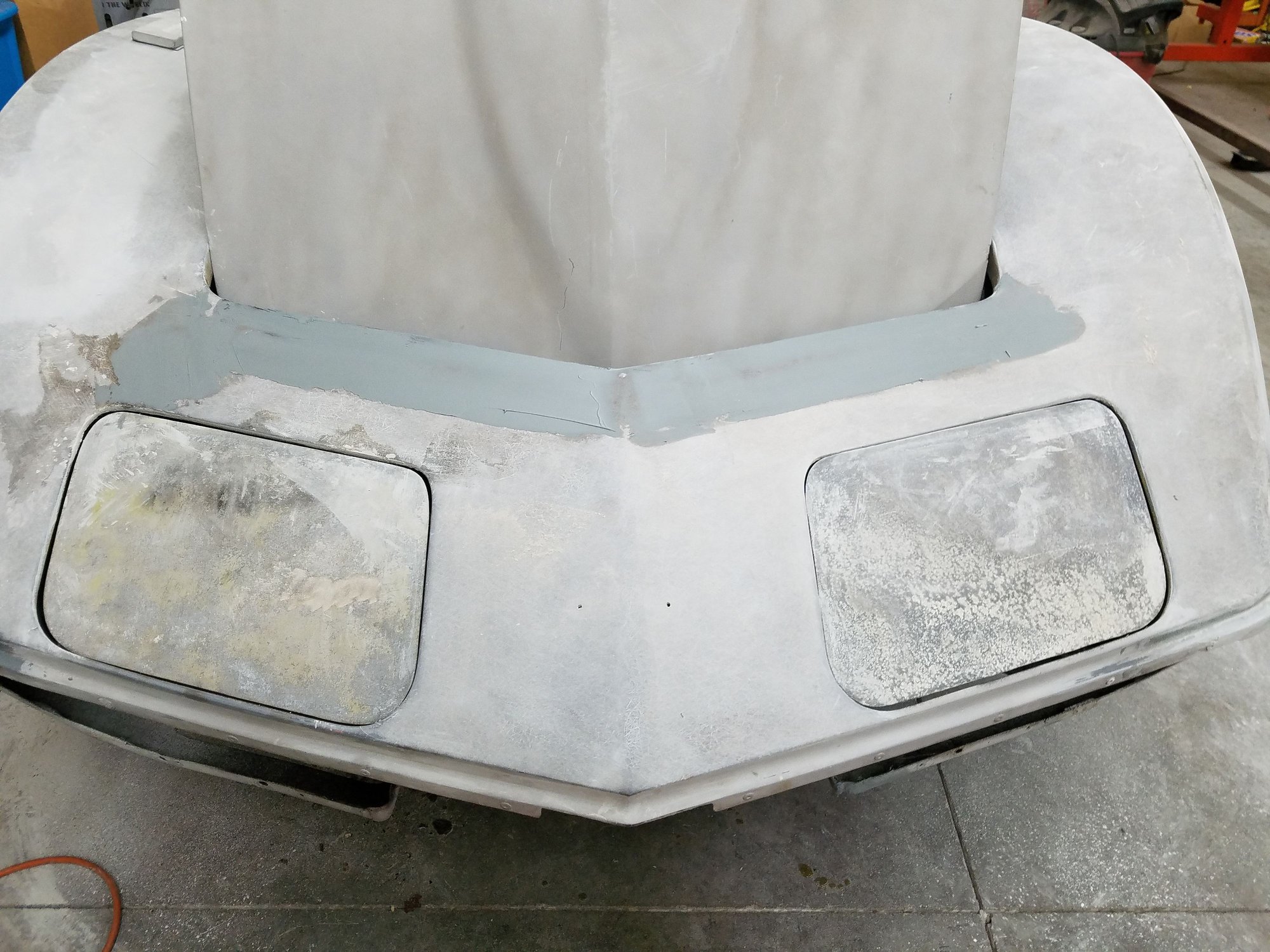

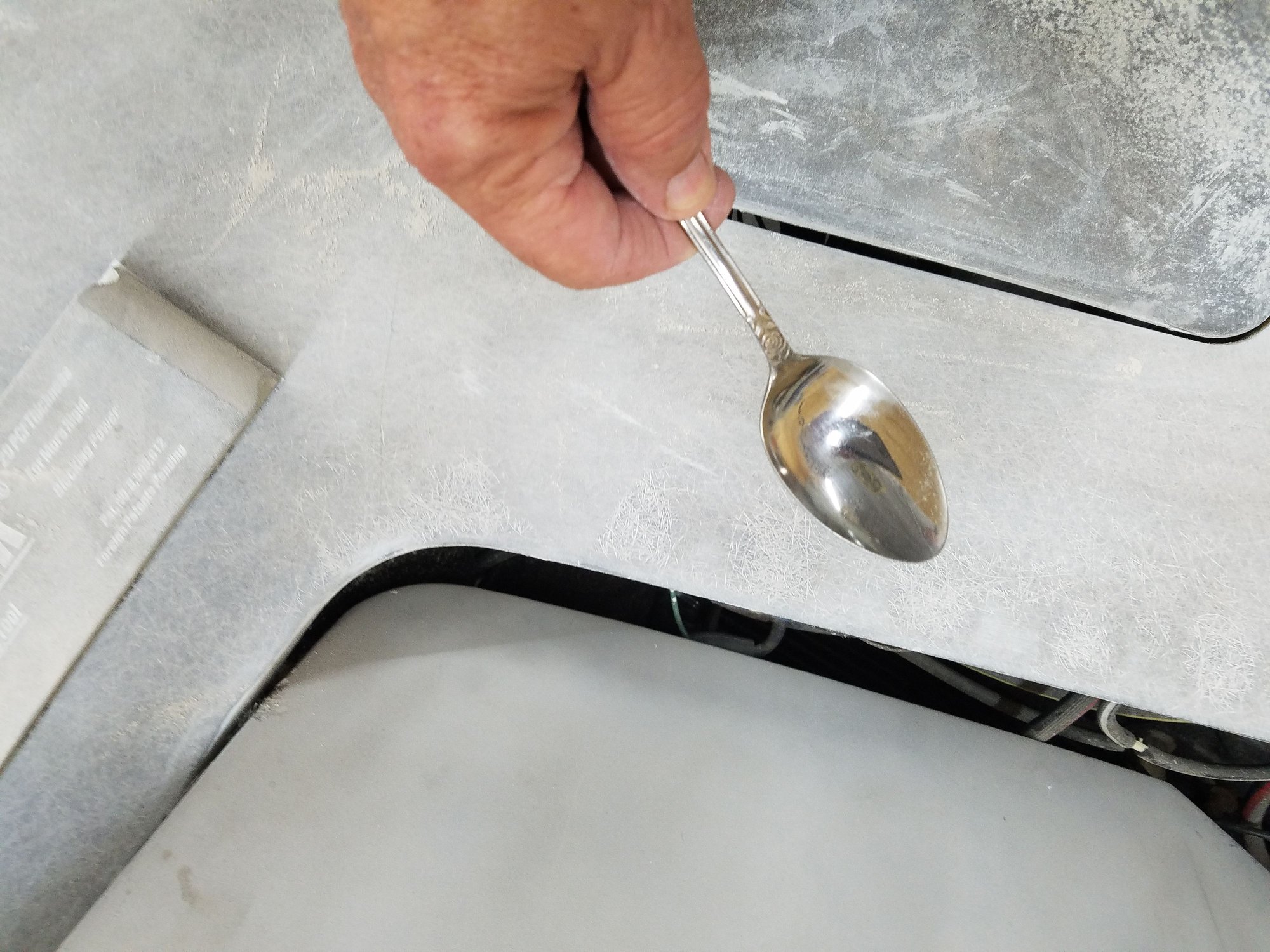

There are a few options that folks will give but what works for me is using my heat gun and heating those bump areas a little and taking a teaspoon and pressing down to create a dimple. This allows me to then come back with VPA and fill those areas. Some will sand the bumps down thinning the fiberglass in those areas which I would not suggest. The dimple method still allows the fiberglass to maintain at least a better thickness. Works great for me as this option was given to me by Dub who I consider to be well versed it many of these type repairs. Your car do as you may, just an alternative.
RVZIO
69 project that I used VPA after inking down the bumps.
Spoon is upside down but shows the right size dimple.
71 project where bumps were not real bad but used the process anyway.
71 finished product
69 finished product
