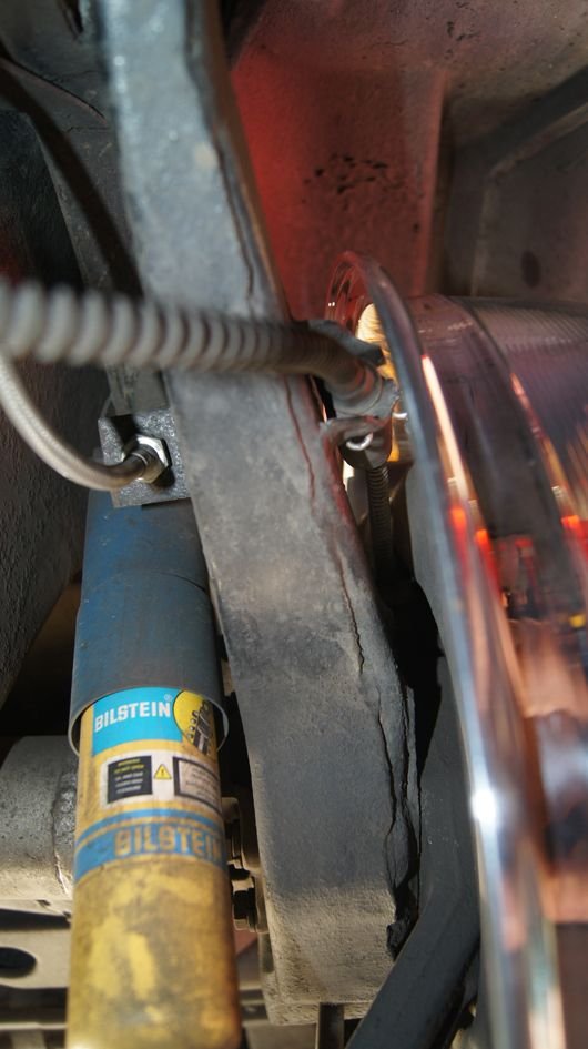

Ok that’s really reassuring, just a quick question, when you relocate the parking brake bracket, do you route the cable on the inside (towards brake line) or outside of the trailing arm?
Thanks!
On the inside.
