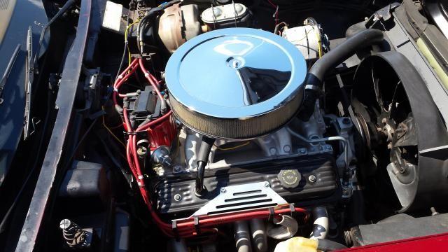

I have an Edelbrock RPM airgap manifold with a 1/2 thick adapter and a Qjet with a drop base air cleaner with 3 inch element under my stock 77 hood. I need the adapter because of the Vortec head manifold only comes in square bore. It is very close to the hood and I use a nut on the air cleaner stud, not a wing nut. I also have the back of the hood shimmed up about 1/4 inch. But it all works together very well.
I am familiar with your set up BK and that you do 1/4 mile stuff too. Glad it works for you in that use. In a 1/4 mile I suppose the air doesn't heat up too much, but with successive runs I would think it would. In street driving scenarios it will heat up a lot, especially when using the A/C, and that leads to rich mixture, poor running and idling.
I don't want to be pulling underhood air. So the manifold height becomes an issue in that regard. At least if I want to retain the stock hood and/or stock air cleaner configuration on my '77. Currently My air cleaner is right against the hood with stock arrangement with the 2101 and carb gaskets.
Not to belabor this issue, and I don't doubt that your car performs well, but here are a few things to think about:
C3s had open element air cleaners from the factory for years, even with AC. Maybe their HP was compromised, but there were no poor running and idling issues.
My car is a street car first and it operates properly in all situations. Actually when I am racing and I manage to win a few rounds, runs become almost back-to-back. So I am racing it with high underhood temps, and it runs consistent ETs.
Early on when I had my car to the track, I tried back-to-back runs with the open element air cleaner and with the stock, single snorkel air cleaner with factory ducting in place. (This was with a Performer manifold and no adapter so it cleared the hood.) Believe it or not, the car ran 4 tenths slower with the factory air cleaner. I'm sure this was due to restriction of the single snorkel more than cancelling the benefit of cooler air. If your air cleaner is the single snorkel type, you might think about that.
I'm certain that your car would run slower with the stock single snorkel. That snorkel is not big enough and cannot supply enough air to feed a modified engine. I have mine modified to supply enough air to not choke the engine PLUS it's cold air.
I know you understand the science behind cold air vs hot air and it's impact on performance. All 1/4 mile racers do.
If you were able to rig something up that fed it cold air as well as sufficient air, then the consistency of it's running characteristics would improve and it would see a bump in performance as well.

I find aftermarket "cold air" kits questionable at best most of the time. Some of them work, but are unsightly or require mods I don't want to make. And some are NOT cold air, just relocated under hood air intakes. The price is always much more than the components used can justify IMO.
I just have a couple of hoses running out of the stock air cleaner back through the firewall where it can collect the cold air in the wiper tray area. Almost nobody who has seen under my hood, and even some who own C3's, even notices that it is a mod. So it's not unsightly and it provides just enough air that the total vacuum inside the airbox does not exceed 1.5" of water column at 6200 RPM.
Any bigger engine, or better flowing heads, or higher RPMS and I would probably need more air. Currently though I can still retain the stock setup with my modifications.
