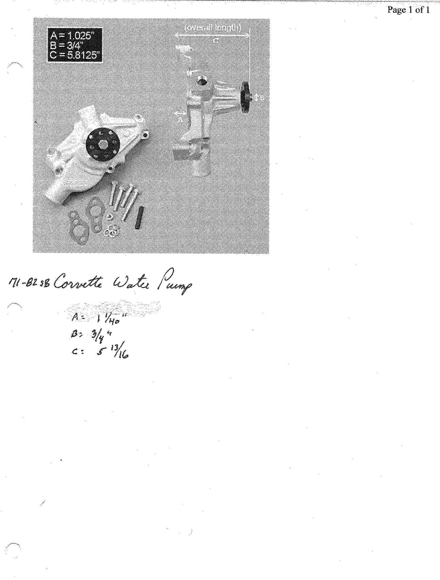

Standard short is about 5.625" and was on vettes thru 1970. Beginning 1971 vette sbc pumps are a bit longer.
Yours should be about 5.795" or 5.8" with a 3/4" OD pilot. Ask for pump for 350ci 71 thru 82 corvette only.
If you use a standard the pulleys won't align properly.
also, both standard & vette can be had with 5/8" pilot ... your 81 pilot should be 3/4"

Seems correct ... E Victor 8812 is very good but overpriced ... $268 Summit.
Stewart stage 2 pn 23103 is correct and is among best there is ... $155 Summit.
