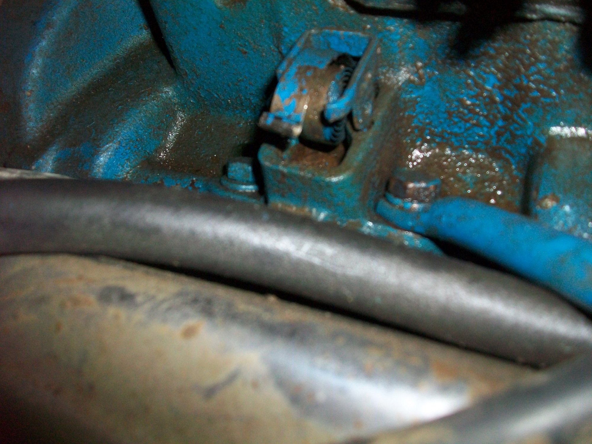

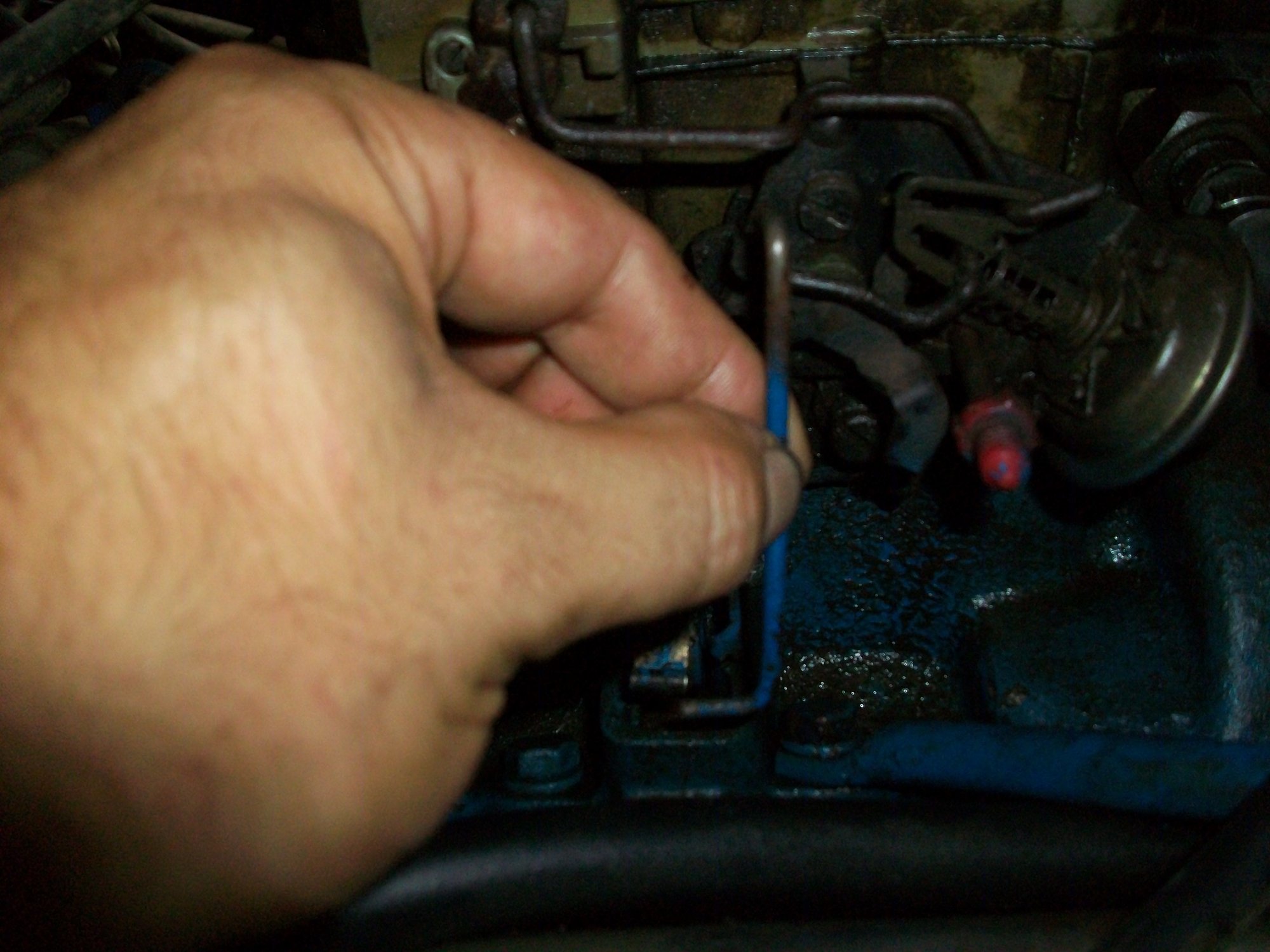

Originally Posted by planet-automobile
Ok
you think 1/2 is enough to push the pump ?
According to what I have read, total travel of the pump rod is about 0.394" (10 mm).

Are you kidding me? What's that a little over 3/8? Actually that could be GREAT NEWS for the O.P.

just did a rough check on an old SBC cam. less than 1/2".

So now, you are back to square one. Why no fuel at carb?
Its not the pushrod.
Its not the fuel supply line.
Its not the pushrod cam lobe.
Not sure on the pump.
Getting back to what Peterbuilt said earlier, do you have the preformed "S" hose installed at the pump inlet? When you tested the pump by hand pressure, that important "S" hose was not likely involved. But when you attached the pump to the block it is imperative that special hose is in place. Otherwise the fuel is pinched off.

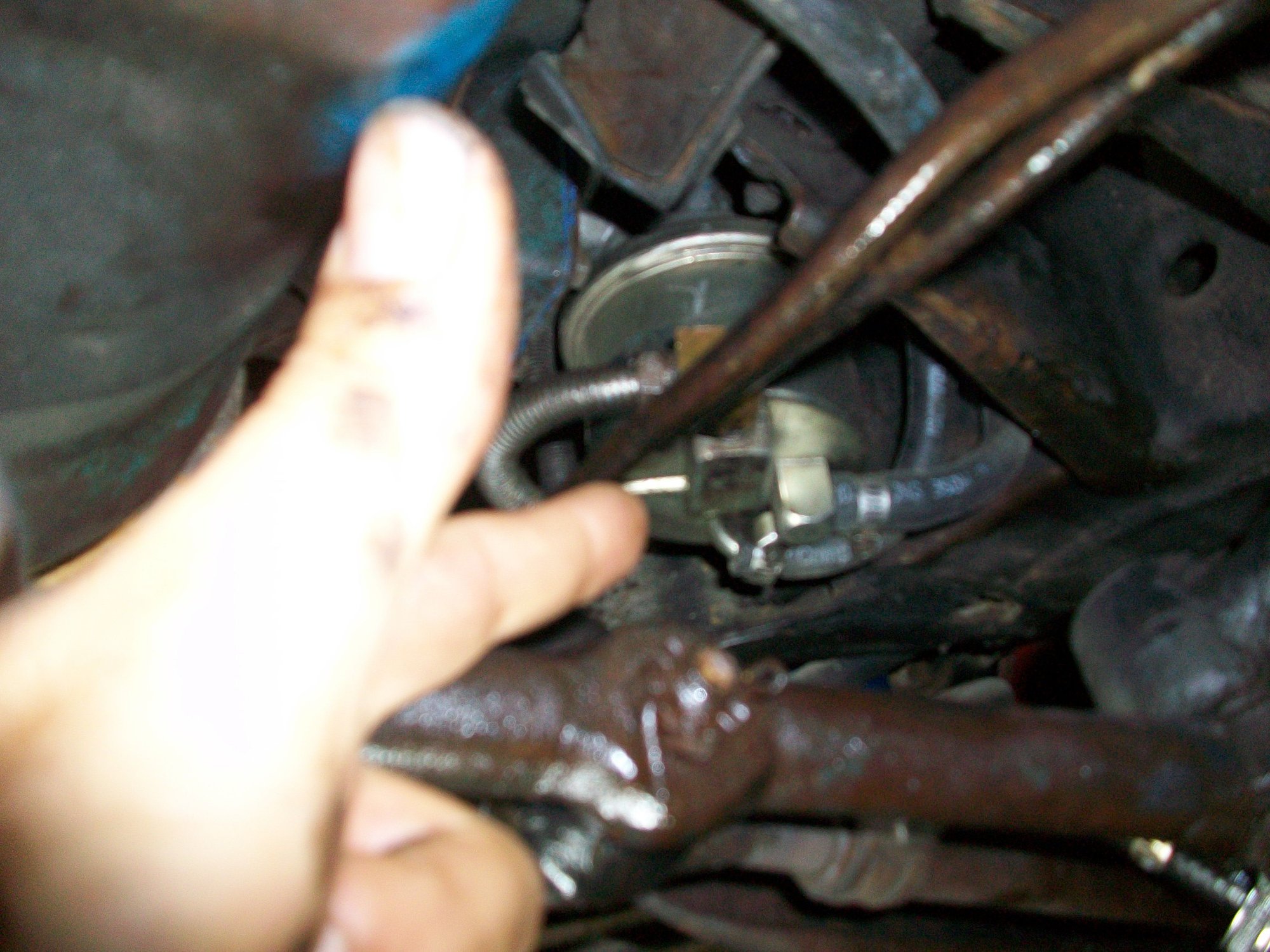

Some related comments:
We don't know why planet decided he needed to replace the fuel pump.
(OK, car doesn't start - this is new behavior? You didn't just get the car or something like that?)
We don't know if the supply side line is actually supplying gas
We don't know what 'no fuel to the carb' means (two filters are in the path). Are we looking for the accelerator pump to squirt?
Recommend planet that you supply the outlet side of the pump before the filters through a hose to a bucket and see if it pumps. There is actually a specification for how many gallons per some unit of time. I believe that is in the shop manual. BE CAREFUL!

At idle, the pump needs a ridiculous little bit of travel - my car was still running until the cam lobe went almost completely round, so 1/2" is plenty for normal driving

When you disconnected the fuel line to the fuel pump, did you get a good flow coming from the fuel tank?
OK, so you assumed it was a defective fuel pump....I would have too. Here is a similar situation where a guy replaced a fuel pump and his engine still wouldn't start. Turned out to be a defective sending unit....it must have been plugged up or dirty sock filter.

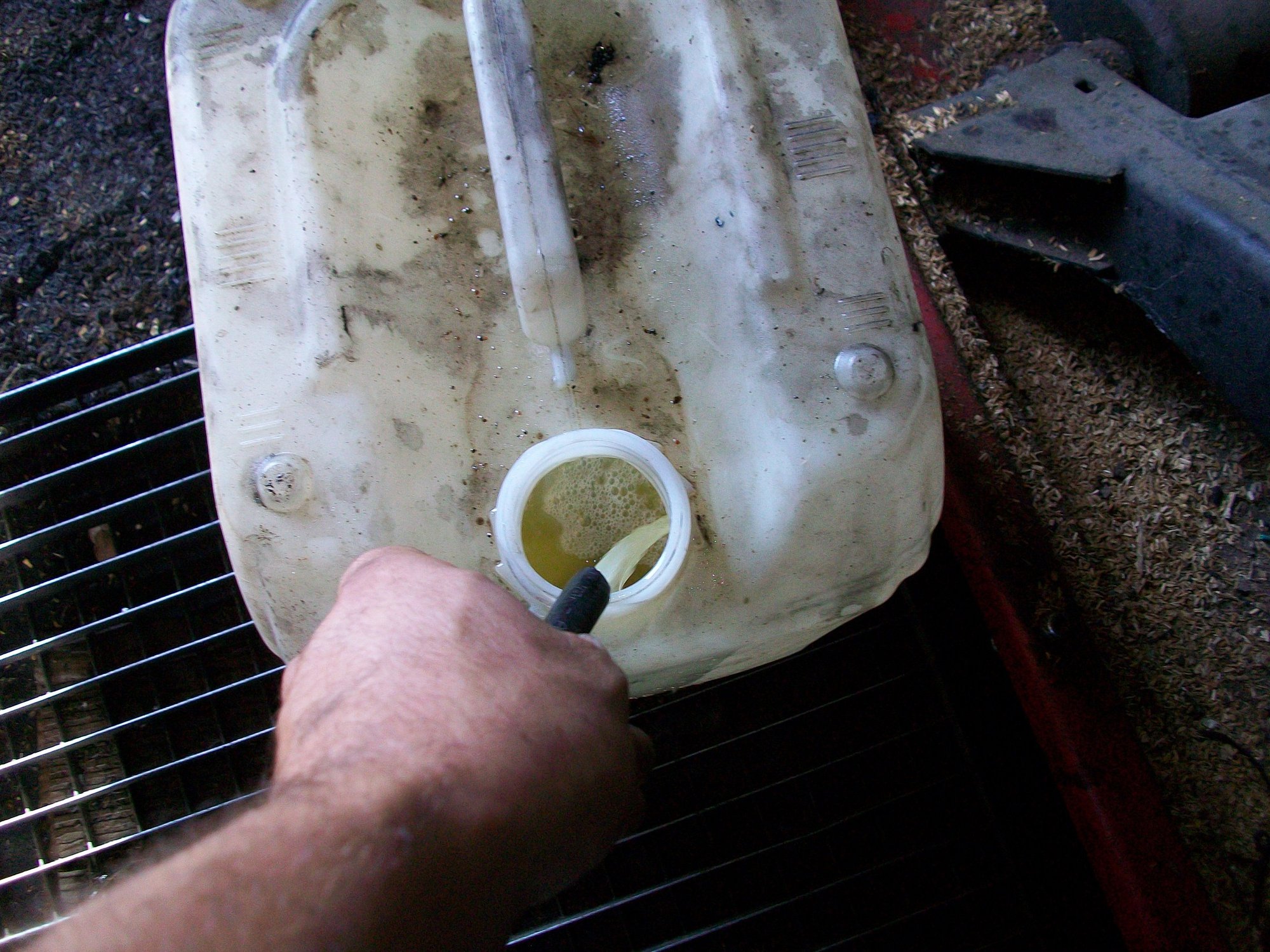

Monday I clean the tank.

The pump will not draw gas up to the pump easily with just cranking the motor if the fuel can is lower than the pump, you should hold the gas can you were using higher than the pump so that the pump is using less effort to pull the gas, if you are just checking flow you are going to have to turn the motor over for a while to get the fuel to be drawn through the pump and out. If you are trying to get it to the carb, then you need to prime the carb with a tiny amount of fuel to get it to fire which will get it spinning fast enough to draw fuel up to ithe carb.
If you are thinnking the sock is plugged, disconnect the fuel line at the pump, gas will pour out very quickly, if its just seeping put , then you have a clog in the pickup tube or sock

I cleaned the tank.
it's okay. the car starts
but she stops quickly ( 5 seconds)

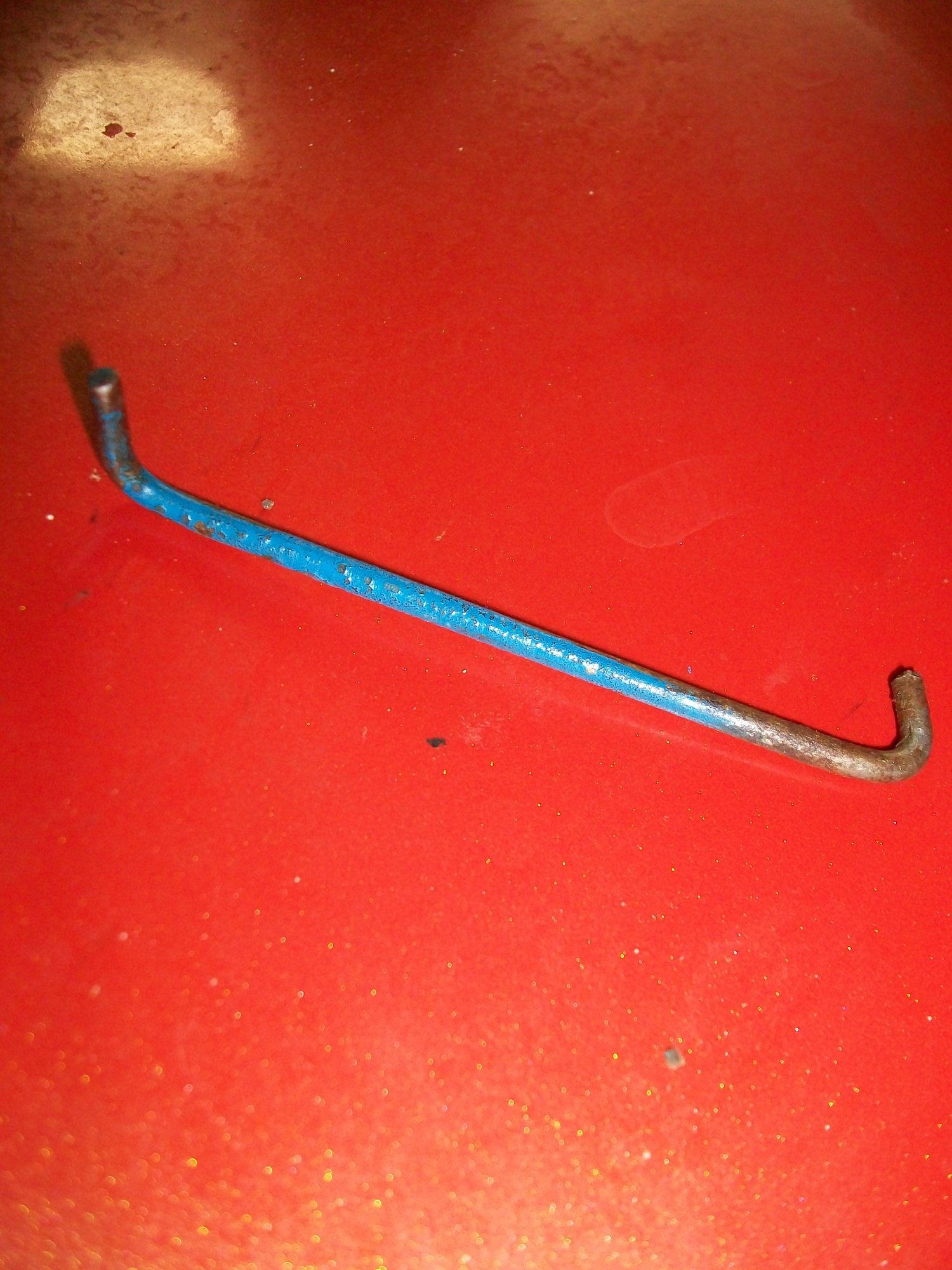

I think the problem is this rod

That's for the choke it appears.that won't stop fuel flow. Itll just run rich

Yes ,does not stop the flow .but when the choke is open the car stops after 5 seconds
