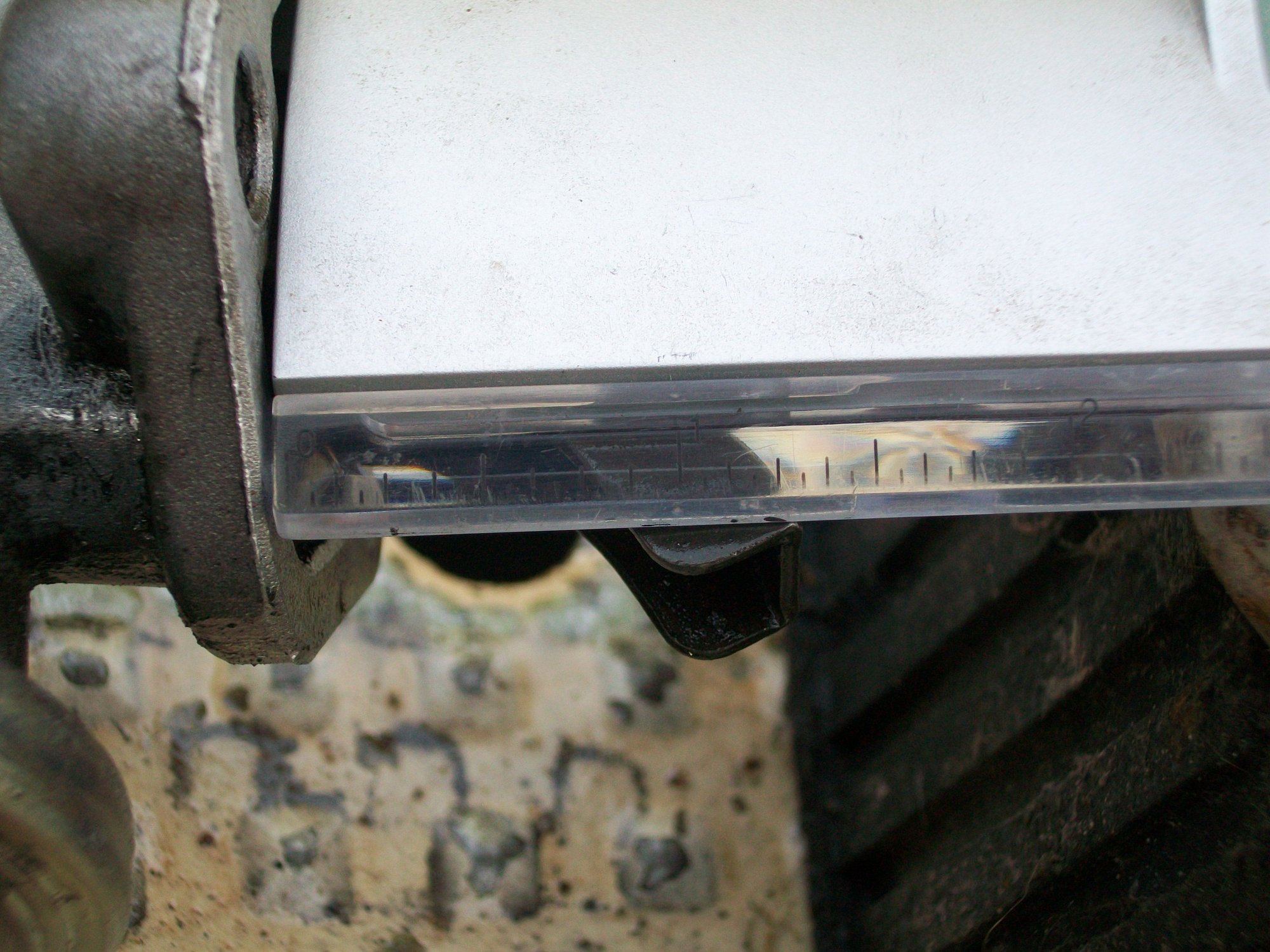

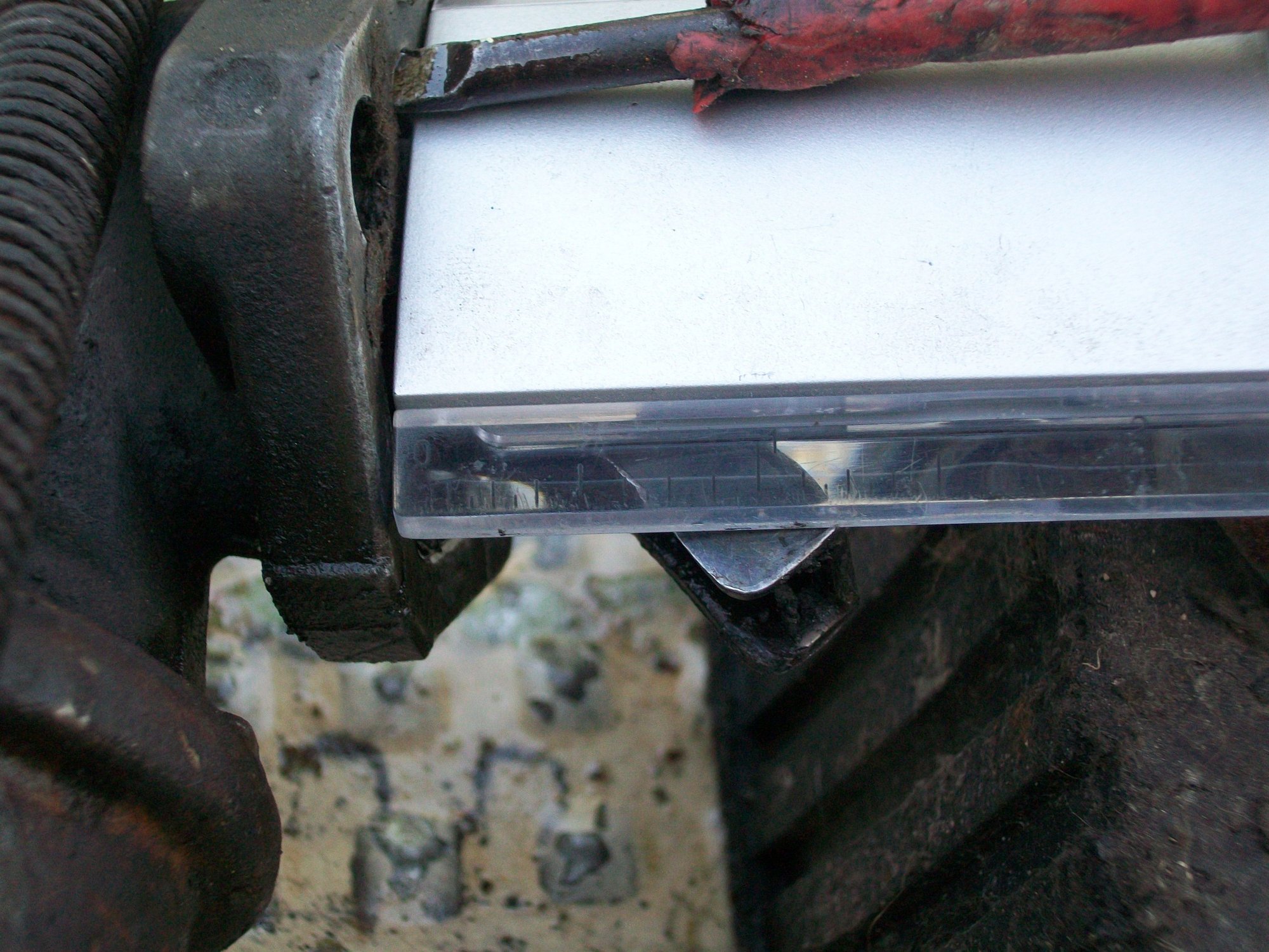

H-m-m-m-m-. I think I would put both pumps side-by-side on a work bench. Compare not only the arms length but the angle of the arm. Do both arms return to the exact neutral position? Do both arms push down to the same position? They appear to be twins, but if one of the pumps arm is a little shorter, then . . . . . . . .

I measured
pump 1
pump 2
