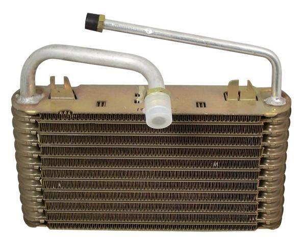

When I installed the Old Air VIR eliminator it was larger then the VIR so it did not fit the stock bracket. I made a plate and attached to the bracket and used a large hose clamp to hold it in place. Without it the weight of the can could cause the Evap to crack in a few years. (ask me how I know)
I then replaced the evap and accumulator with a 78-82 unit.

I used a nostalgic air kit had a really tough time getting the hard lines hooked up took a lot of bending to get it right. If I had to do it over I would replace the evaporator and dryer with one from a 78-82.
