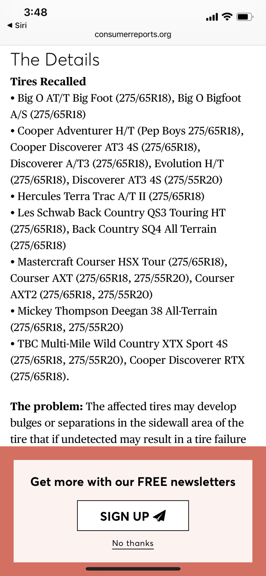

Looks like Cooper did have a recall on sidewall separation, here’s a list of the effected tires and it doesn’t look like the 255’s are on the list
