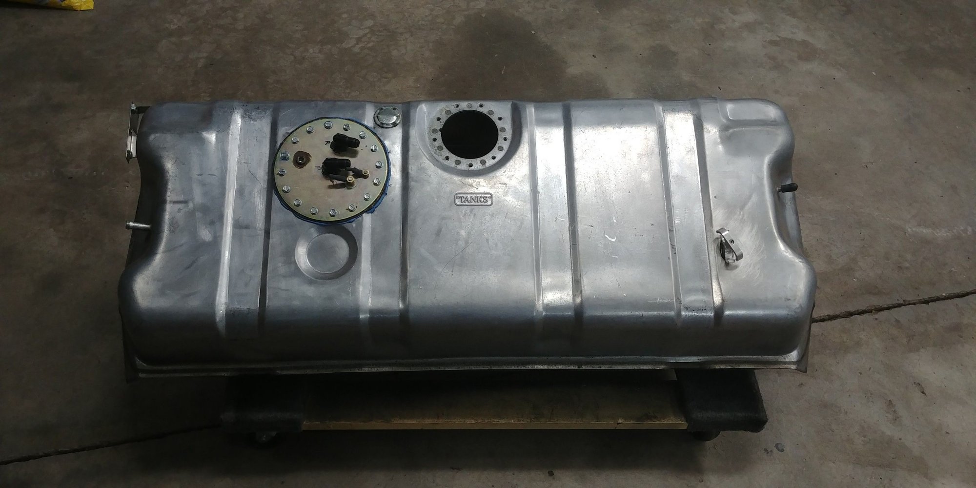

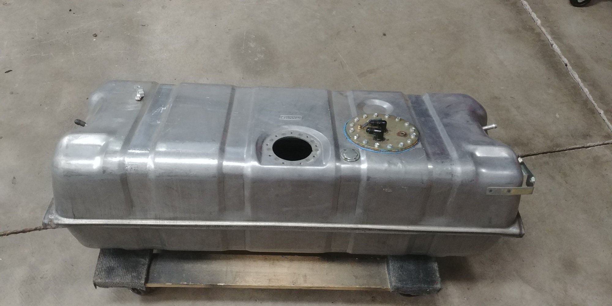

Yes I have used their tanks on a few cars I have done. They work very well. I do also have an original new tank that has been converted to FI with a Walbro 255L pump. It still has the original sending unit in it for the fuel gauge. It is for sale at a much reduced price.

Gordon, Is there any baffling in that converted tank? I currently have a stock tank with an external pump and am not overly happy with it due to fuel slosh.

The pump actually sits in a small bucket of fuel with a hole or two drilled in it to slow fuel to come in. The tank itself has no baffles.

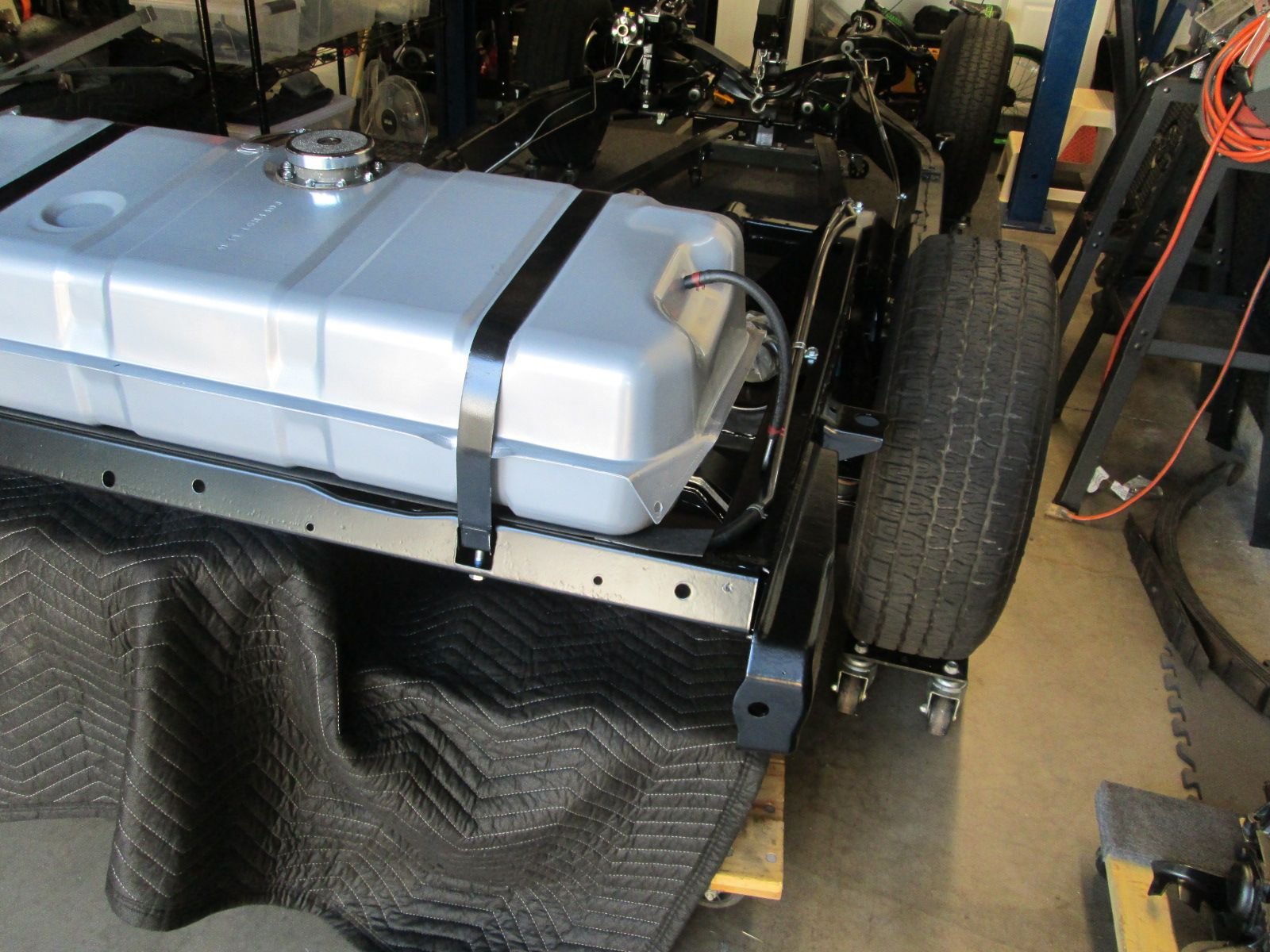

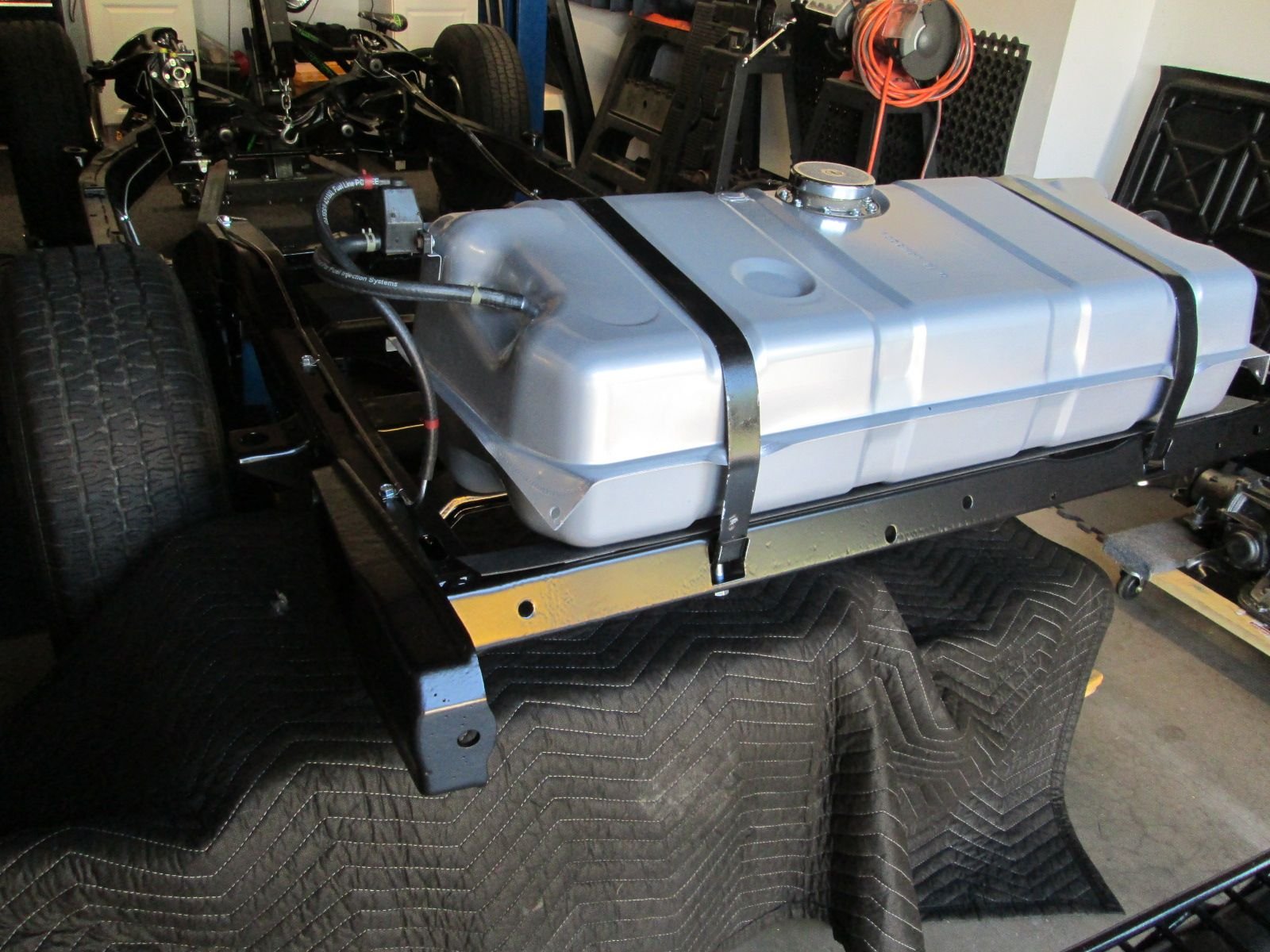

I love the Tanks fit and function. I used the same combination shown by Gordon on my 72 road race replica and it worked so well I bought a new stock style tank for my 1974 restoration.
I was going to use Gordon's Tanks/Walbro setup for my build but decided to stay with a carburetor setup and not go EFI so his tank is here now and he will be selling it soon. Great setup. Good luck with your decision.
