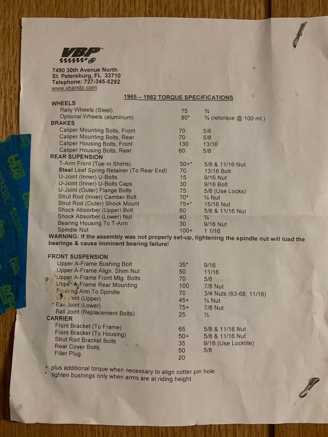

I found the torque value for the crossmember to carrier (diff) in my GM Shop Manual (60 ft.lbs.).
I can't find the crossmember to sombrero torque value. Is it in the AIM? If so, I don't have one of those.
Does any one know the torque value for the 2 sombrero bolts?

According to the AIM 55-65 ft pounds. This can be found on UPS 2 sheet A1.

This paper came with some new calipers about 15 years ago. I tapped to the inside of a cabinet door in the garage. I reference it all the time. Hope this helps.
