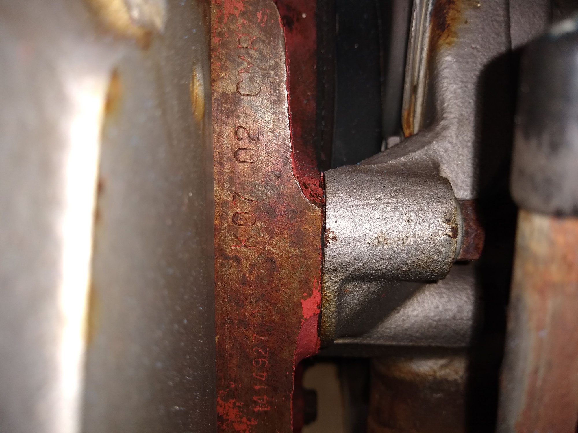

Then the CMP is either a restamp or an oddball that hasn't made it into the archives. Post a pic of the stamping. Also of the 010 casting number.

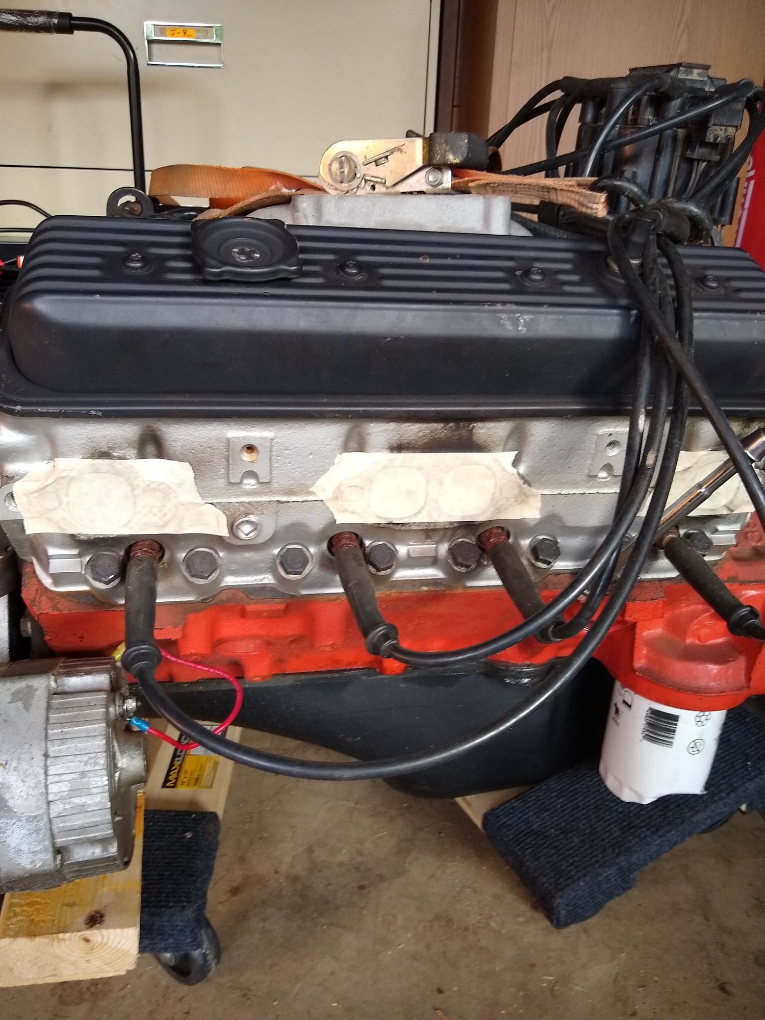

Here are a few pictures of the engine

CMR. not P. 74 lopo 350 from impala or 78 L82 from vette or Z28. Or 80 305, but not with 010 block. Pull valve covers and get head casting numbers and dates.

Thank you, that makes much more sense to me than from a 91 firebird based on the left side dipstick and block casting number

Bottom line is you have a "Heinz 57" engine. The pieces are from all over the place. You can ID the pieces but you will never know what they all are unless you take it apart. The same "010" block was used on everything small block Chevy in every possible configuration from Corvettes to station wagons to pickup trucks for over a decade. The numbers really don't mean much anymore.

What didn’t make sense? You got hung up on the stamp up front....
You go by the casting number of the block....regardless of what the stamp up front says....
It can’t be both....it can’t be a 4” bore block and a 305 pass dipstick....
Jerk the heads off and see what you have....for the cost of head gaskets....I would NEVER run this engine without jerking the heads and pulling the pan to inspect and reseal anyhow.....putting engines in cars is a job to find out it is trash....
Clean it...reseal it, and detail it....you will thank yourself later...

Heinz 57 ... good analogy
block has 2-piece RMS ... and NO real possibility of fitting OE roller lifters
193 TBI head is about as poor an sbc piece as can be
in the pic of 193 head ... not certain, but seems it has self-guided rockers but also the tight pushrod hole (POOR combo) ... also ...
... is that simply condensate in those rockers ? ... or was PO making a milkshake ?

010 has a 4 in bore. Longer pad many times early block there will be a casting numbers with a clock identifying when block was cast. 010 also can come with 2 bolt mains. My guess its a rebuilt 87-95 trunk engine.

Not quite.
The engine code suffix stamp begins with "C" for "Car" application. A truck engine code suffix begins with "T" for truck application.
The engine stamp casting pad shape tells me it is from the mid 70's. Block casting date could be down low on the side of the engine close to oil pan rather than top rear of block as found on earlier castings.
All the "010" blocks are 2 bolt main or 4 bolt main, but functionally the same otherwise.

But it’s not because they stopped making 010 blocks in 1980...
It is a pre 1980 350 with 350 TBI heads and that is the most the OP will know until it is opened up to check.
