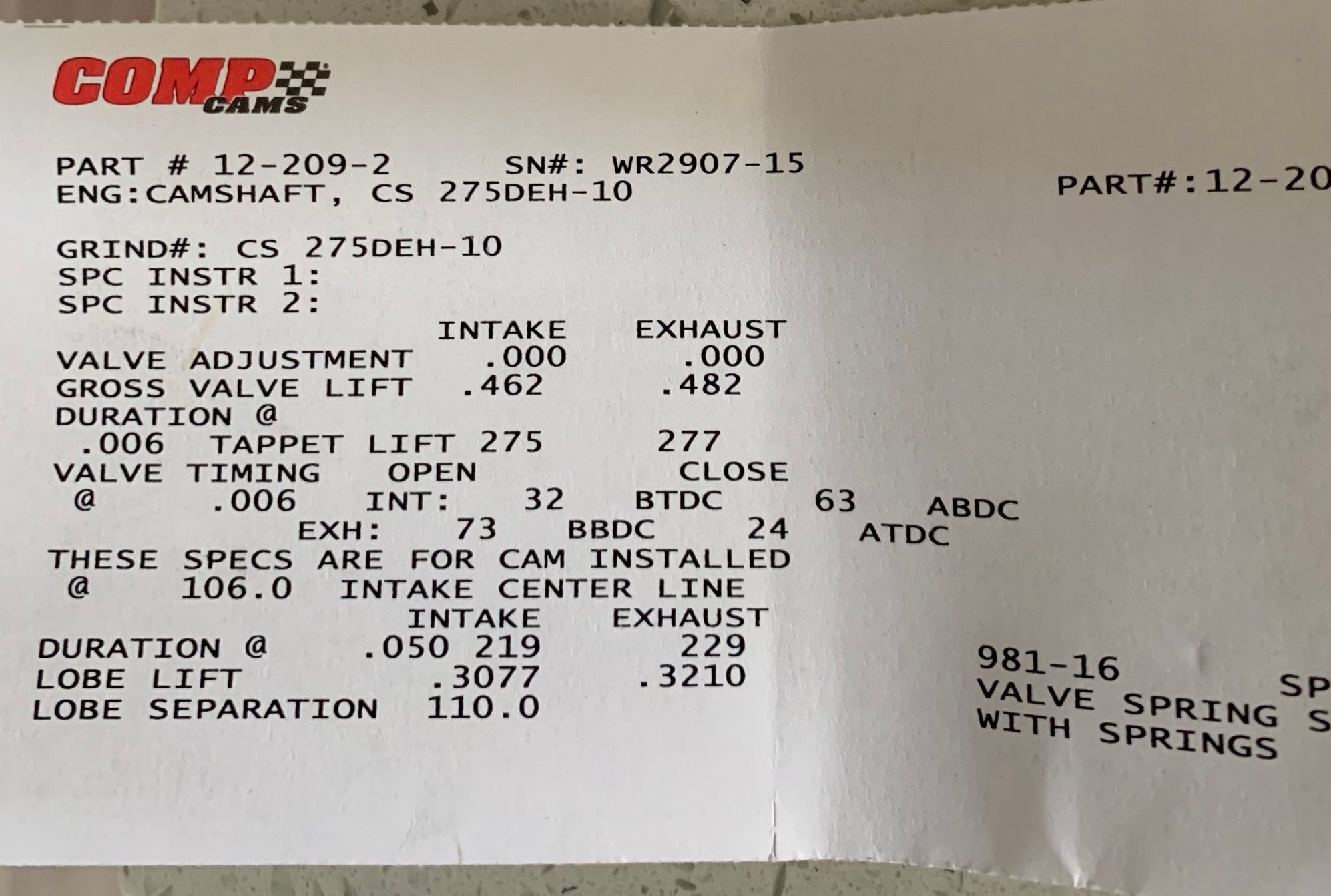

You say aggressive camshaft, do you know the specs? The intake may not solve the problem as you really want to match all your engine parts.

This is the spec sheet for the cam.

You have a bunch of things against you in the engine. Your cam is actually very mild. 219/229 is actually less intake duration than the L82 cam of 222/222. You have similar lift, but Comp cams ground yours with 110 lc and opened the intakes earlier. It causes intake reversion and a lumpier idle making people think that it is something.
Double hump heads even with lots of work done just don't have the flow or correct chambers. Side pipes are not a tuned system. The torque manifold is not a tuned runner intake. But out of the manifold choices 8501 is the best
Changing manifolds might not even make a seat of the pants difference.
Money would be better spent on a bigger duration h roller cam
